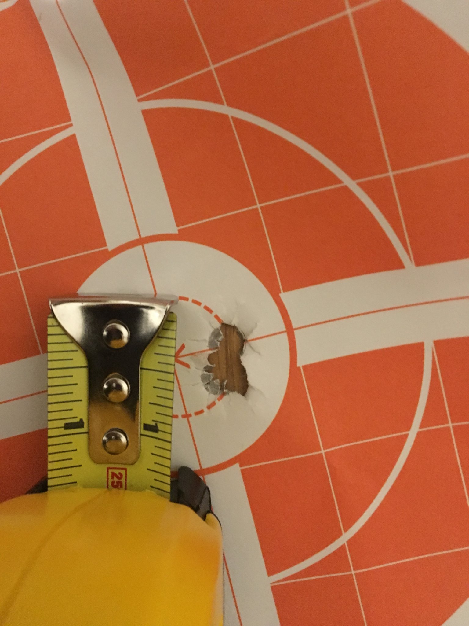

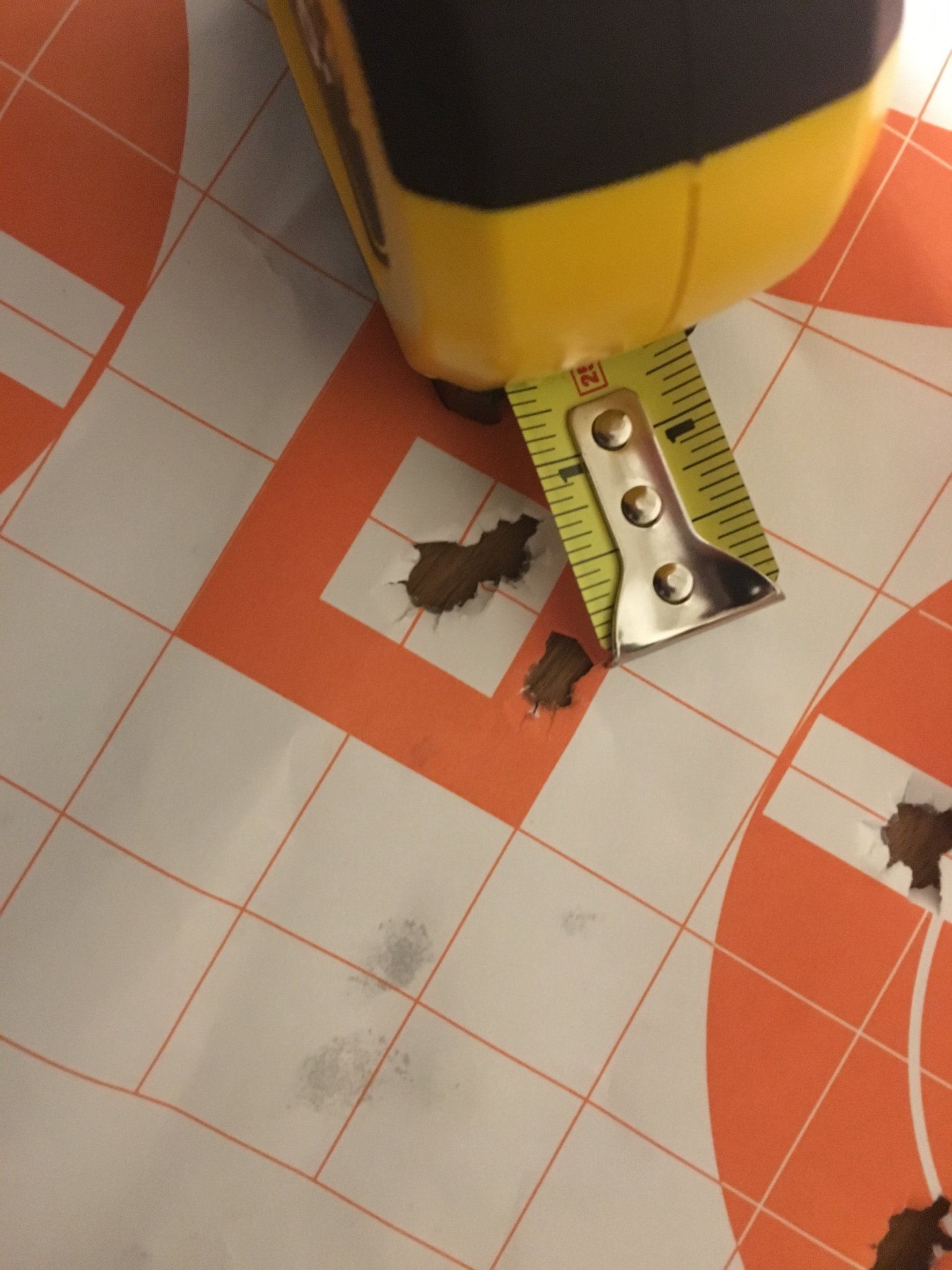

Okay folks! I finally took the rifle out to the range today.. Bear in mind, this is the first time I have shot any rifle at 100 yards, the first time I have shot a .308 and also the first time that I've used a magnified optic.
I'm still figuring out the whole zeroing process, but I have to say, I'm very impressed. My barrel is a take off from a Savage 20" .308. My scope rings cost me only $15.
