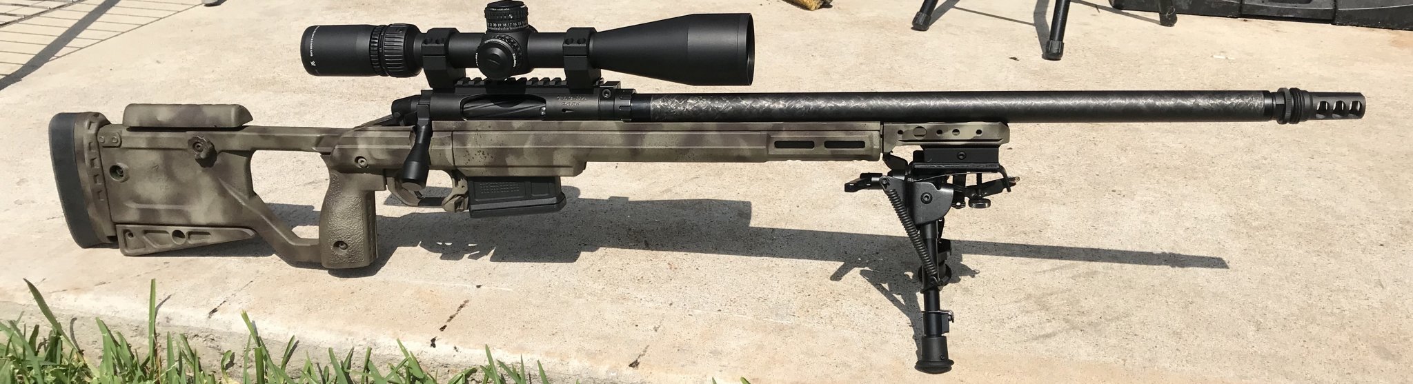

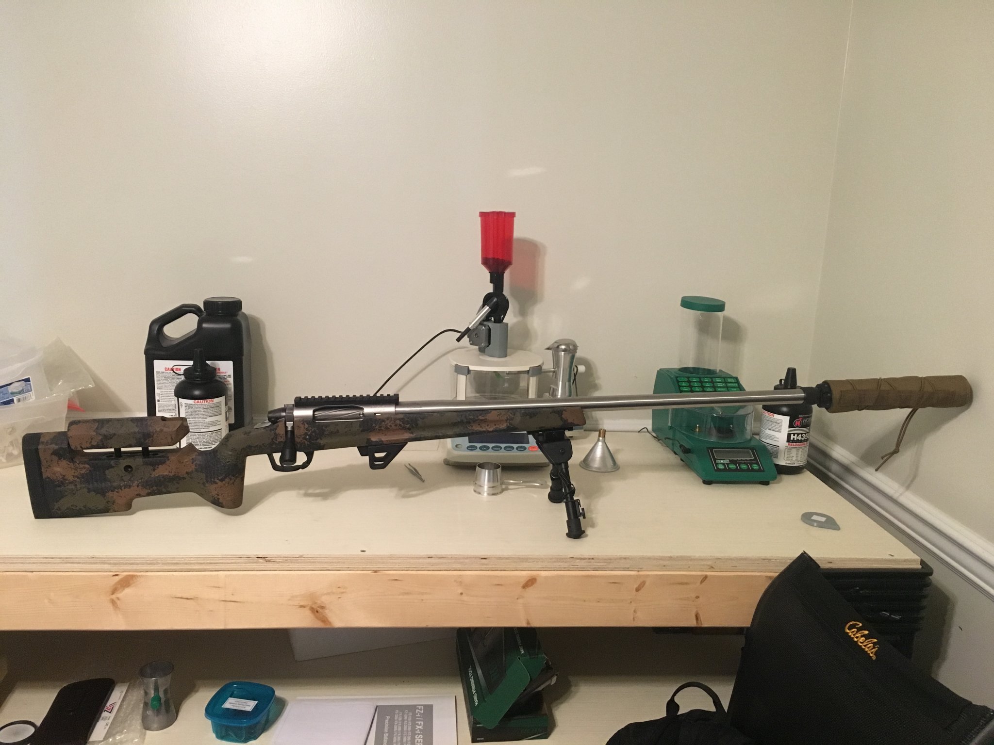

Nearly finished, just got the receiver back from Bighorn today, looks as good as dad's and my Tempest did from Chad at CCG. Feels much better. Just need to properly torque the receiver down and add the 419 rail so i can use the Atlas CAL. Speaking of which i don't have an expensive calibrated torque wrench. It's just a $50 tekton or whatever off amazon. I know i don't set it to 75ft-lbs and go. So without sounding too ignorant on the subject, could someone enlighten me?
For the love of God, send that stock back to manners and have the ejection port inlet correctly for TL3.. far too nice of a stick to keep it like that. OCD rant over.
Been nearly two years lol it doesn't bother me that much. Shit i didn't even really notice until now. It's never had a failure to eject. It's not entirely done though. I still want an adjustable cheek piece and again have to put the 419 rail up front for the Atlas CAL.
I'm still leaning towards LRI for the ULATCH so it doesn't add anymore weight though it's pricey, i'm sure if i sent it Chad would have no problem inletting the ejection port. Having said that i'm waiting on my PRS2 for my Tempest so that's my only rifle up at the moment.

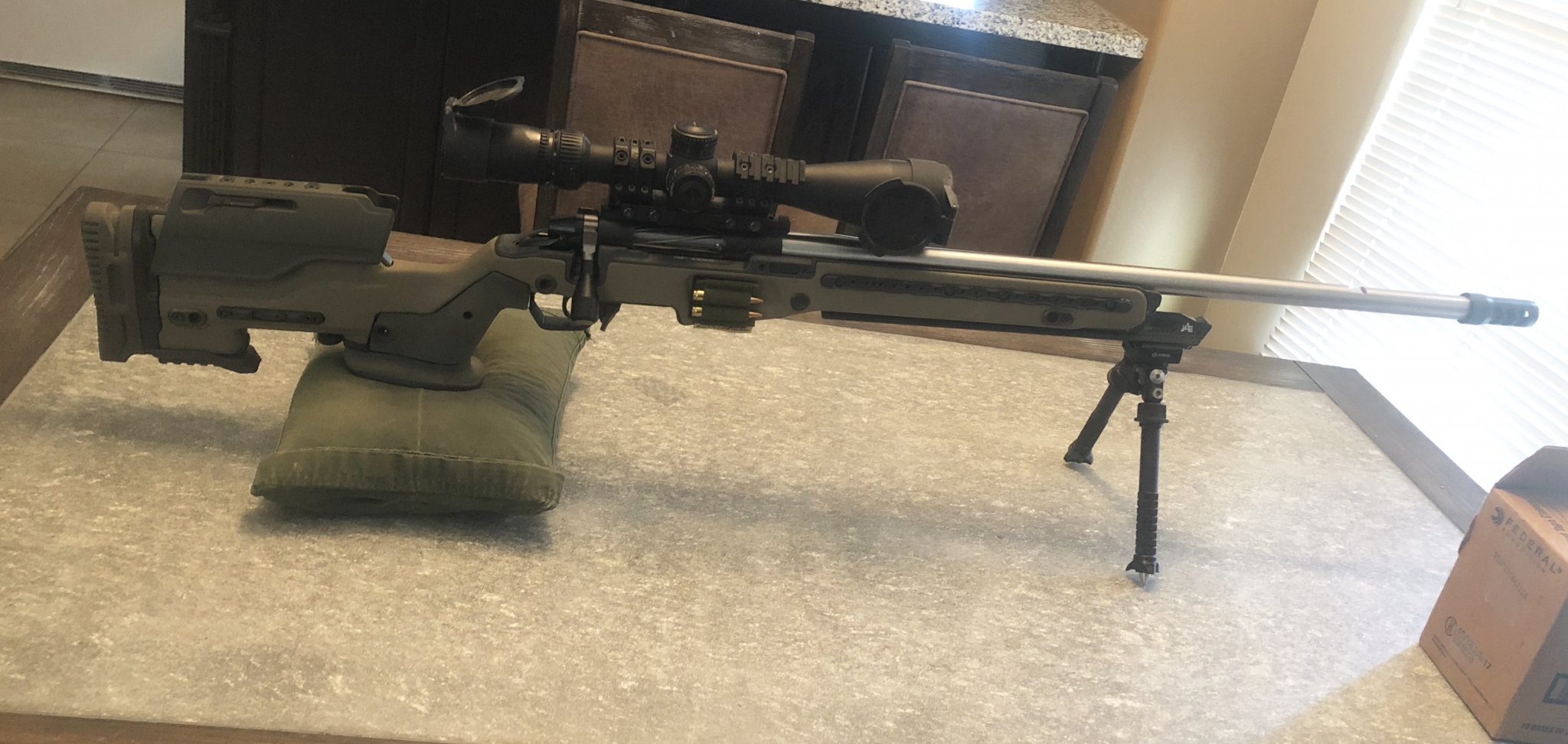

Mine will be done any day now .
Bighorn tl3 (dlc)
Bartlein 6.5 1-8 heavy Palma
Manners elite tactical t6-a ( elite swamp)
Trigger tech diamond
Badger m5 enhanced dbm
S&B 3-27x56 high power PMii tremor 3
Badger rings
Accuracy 1st bubble level
Feb 22, 2017
134
191
43
Same with mine, in the next week or two, if Aarons timetable don't go down the tube again. tl3, sr3 both in eh6a's mini chassis'.. M-10 rings and LRHSi's, TT diamonds. Both with Proof sendero light cf.
