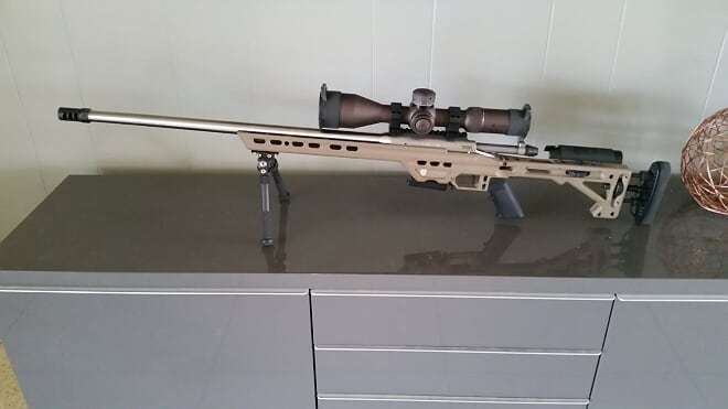

Want to start and/or consolidate a thread for the TL3 now that it's out and people are using them. Let's see your builds!
Mine:
PVA TL3 (tactical knob, AICS cut, hybrid tang, 30-moa rail)
6-Dasher / .223 Wylde
Mad Scientist brake
MPA BA Comp chassis
Athlon Cronus MPA 1-pc mount
Harris bipod

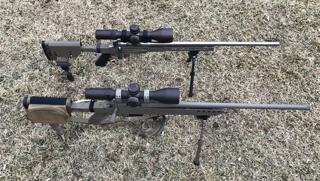

Fire forming the Dasher brass today so had to really slam them home to seat. Still worked wonderfully and grouped better then I could have hoped for . It will be nice to start using real loads now.

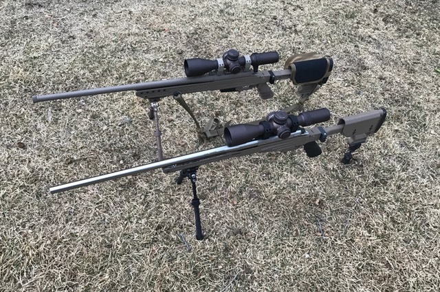

Just shamelessly piling on here, I already posted pics of mine in another thread. Anyway, the rifle is a Bighorn TL3 action with the 30 MOA rail and a medium tang, a Bartlein barrel chambered in 260 REM, sitting in a KRG X-Ray chassis with a Timney Calvin Elite trigger, topped with a Vortex Razor 4.5-27x56 and tipped with Thunder Beast's Ultra 7. So far she seems to be liking the ELD-Ms, now if I could just find those available somewhere.

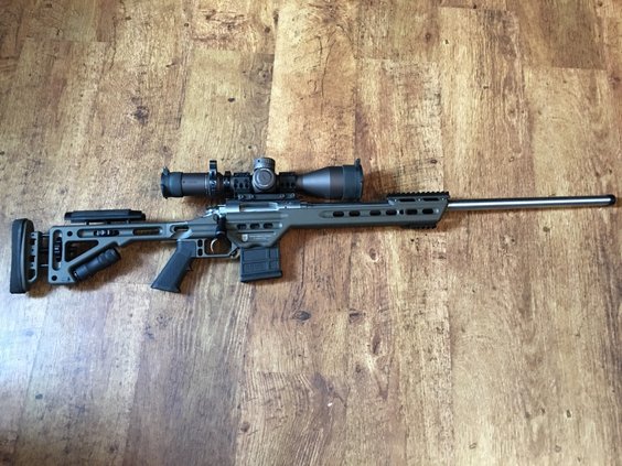

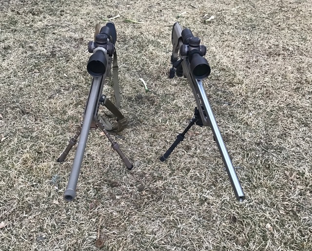

Just starting to get this one together and working on loads. Going to paint the action soon but had to get a few shots through it first after the wait. Bugholes chambered barrel, MPA chassis, TL3, Timney trigger, Magpul AICS, Vortex Razor.

Those rigs are good looking. I'm looking forward to hearing how they shoot for you all. Also what everyone chooses for the dress on them.
Anyone notice the low numbers on the receivers? That is my lowest serial number I've ever owned. :)
m1k3 what caliber did you go with?

The 2nd barrel is a 6.5 SAUM. Also a Muller Works. I'm still waiting on my Whidden die.
6.5 Creedmoor, I figured I would jump aboard. This is also my first Remington style action after running Savages for the last 15 years. Kinda cheated a bit with the floating bolt head and Savage nut. :)

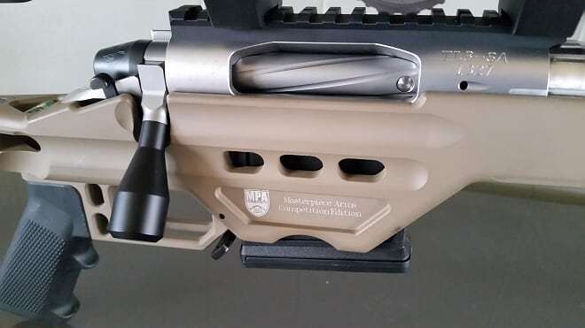

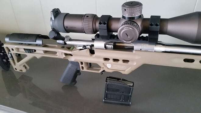

On a side note, those with the MPA chassis, were you expecting to get the barricade stop with the chassis? According to just about every picture of the chassis it was supposed to come with it. The Lite version doesn't and rightfully doesn't picture it. The competition model doesn't come with the monopod and its pictured without one. So it would be safe to assume the pictures of the stocks show what they come with and what they don't come with. I sent MPA an email and they said no, only in the competition one. I've written Brownells asking about it but no response. I leaning toward a bit of false advertising but I think I figured out how to make their stop fairly cheap and will share once I get it completed.

Sounds like yours might be the "Competition" one, do they have the magwell cutout on the side? I took my monopod off as well, probably hold on to it until I forget I have it and then try to sell.
