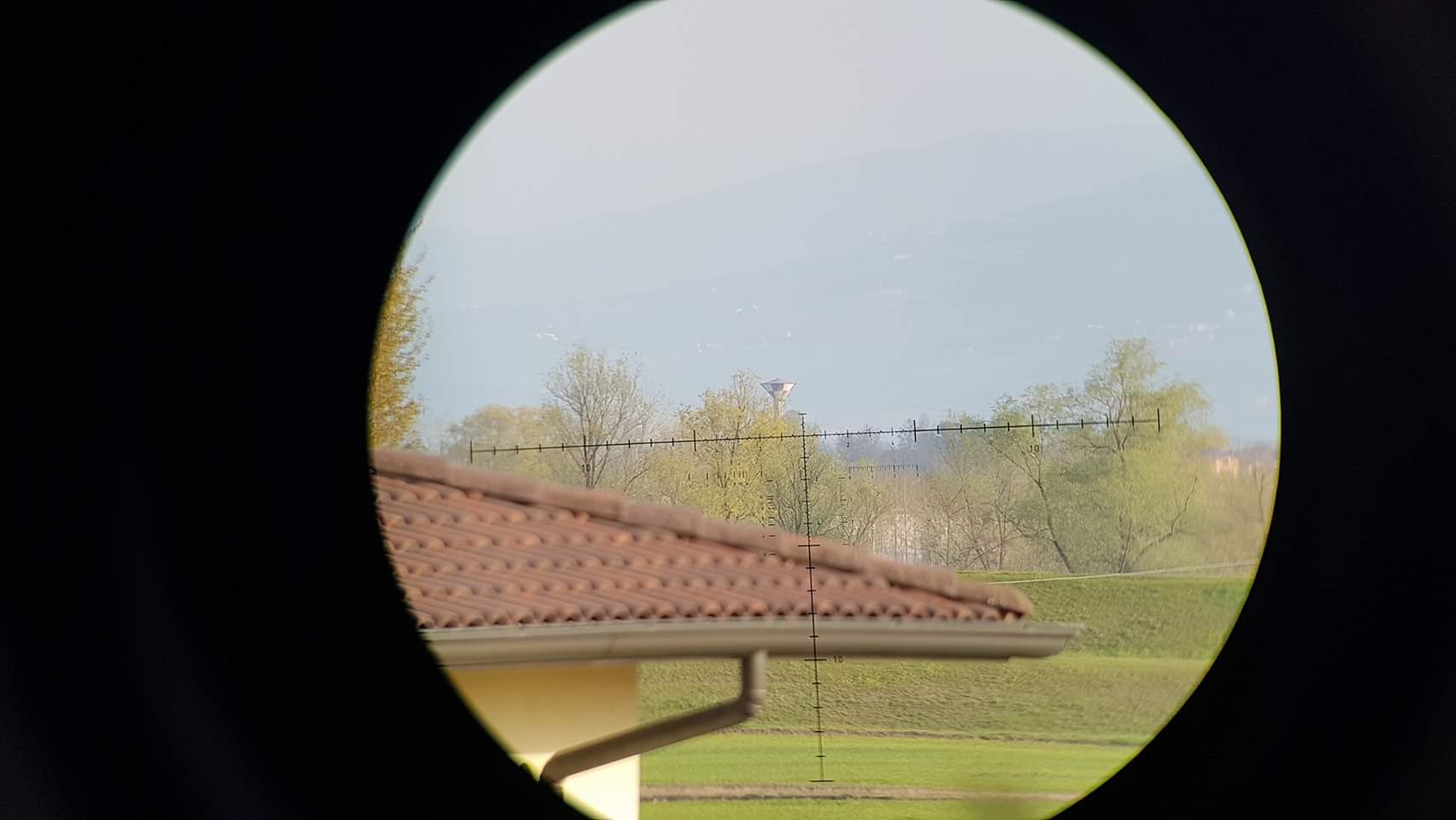

Vortex is coming out with a ranging reticle eyepiece for the new Razor HD spotting scopes. It'd be upper end of your budget once you add the reticle, but my vote would be Razor HD with the new ranging eyepiece when it's released.

If it is like their first ranging eyepiece, it will be a fixed 30x....... As is the new Burriis (which I believe will also fit the fist gen Vortex and the Swaro's).

subtensions will be different.......but it will 'fit'

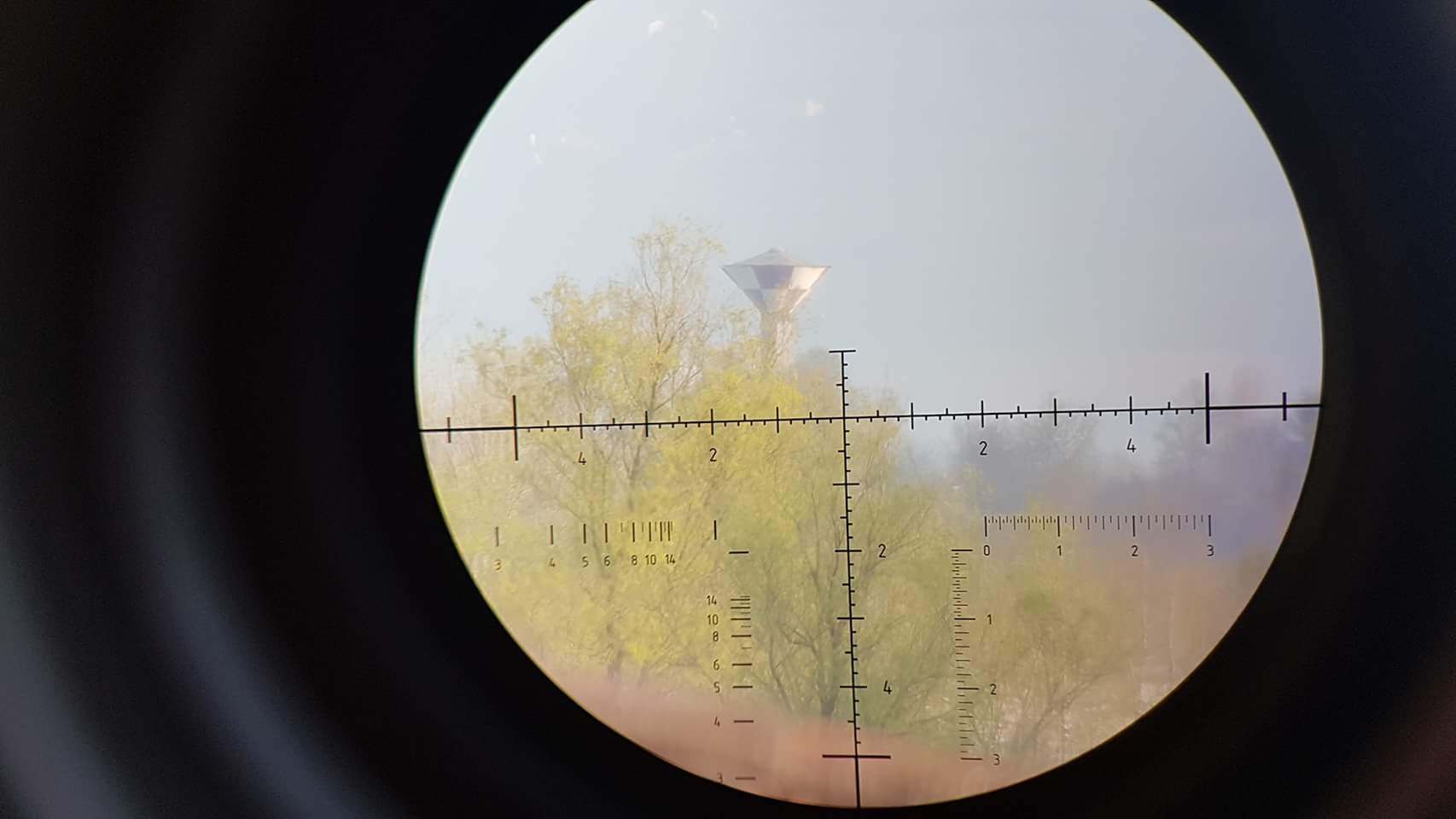

^^^^ This. The eyepiece fits but a mil is no longer a mil. That's why they say it is only for the 27-60. Same for the gen 1 razors. The vortex reticle is awesome though. Off set L shape so it doesn't impede trace spotting. If you go with a Mk4 I prefer the inverted H32 reticle for the same reason.

I bought a used Mark 4 with the TMR last year with a manfrotto tripod for 1k off ebay. Awesome spotting scope due to the light weight and compact size and the glass is awesome. I was looking at razor’s and the Cronus before, but they are just heavy!
