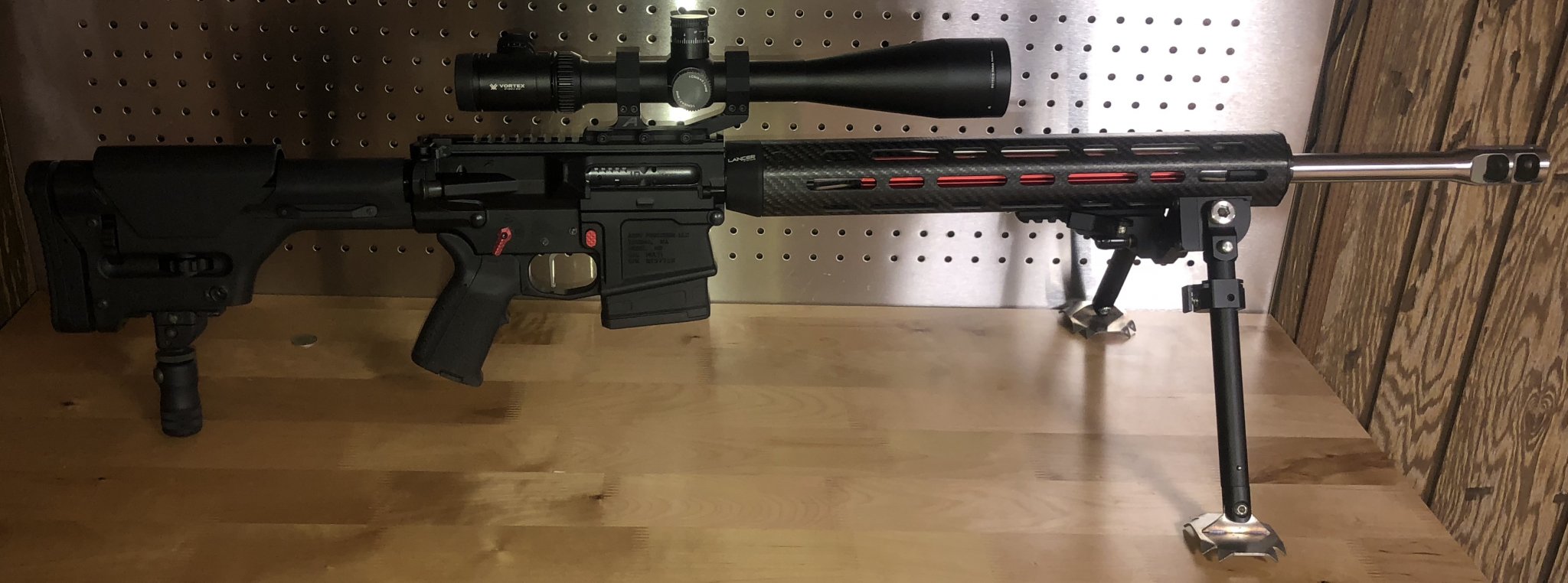

I couldn’t justify spending the money on the full jp precision lrp-07 so I bought the most impoparts of it. The barrel/bolt combo with gas block and all moving parts. Put them in an aero precision matched upper and lower with a trigger tech trigger and lancer carbon fiber hand guard. The gun shoots amazing wiTh the only malfunction coming when I adjusted the gas block to low. Love everything about it except the hand guard. It looks amazing but doesn’t tighten up. Has a little slop.

Nice build! The Aero matched upper and lower are a heck of a value! What bolt and buffer are you running? When I built mine I tried the Wojtek adjustable gas block, thought that if it didn't work I wouldn't be out a bunch of money. It does everything an adjustable gas block is suppose to do at around 1/3 the cost. Check them out on your next build, you'll be pleasantly surprised! I have no affiliation, just satisfied with the product and service, and Hate overpaying for anything!
Mike
