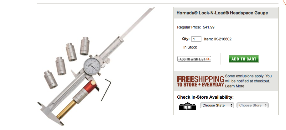

I like the Lee classic turret press with the auto-rotate rod removed so it operates as a single stage. It uses a 4 hole die plate and, when you want to change calibers, you just lift the old plate out and put the new plate in.
Hardest part for me on the bottleneck rifle rounds is getting the shoulder set right. Hornady makes a great (IMO) headspace measuring tool to get the shoulder right.
