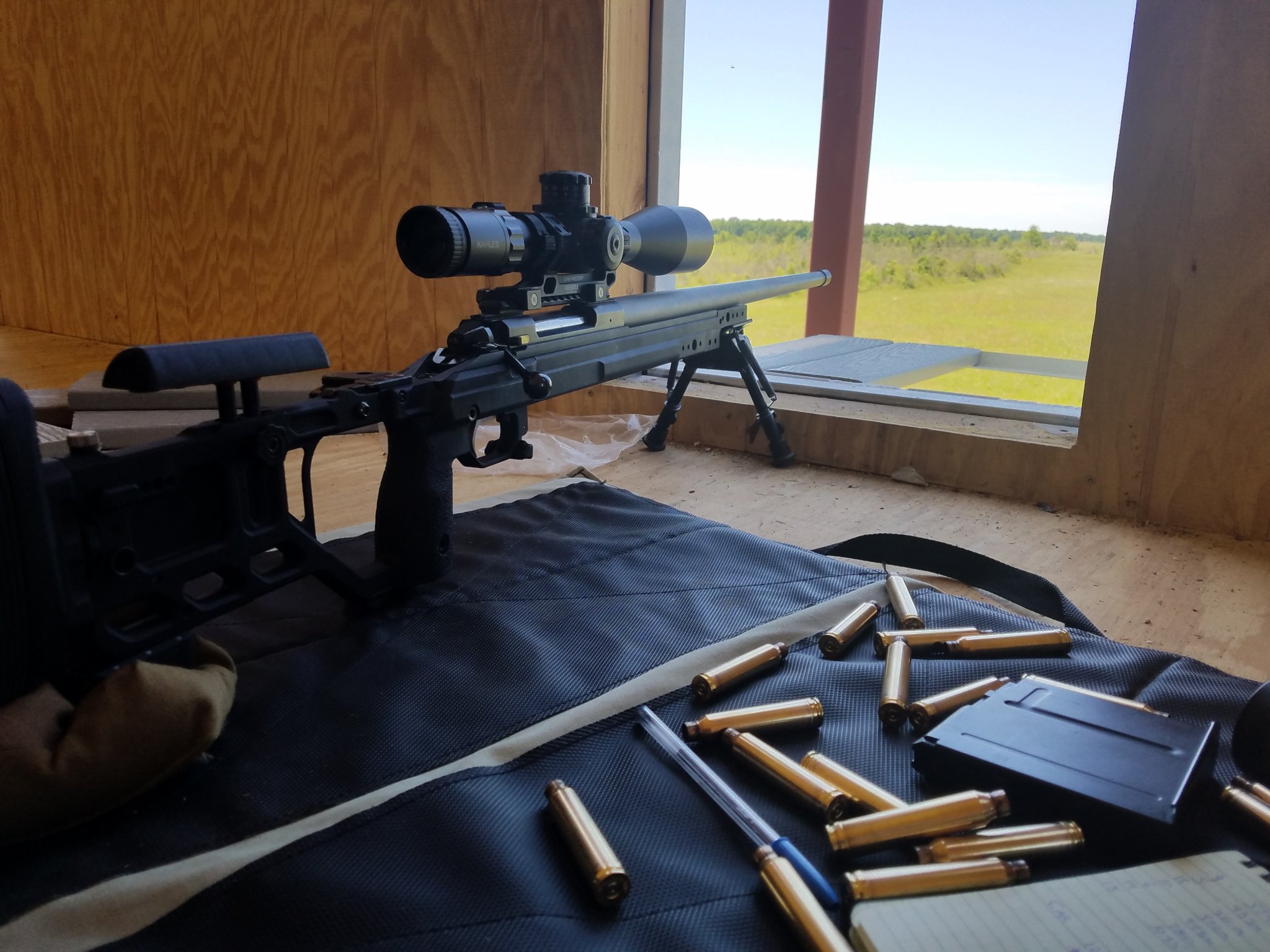

I went down this road and settled on Norma brass. Lapua used to make 300WM brass but it was actually made by Norma for Lapua.
Nosler Brass is weight sorted Norma brass.
Only have 20 pieces of Hornady brass from a box of ammo I shot.

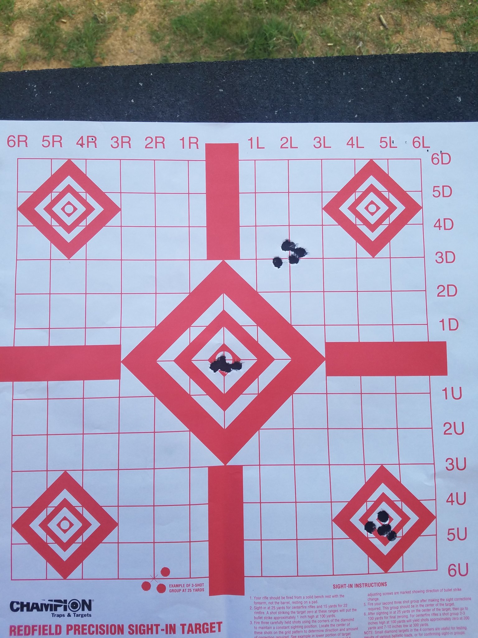

Attached is how it shoots at 100 yards. I've had the rifle out to 2500 yards, with easy hits out to 1300 yards.
