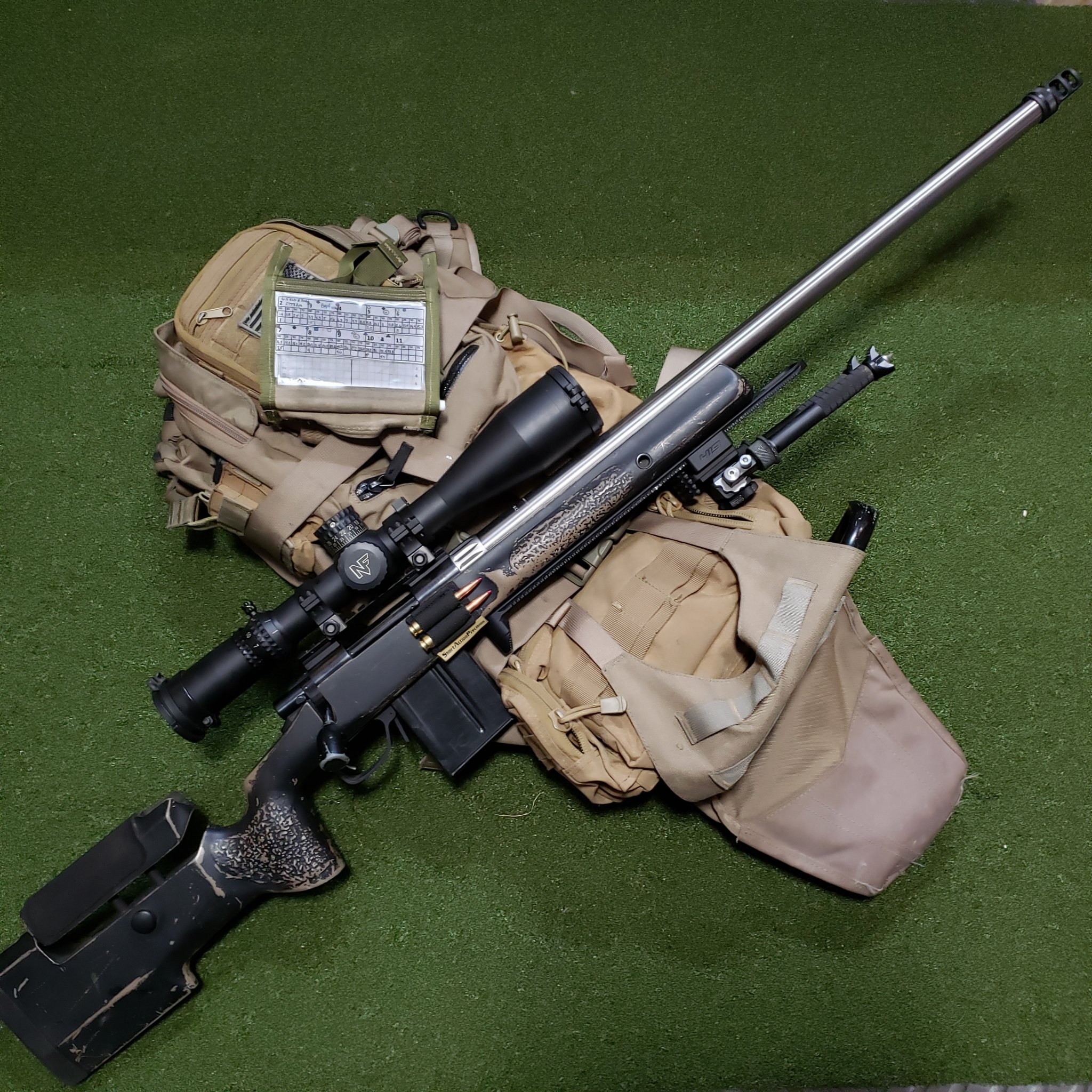

I've built several Howa 1500 rifles and have run 10,000+ rounds through them over the years. Always solid and repeatable.
-Criterion prefits barrels when you burn out the factory tube. Use Bighorn barrel nut for DIY barrel changes.
-Timney trigger available 1.5-4lbs
-Manners, HS Precision, MDT, MPA and more offer -stocks/chassis.
Like others have said, the Bergara does have an edge on total parts available but there are some benefits to the Howa action that can be easy to overlook:
  • HACT trigger is pretty damn good! Feels more like a Timney than a factory trigger.
  • Beefy Integral tapered recoil lug; easy to bed
  • Front Action screw bolts into bottom of recoil lug so zero movement when torqued.
  • Rear action screw located behind trigger and mounts into rear tang.
  • Flat bottom action pattern helps with consistentcy when bedding into stock.
  • Three position safety so you can cycle action while on safe (not sure if Berg has this)
  • Mauser style extractor to get positive extraction without slipping over rim.
  • Bayonet style firing pin disassembly; easy to take apart and reassemble with zero tools.
  • SubMOA guarantee for life of rifle; may or may not matter depending on your needs though.
  • Legacy Sports has AWESOME customer service and have been active here on hide lately. @Matt @ LSI can take care of you if you run into any issues/questions.
I've built 6 Howas and all of them shot 1/2 or better (except the 308, that was closer to .75).
Either rifle is great option, but my vote goes to Howa for the reasons above.

Thank you for the detailed layout. I appreciate it. I do love the look of that chassis. The sub MOA guarantee is awesome and honestly the fact that customer service is great is huge to me so that's good to know!! I like a company that stands behind their products so strongly.

One other benefit I failed to mention is that the action turns smooth as glass on silk after a few hundred cycles. They are good out of the box but amazing after being run for a bit.
I'm most actions will do this to but some need more love to get to that point. I've heard Bergaras are better than most in this regard.
Just remember that nothing is forever. You can always buy another rifle that fills in your gaps when find out what you like/dislike.
Post back when you have your new rifle in hand! Good luck!

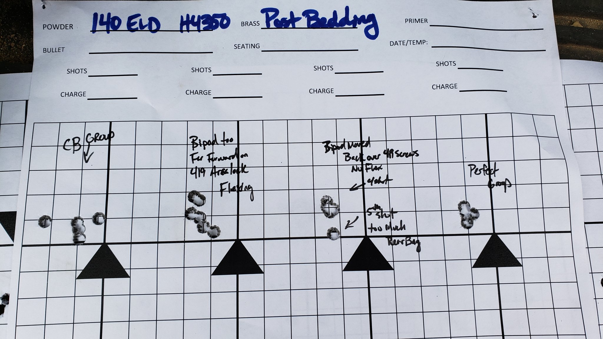

Here's results after rebuilding and playing with bipod position on Arcalock rail. Just shot it today; first time since rebuild.
Howa 1500 Criterion barrel, 140 ELD 41gr H4350. Last two groups shot back to back with minor rear bag position change. Goes to show just how much rear bag and bipod position can affect groups even at 100yds.
Reactions: Americaninfidel55
