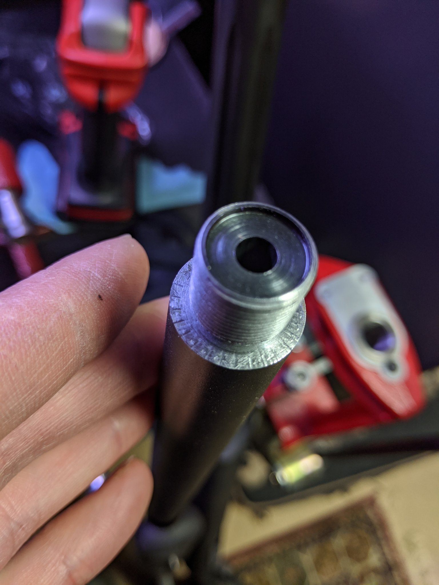

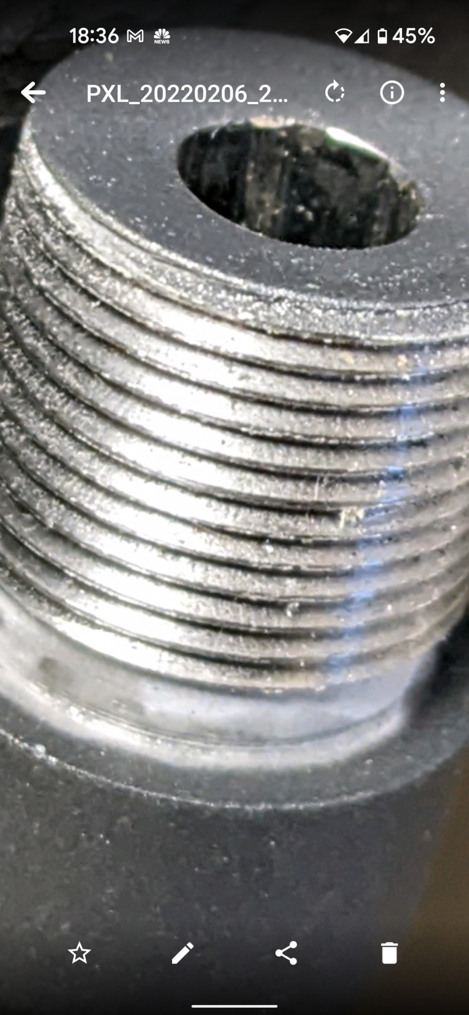

I may have messed up. Went with a new to me smith and am a little concerned about the work quality. 2 of the three rifles have some issues. one has jagged threads that might clean up with a chase but it has me worried about the runout while it was in the jig. the other has a bit of a bumpy shoulder with some tool marks. should i be taking these to another smith to check out?

Wow, that’s just garbage.

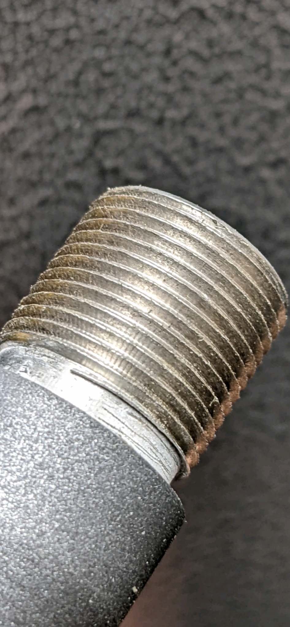

Edit: Regarding the boogered thread, looks like a few passes we’re made out of time with the rest of the thread, which created two flanks where there should be one. With all the gnarly burrs, I would not torque anything on to that, as it may become stuck.

I just got sick.... ugly machining....
What did they say when you asked them.
he said he could chase the one but liked how tight it locked up as it is. i haven't bothered to ask about the shoulder of the other. unfortunately, i was distracted by my other issue on the 3rd gun. threads looked nice but the safety doesn't function and the trigger pull varies. it was a new out of the box rifle from cabelas and the photo i saw of the throat erosion plus worn internal parts lead the smith to believe otherwise.

Without getting too far into it. I’m 99% positive he didn’t even measure the theads on the rough looking one. I would say he just did the guess and try it out method.

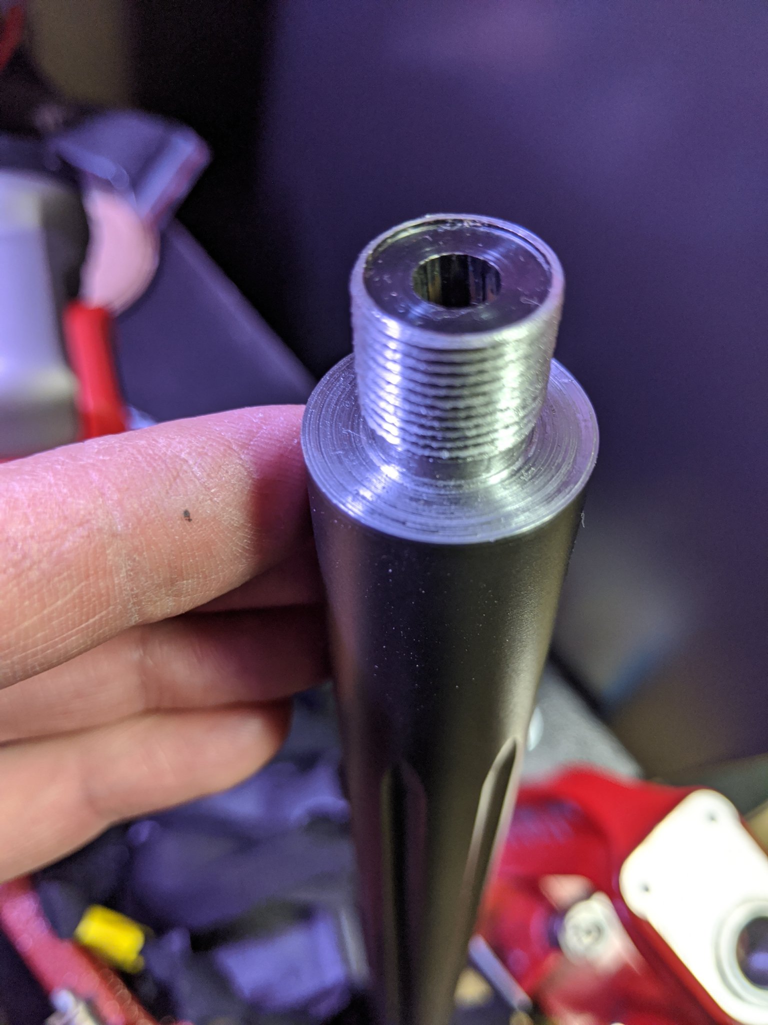

I'm trying to figger out how to get that kind of chatter on the face of the shoulder. I don't think I could do it if I tried.
Looks like there may be enough meat on the tenon to turn down and re-thread with smaller diameter, and use corresponding adapter for the can?

Looks like he didn’t have the barrels good and secured in the machine meaning he had it only supported in the chuck and let it dance on him for the chatter but he is no machinist for sure. No pride in his work

I was thinking the same thing. He must have been turning without a live center to have that kind of chatter, but it looks more like the marks are pressed in. Either way, I would NOT put anything on there. I think you should take them to a smith and get his opinion.

Another option is to have a Smith who knows what he is doing dial it in on the lathe, pick up the thread, take a clean up pass on the threads and shoulder, and then measure to see if it is in spec. It might be possible to take a clean up cut and still be left with an in spec thread.

Who ever machined those barrels doesn't understand how to set up their tooling or care about the end result. The barrel shoulder has chatter but can be saved, the threading tool was rubbing and those threads may be a wash. If I had that barrel in my lathe I'd cut it off and start over. Any competent smith/builder will do the same.
If the existing thread is anything close to the appropriate pitch diameter then this option won't work.

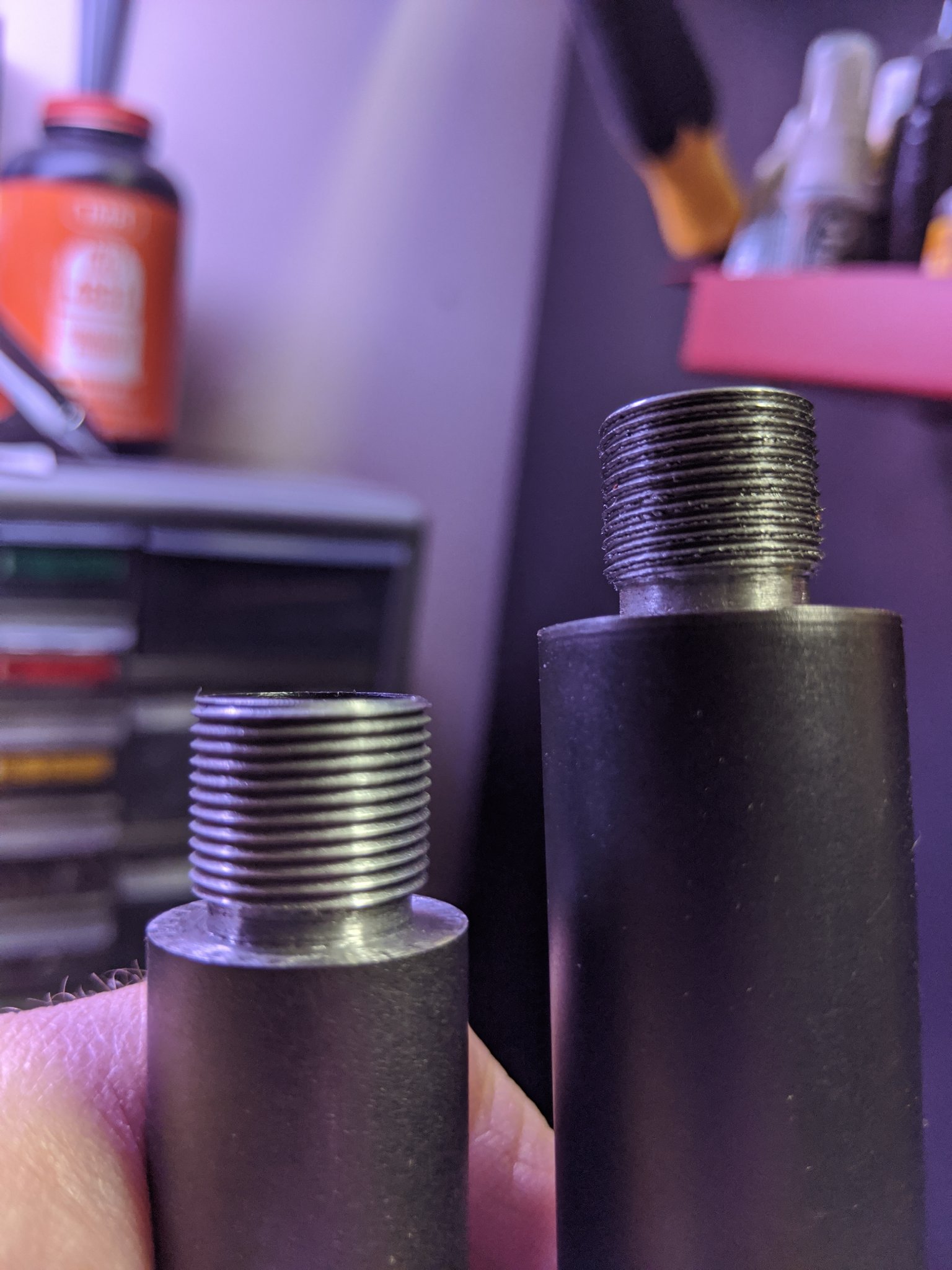

Just to clarify:
the one with really bad threads is cut 5/8-24 and is a savage 12 LRP in 6.5 CM. the one with a horrible shoulder is a savage 223 w/ a target bbl threaded 5/8-24 as well. not sure if threads can be salvaged there either. they look better but still doesn't thread anything on with out some effort. the 3rd rifle is a kimber hunter pro threaded 1/2-28. it was supposed to be 17" inches. i wanted 18" but we agreed there would be more meat to thread with a good shoulder at 17". not sure how it ended up at 16" but i haven't had time to measure it since the smith still has it in his possession. he found it had a bad chamber and inoperable safety.

The 5/8"-24 threads can be easily turned off and fully cleaned up for a 9/16" tenon of whatever common pitch is desired.
9/16" still leaves adequate barrel wall thickness for a 6.5- unless you must have the 5/8" tenon there's no reason to cut the barrel.
5/8" minor is .575, well above the .562 and under needed.
