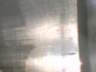

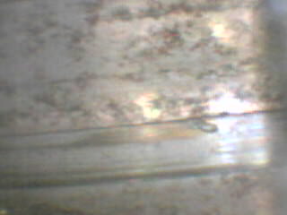

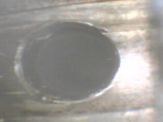

Bore scoping it, the chamber and throat were cut rough, the port had a substantial bur, and there were some other imperfections in the barrel I have not seen with anything else. This was from their premium match line.
As mentioned, it does shoot well enough for most general use and I do not think the quality is out of line for what they cost at usual sale or add-to-cart prices.

#44
Found my bore scope pictures. It was on an assembled upper and had been test fired. The rough throat, burred port, and some other artifacts are visible.
I still think they are a pretty good deal for what they usually cost. Usable barrels that shoot well enough for most carbine use up to action shooting matches and you won't be afraid to flog.
