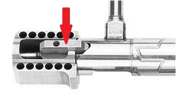

I ran into the same problem on my M2013. I used a Timney 2 Stage Trigger (the red one, not the blue Calvin Elite) and immediately began to have light primer strikes. I installed a factory Remington trigger and no light primer strikes. I called Timney and spoke with Tim who advised there was nothing that could be adjusted in the trigger and no alternate/longer sears were available. Later, I found several posts in various forums where a replacement sear was available from Timney which would lengthen the firing pin fall.
I called Timney the next day and spoke with Nate who said, "Why sure, I'll send you the longer sear." A few days later I received a package with a replacement sear. I installed it, and no more light primer strikes. Per Marty's advise, I also shortened the firing pin protrusion to the shorter side of the recommended distance which increased the pin fall distance. Now 500 rounds later, no FTF/light primer strikes.

The issue is the sear does not drop far enough, this leaves the cocking piece dragging and no bang.
This wasn't the cause in my case. The sear was not dragging on the cocking piece. The cause was the sear not holding the firing pin back far enough.
I marked the top of the cocking piece with a Sharpie pen and cycled the bolt through a dozen dry firing cycles. Upon disassembly, there was no contact marks between the sear and the cocking piece. The photo below is a stock photo - the red arrows shows where on the cocking piece I applied the ink and did not see any contact marks.

I PM'd you regarding Timney, but something else to consider. I had the benefit of owning an Accuracy International AX when I was building my M2013 rifle. When I examined the cocking piece of the AI action, there were faint marks caused by the trigger sear. From this, I think that some contact is normal. I have faint marks on my M2013 cocking piece, so some contact seems normal. Excessive marks would indicate dragging.
Have you measured your firing pin protrusion? The range is .042" - .062". Set yours at the .042" and test. Another point, this is a tough measurement to make with a caliper micrometer. Use a depth micrometer, it is much more stable and reliable. If you don't have access to one PM me, I'll loan you one.
