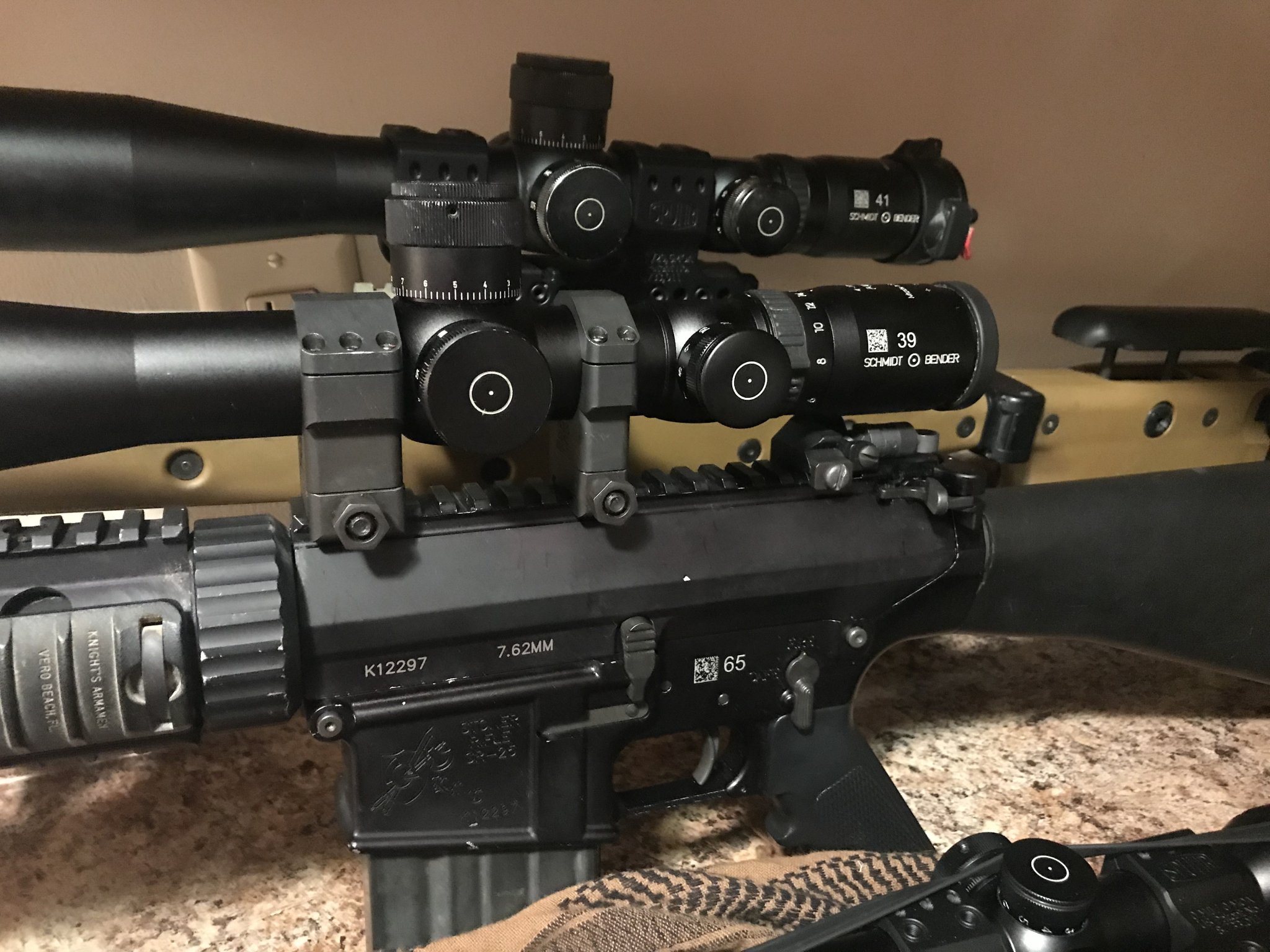

I run the 4-16x42's on my precision AR's mounted via Badger Uni-Mount, and the 4-16x50's on my TRG-22's mounted via Near Alpha mount. They all have the Gen 2 Mildot, which are a great combination with 223 and 308 in the field. The 13-mil turret limit is just about at the ballistic limits of the two cartridges. Was just shooting both AR's out to 800-yards today, and 16X was more than enough magnification for steel targets.
I've done well with this setup on my AR's in various team matches. In my opinion, the SB 4-16 is the perfect scope for a Mk12 SPR senario.
I did recently purchased a 3-20 Ultra-Short with MSR reticle to add to a precision AR, but haven't had the time to get a mount ordered yet.IMG_20180927_205338717_LL.jpg
