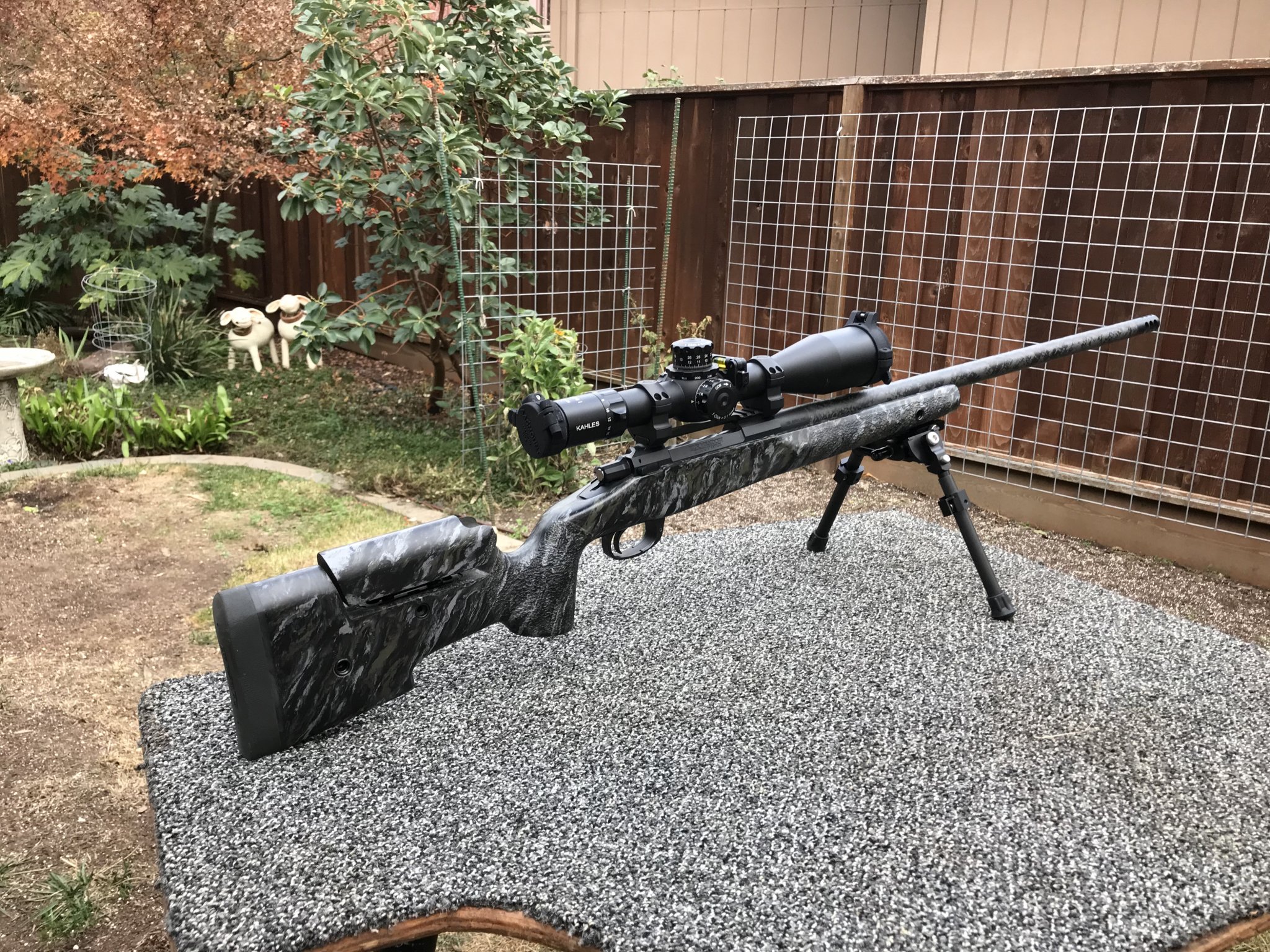

Looking at building a 300 Norma in 2019 and seems I'll go with a Defiance Tactical 'Deviant Tactical' receiver. A Bartlein barrel and I've yet to select a stock and trigger. Any suggestions on those? I'll top it with my current Vortex Razor Gen2. Time to step up from the 308 kiddie table I guess. Hopefully 2019 will be better than 2018 for my shooting.
kthomas
Belligerents
Jun 17, 2009
1,235
795
219
31
Houston, TX
Just found this thread and went to post and my old userid/pass no longer workie....so made a new account.
My Deviant .300NM sits in a JAE chassis and has a BnA 2 atage Tacsport trigger. I really like this combo.

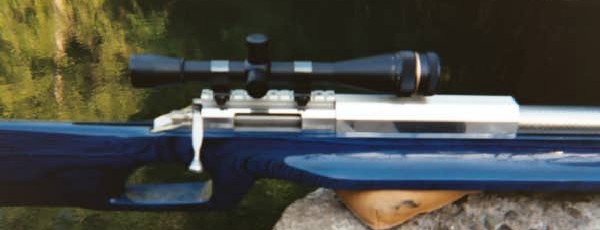

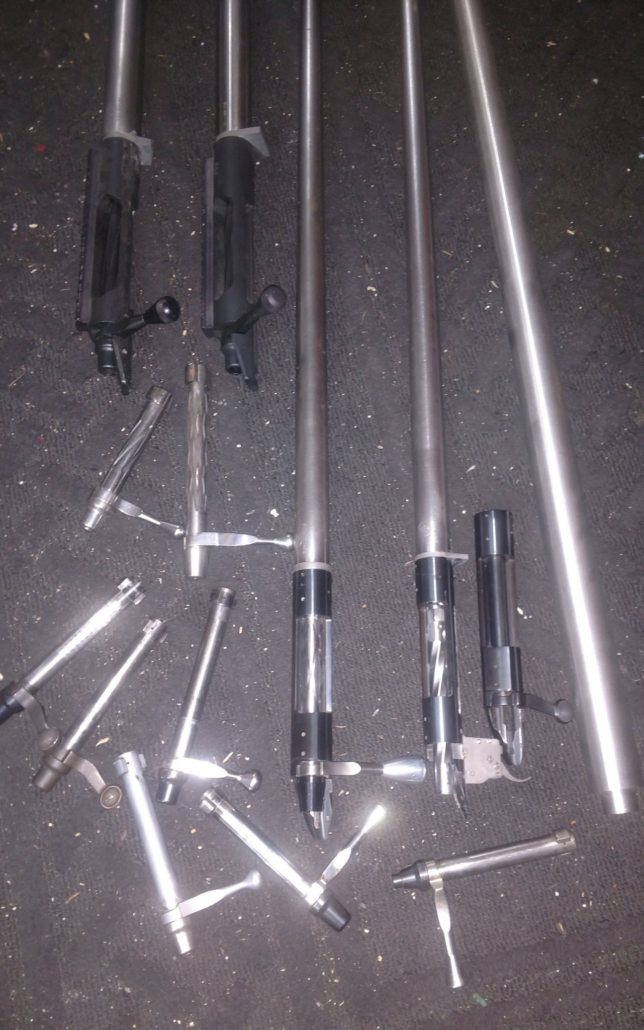

:rolleyes:
The Tac338 actions are not a trued up Remington they are closer to a factory Remington with there bolt fit.
If you true up the Remington 700 you pick the clearance from zero to 0.003
If you don't true it and use the 0.701 bolt diameter you end up between 1.5-2 thousandths of clearance depending on were you started.
The video is two of my Stiller Tac actions which have 3-4 thousandths clearance but cost $1130 each.
The plus is you get a side bolt release and a pinned recoil lug if that matters to you.
I bed my bases even on the Stiller's and don't use any release agent at all. Never had a problem with the factory hardware on any action.
I fell on my cellphone and broke the camera glass while hunting so the video quality isn't good.
I use most any action out there and they all will work but I like to save money unless it is necessary.

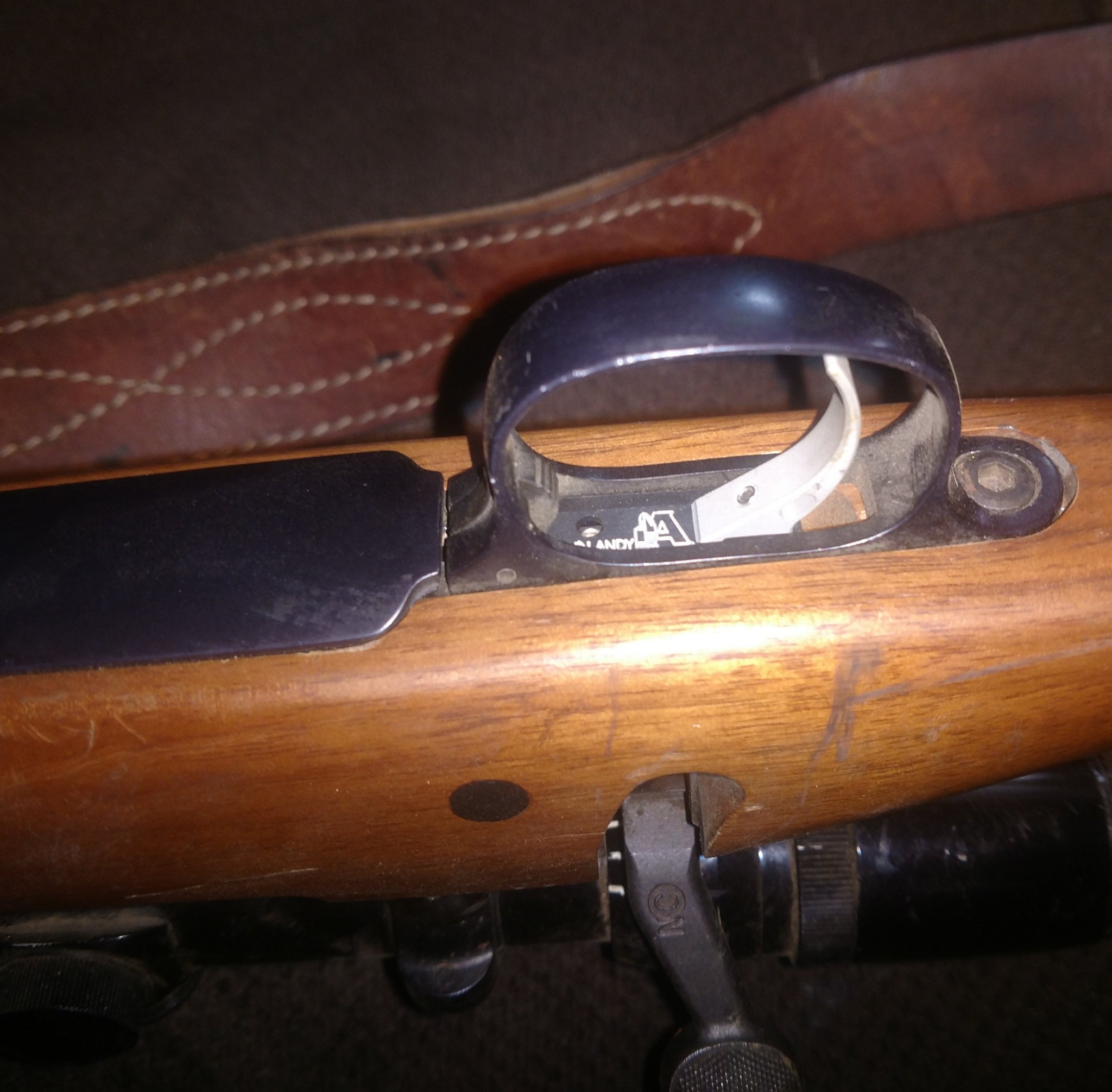

When a bolt fits loosely the pressure from the firing pin spring at 22 pounds plus and trigger cock the bolt body off of the lug abutments. No need lapping the lugs if only the edge is making contact until fired
The difference in accuracy is my groups to your groups.
If your happy with your groups and your gun has a sloppy fitting bolt your all set. When you have an action trued it is to get rid of the slop.
I also hunt with triggers lighter than most here use on there target guns.
The picture is my 700 deer gun with a 0.268 neck chamber in 6mm-06 with a Bix&Andy 1.5 ounce trigger.
Most here don't turn necks. Most here don't use light triggers.
Lots of gun myths on the internet about what works and what doesn't.
I tend to find out for myself what works and what is a myth.
The good thing about working with a 700 is you get to pick your bolt clearance. If you like it tight or loose it's up to you.

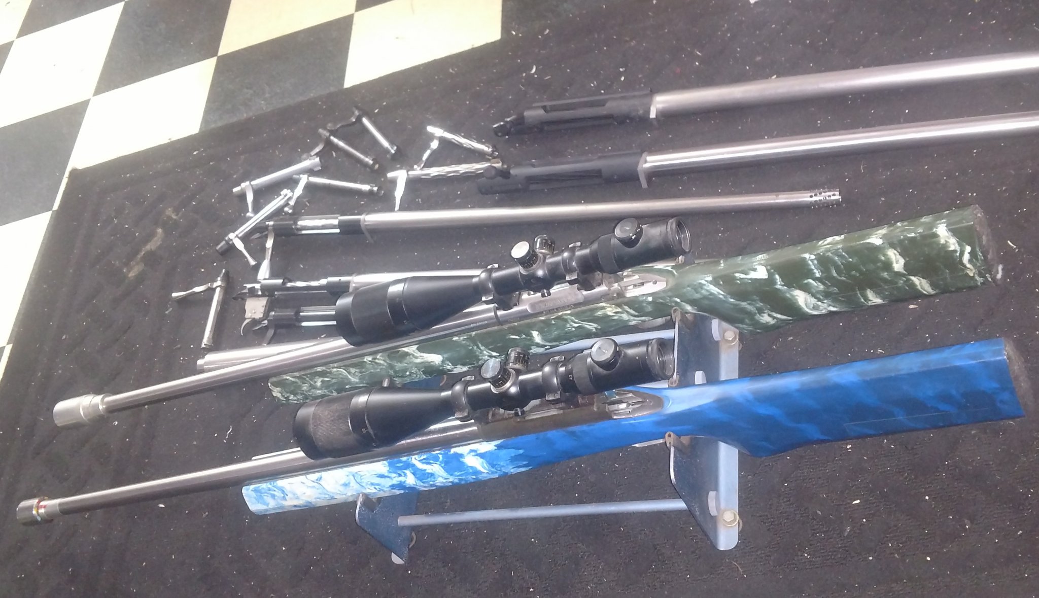

I have 700's in 338 Lapua Ackley Improved and 338 Norma Ackley Improved and run URSA 2000 yard matches and have never seen the problems described above.
The picture shows my blue 700 with a Stiller tuner that tied the score world record at 1000 yards and the green gun is a Stiller Predator that did set the score world record at 1000 yards using a Harrell's tuner.
I like Stiller's and own many of them despite what others might post here.
The 700 in my humble opinion works despite the smaller bolt diameter.
