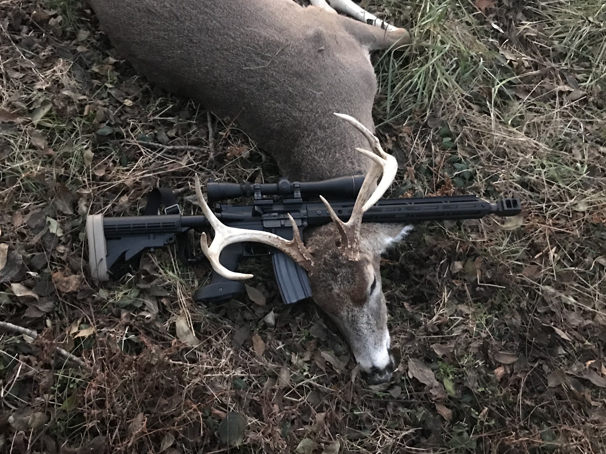

Likewise, when michigan allowed us shotgun zone hunters to use straight walled cartridges for deer hunting I built both a bolt and AR bushmaster. My AR wears a 16" brownells barrel and is plenty accurate to take deer down inside 300 yards provided the wind isn't blowing. 200 if it is.
Ive taken the bolt out to 500 and at its velocity it is still faster and has more energy than a 45acp shooting 230's at the muzzle. Though it can be tough to connect if the wind isnt cooperating.
Attached is my AR.
Reactions: hermosabeach
