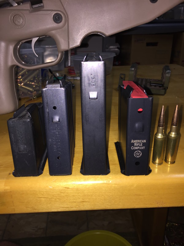

Does anyone have a picture to show a size comparison between ARC and AICS, AW, or Alpha mags?? I'd appreciate it!
The original that debuted at SHOT was 3/8ths of an inch longer than the AW. I'll have a pic after i see my friends ARC next weekend at LPRC.
Side by side with a 10 rounds AI aics mag. I don't own any AW mags.

Pretty sure after they had to delay it, the actual production model is equal to or shorter then the AW. I thought I remember that in the ARC mag thread but I could be wrong.
That's pretty impressive if so, and negating the need for AW less you run a Tempest or AI. I definitely want to rid of all my AICS except the 5rd with the core 2rd extension. Though my comp gun is on a Tempest so i'm also looking to pick up another AW mags.
I hope however that Ted moves production of his mags beyond 308 if they're bringing him enough profit to justify the cost. Finding SAUM mags is a bit of a pain as there are only two players, Alpha and Accurate.

just got two mags in that I ordered directly from ted himself just tested at the house and both are feeding perfectly with my mausingfield in an aiax aics chassis... I stuffed 10 6.5x47 rounds in and all ran butter smooth!!! Way better than my ai mags so far but have not been in the field yet so we'll see how they hold up. I think a 200+ round overnight camp/shoot will put them to the test!
