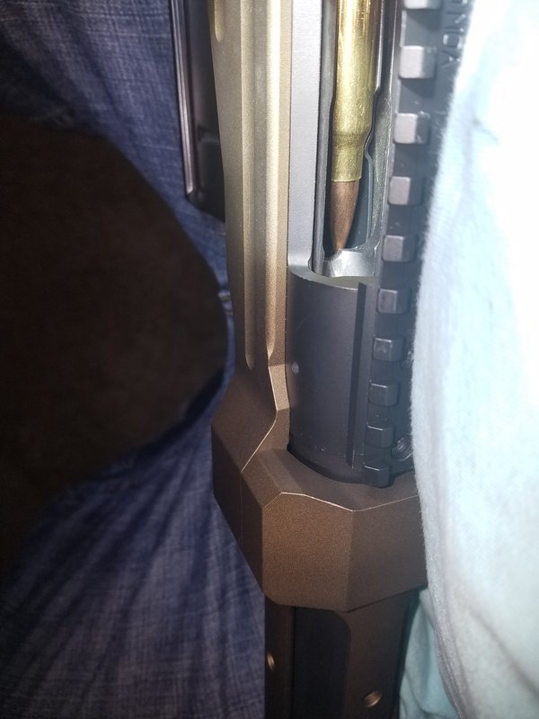

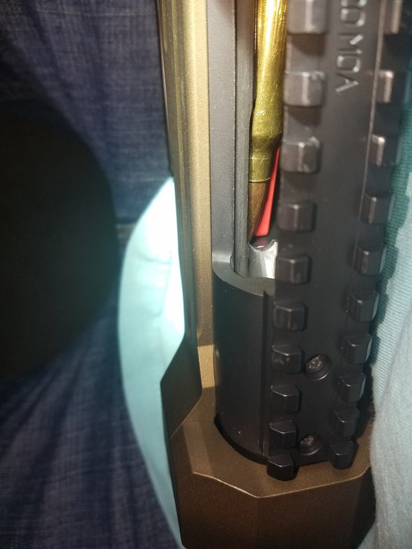

Well here's my experience today.... I couldn't get a clean 10 rounds through them. I have 2 and both acted the same.
I have a Mausingfield in a krg chassis. One of two things would occur. Either they would nose dive and the round would just jam forward, not feeding into the chamber. If you hit the bolt hard enough, it would just nick the rim and go forward without feeding.
The other was the follower would jam sideways as the mag had less rounds in it. Unfortunately, one of these two events occurred on every single mag. Never did I get through ten rounds without a hiccup. I included pics here.
One thing I did notice was the follower would jam stuck if I pushed down on just the front. It would stick in the mag and not spring back up. My AI mags don't do that. No matter how that follower goes down, it always comes back up true.
Sent from my iPhone using Tapatalk

#48
I believe I am seeing the same issue as Stag556 is.
I first thought these mags were great because my issues with Alpha mags have been that they wont even fit with 10 rounds in them as the sides bulge out and the AICS magazines are very difficult to chamber a round when it is full.
The ARC mags did not bulge at all when fully loaded and they fit in perfectly in the mag well. They are also really smooth loading those first rounds of a full magazine.
I loaded 8 live rounds and 2 snap caps on top so I was only chambering the first 2 rounds. After seeing what Stag556 said, I took out my firing pin and started running the full magazine. The issue I see is that the front of the follower gets stuck and the round just jams into the front of the magazine, if you push the back of the case back in the magazine the front will reset but I have been trying to get all 10 to work flawlessly and at least one gets stuck, usually in the bottom half of the magazine (after 5 have successfully been chambered and extracted).
In my excitement yesterday I ordered 2 more but I have since requested that order be canceled. Hopefully other people have this issue and a resolution or workaround is discovered otherwise I am back to only having one smooth properly running mag (my AICS 5 rounder).

#50
I figured out what the issue is with my setup, the tip of the bullets are getting caught on the ramp in the action. I don't really know who to place the blame on for this one, I am sure I could have my smith fix it so that the ramp isn't obstructing the magazine.
