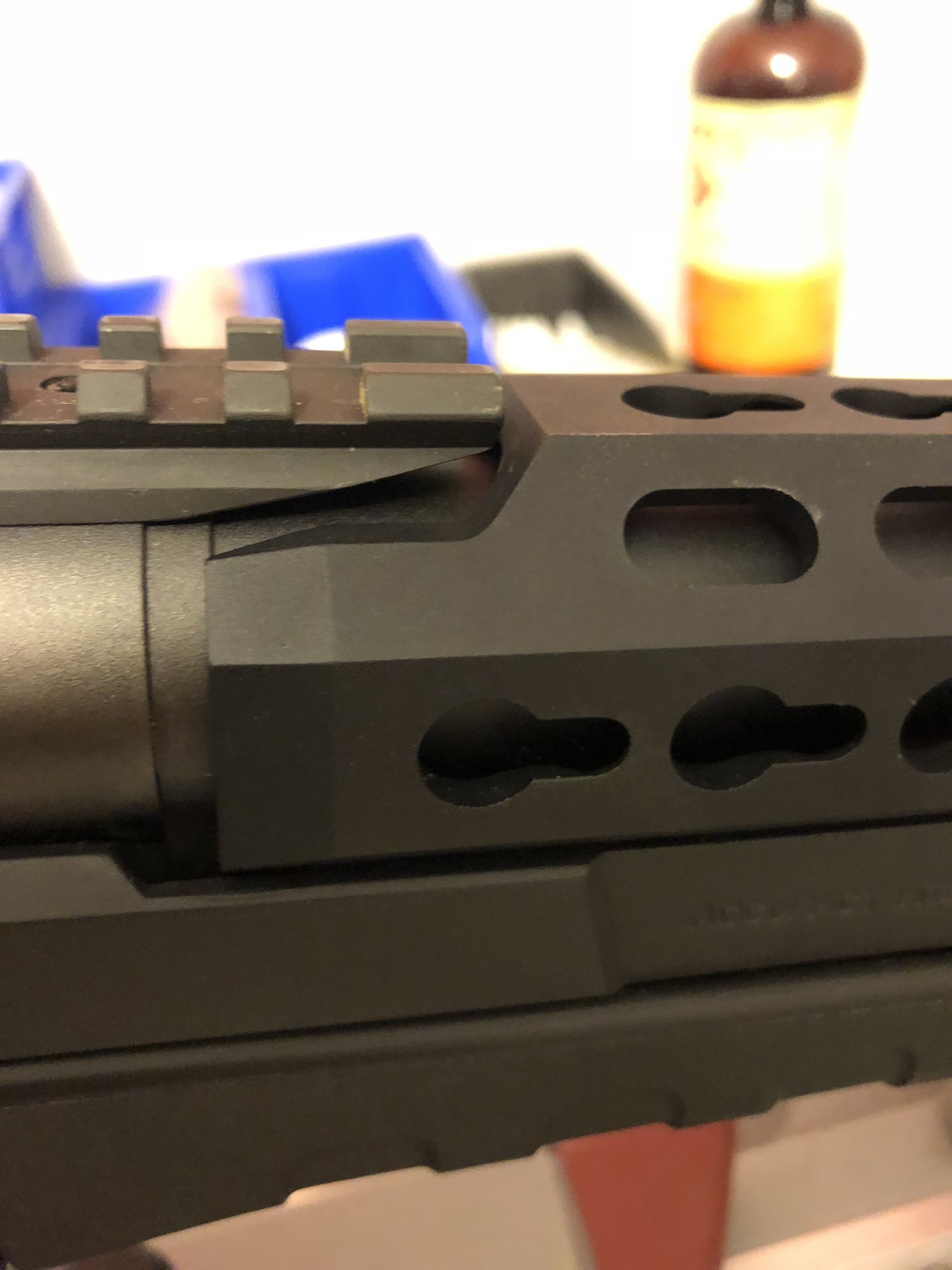

Let provide better context for my scenario, and why I mentioned pulling the action. So I pre ordered the nucleus action with barrel nut barloc with the intent to drop it in an aiax chassis. I guess I have two concerns at this point. 1) will there even be enough clearance for the barloc to clear the forend? 2) If it clears the forend, would the nut be covered by the forend.
So I suppose if it clears and ends up being covered by the forend, I would only need to remove it (and potentially the scope) vs pulling the action right? Ted had previously sent me a note stating that he thought it would clear the forend, but that’s pretty tight space. Thanks for any additional insights.

I don't have an AX so I couldn't tell you. Either or both may not clear. Or maybe they both do.
Worst case scenario is removing the handguard and scope for a caliber swap. Still beats a vice and bench.

Worst case scenario is the forend contacts the barloc not allowing that chassis to work with that setup. If that’s not the case, then I think you’re correct in what I may need to do regarding the forend removal etc. and would be easier than the traditional route. I’ll just have to test fit once I get it, and go from there.

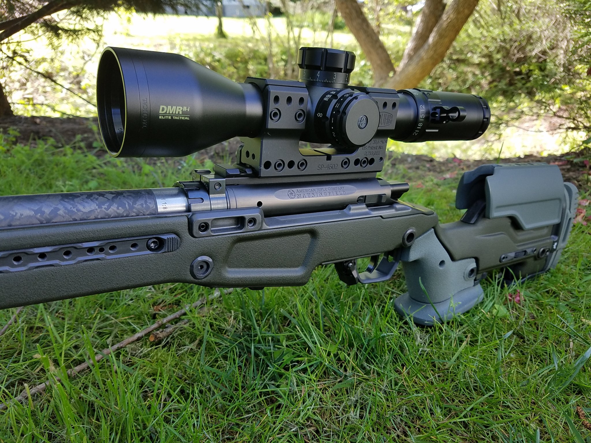

I’ll post pics so that others have a reference

It looks like the barloc might not fit with extended front rails. Anyone know if the barloc rides underneath the extended portion of the rail? I have seekins rails on a savage and rem 700 and am concerned they might contact each other.
jram
Belligerents
Mar 27, 2018
119
32
34
Saginaw, TX
It’s early and that previous post was influenced by my morning mental fog. Im concerned about scope bases that extend past the front of the action not front rails for NVDs.

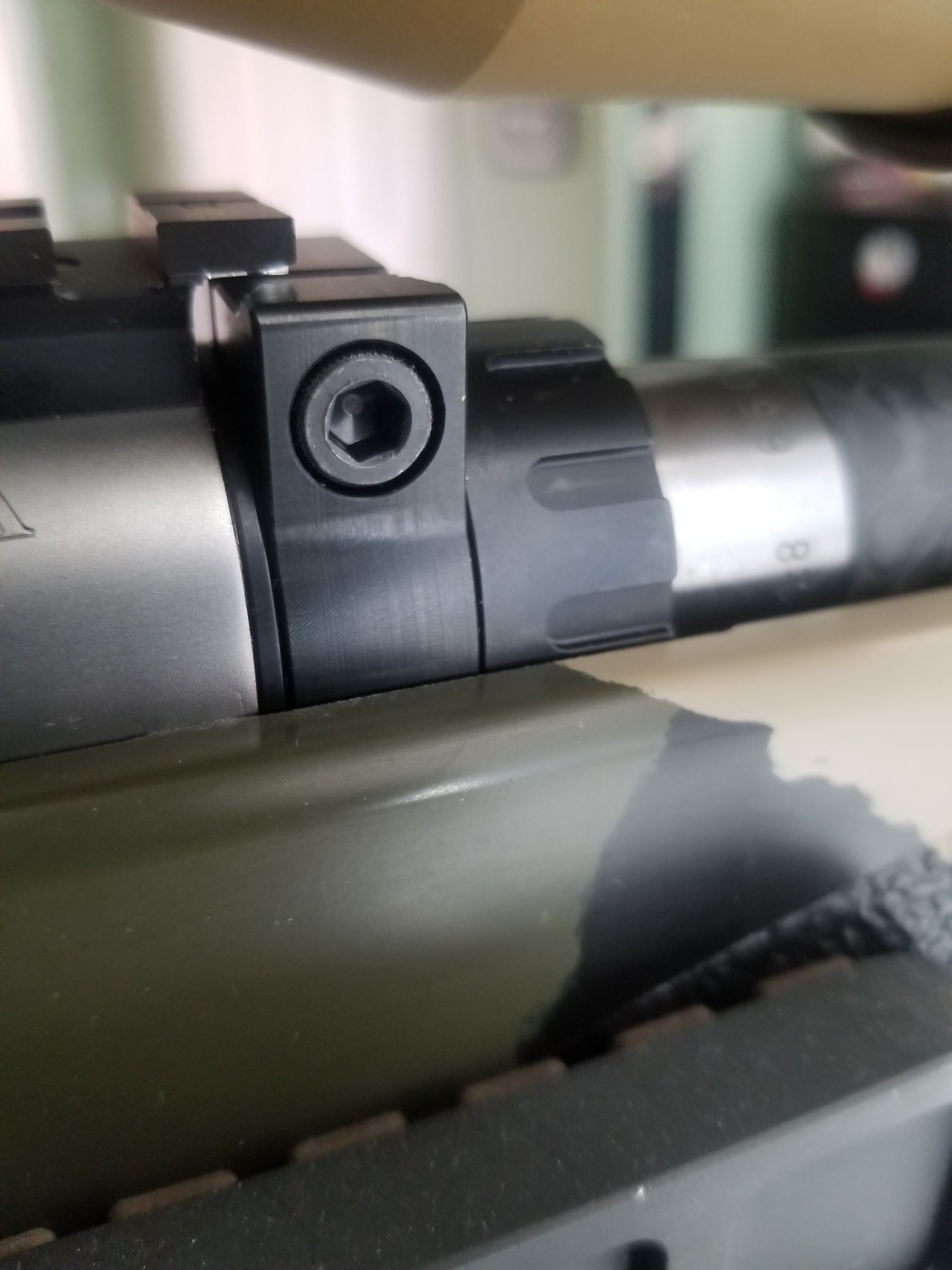

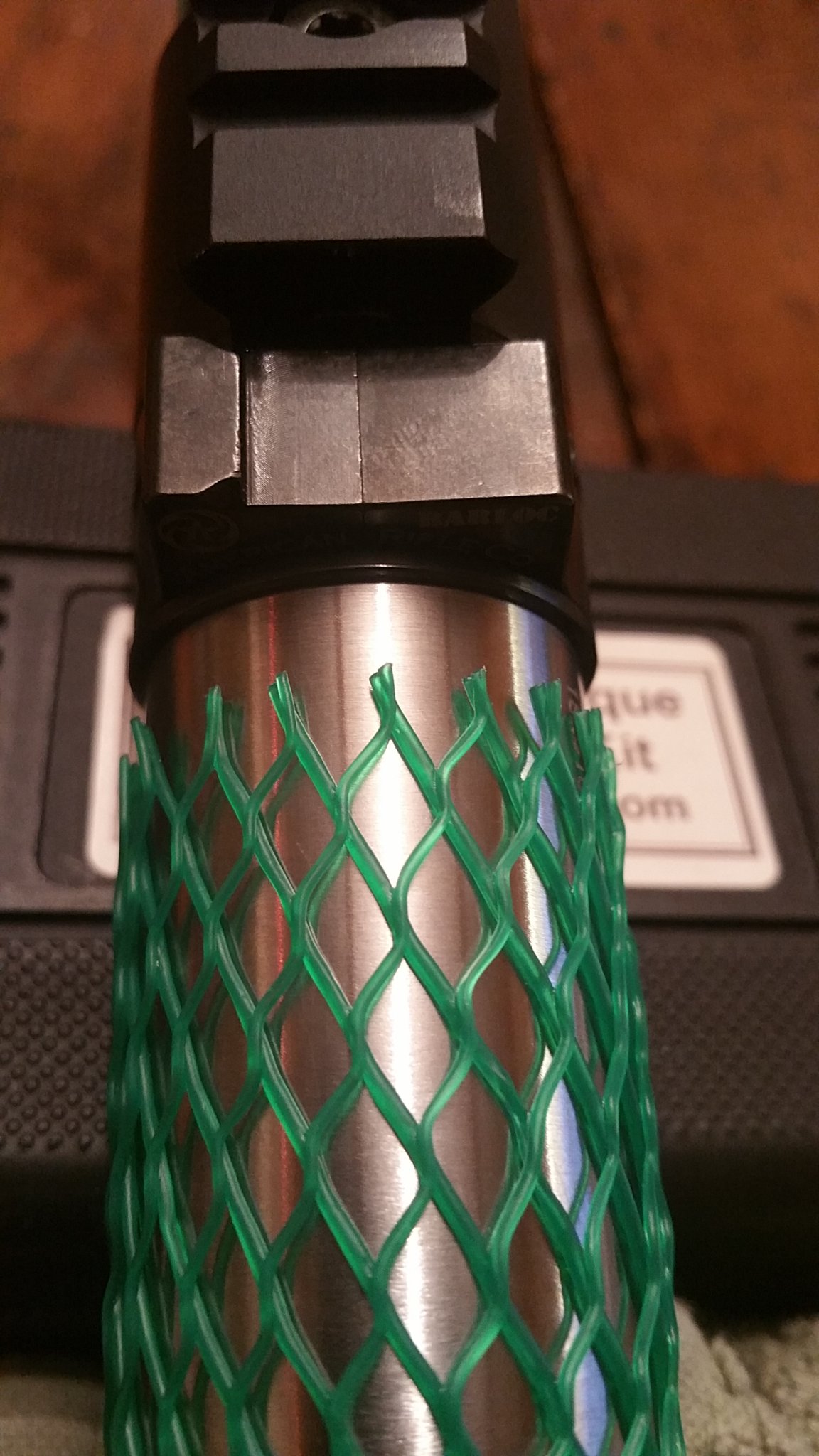

I installed this barloc on a PVA shouldered prefit. There is zero gap in the collar unlike the barrel nut version. Does this look correct to all that have experience with it? It is torqued to 90in/lb
Ericsl2
No longer private!
Belligerents
Feb 18, 2017
758
208
69
Albuquerque, nm
Did you use the beveled recoil lug that comes with the barloc or the stock nucleus recoil lug? Mine was a prefit barrel barloc but there was a gap after installing per arcs instructions, the gap never closed fully.
Winny94
Belligerents
Nov 19, 2013
1,023
315
189
The coned lug of course. All parts are installed correctly.
