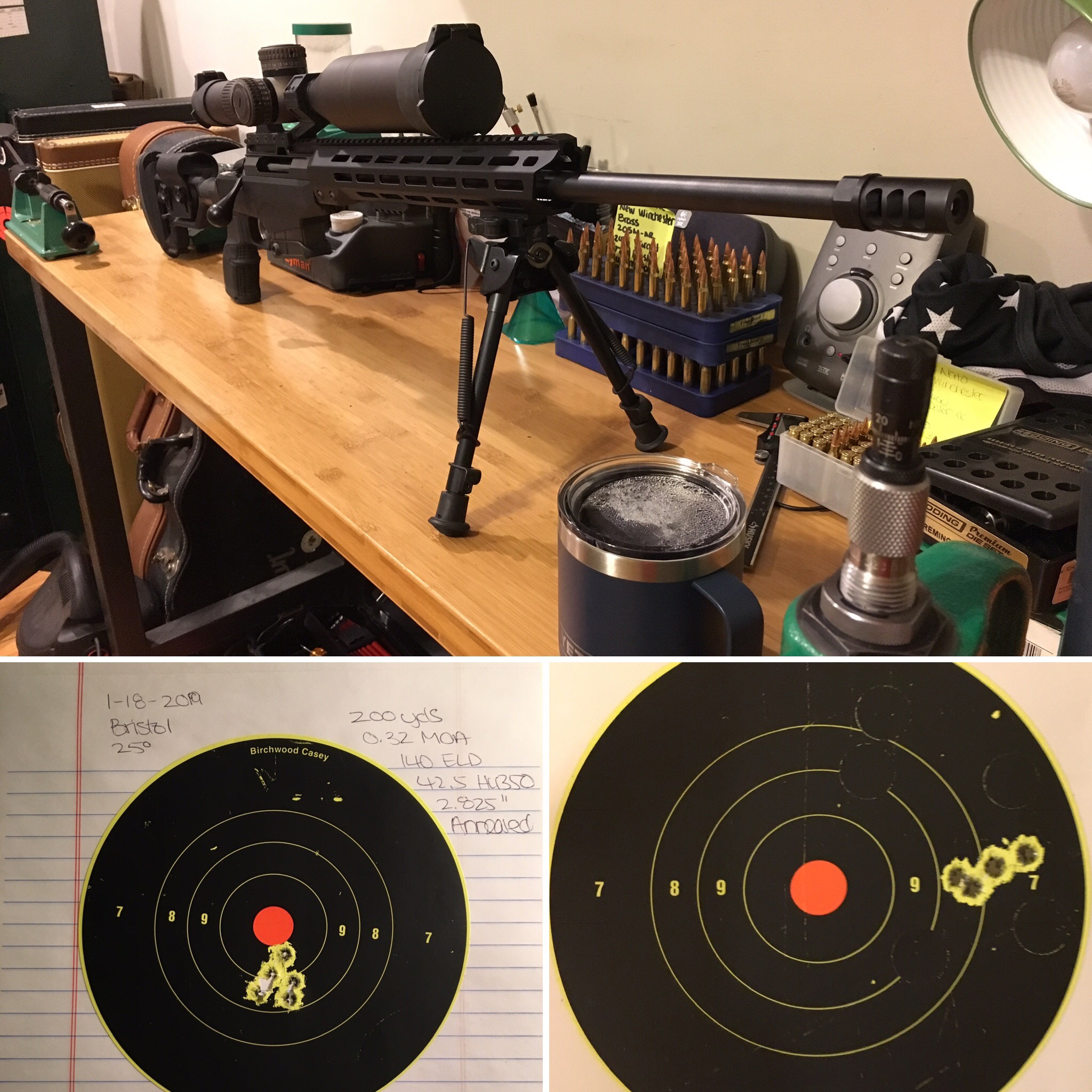

I've contemplated running my gas gun in a local match quite a bit. My local matches go to 600 yards so range is certainly well within the capabilities of all the rifles I own. My biggest issue is that my main match rifle is a Tikka Tac A1 that shoots 1/4 MOA from a bench all day. I've been competing with my Tikka all last year and did surprisingly better than I thought I would. The gas gun I have is a build I did that's a M5E1 in 308 Win with a Criterion 24-inch bull barrel. With my M5E1 I can shoot 3/4 MOA groups, BUT those groups are only when I'm absolutely on my best performance where as with my Tikka I shoot 1/2 MOA on a bad day.
My biggest concern is whether I should give up the razors edge accuracy that I have with my bolt gun for the speed of the gas gun. I'm thinking about starting the season with my bolt gun and depending on my performance switching to the gas gun for the later matches, but in the end it's all for fun as mentioned above. Below are some pictures of groups with both rifles.
The Tikka groups are shot at 200 and 300 yards. 300 yards is off center due to a 15-20 mph cross wind. The M5E1 groups pictured are both 100 yard groups.
