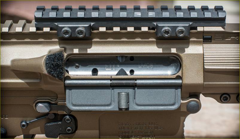

That's what I'm saying, the large frame AR's are large enough to put a standard non-cantilevered mount and not hit the handguard, the image below shows an ERA-TAC mount on top and the ARC M10 QD-L on bottom, neither went all the way to extend beyond the upper receivers top rail...

Using a rail riser is another option and allows for the use of regular rings. My preference is the Badger 22MOA riser as it is a little lighter and shorter - Height: 0.430″ Weight: 2.9 oz.
Here it is with ARC M10 low rings and a Premier LT 3-15x50 scope

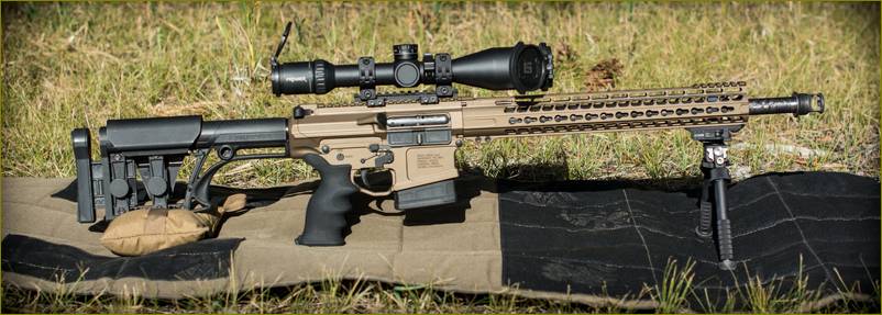

I recently put a 3-18 razor on my sig 716 and I definitely required a cantilever. Spuhr 4616 mounted as far forward as possible without touching the handguard worked out perfect for me, all my ar platforms have the ocular even with the charging handle.

What a great looking rifle!! I’m kinda jealous.
Thanks, that was my build from a post I did on the old scout site called "Journey to my lightweight AR-10" sadly all the info was lost when we transitioned back to the "real" Snipers Hide. Sadly I had to sell that rifle last year; however, it is my desire to build another long range large frame AR later this year or early next year :)

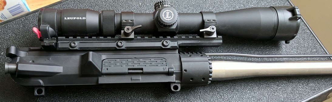

pririser.jpgThats how I do it with the PRI. The scope is a VX-R Patrol 3-9x40 with QRW 30mm low rings. The upper is an Aero Precision M5E1 with a Criterion 6.5 Creedmoor barrel, waiting on a handguard.
Also Strike industries dust cover, BCM Gunfighter charging handle (medium) and a Toolcraft BCG.
