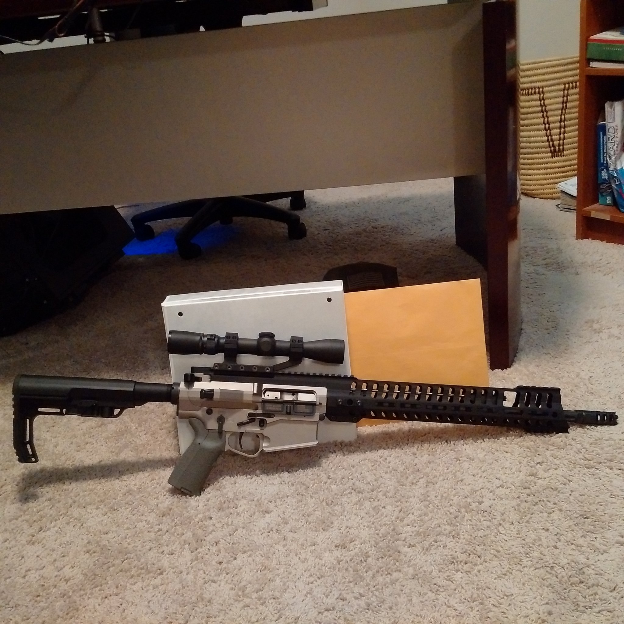

I just picked up my new POF edge gen4 Olde School DI P308 rifle from my ffl the other day and I have noticed some interesting things about the buffer/spring setup they use. I am looking towards tuning the rifle for minimal recoil impulse with factory ammo and milsurp non suppressed fire. So the first thing I did was to try to get a read on the buffer weight since I thought I would be ordering an H1 carbine buffer to reduce mass initially. Well Upon taking the buffer out I noted that its extremely light (they make use of the standard AR15 carbine buffer) probably the H0 weight (3 oz.) buffer which I must say surprised me. But it gets more interesting: POF apparently has set the rifles up using a rifle length buffer spring in their 7 position anti tilt buffer tubes for greater preload. And boy howdy does it have preload! I'm guessing its 20lbs or just a tad more just coming out of battery and it feels like 30 plus back fully withdrawn. Its almost like drawing a compound bow except that it stacks up seriously at full draw rather than the opposite. I had spoken to someone at POF and was told to run the gas block (dictator) wide open for normal ammunition. I checked and the rifle was apparently test fired in this gas setting. Now that bit of information has begun to make sense. I think its ridiculous for non suppressed fire to have this kind of spring pressure. I plan to replace it with a JP centerless ground polished carbine buffer spring and tune the gas block to run it. Then at some point I think I will replace the Brake with a flash hider for less blast. it will have more recoil but hopefully a soft impulse feel.

The POF site (support section) shows the applications for P308 carbine buffers in 2 distinct groupings: pre 2012 and Post say mid 2012. The pre 2012 buffer shows 6 position mil spec carbine buffer (I'm guessing 7" depth) utilizing a spring that is between 10.25-10.5 inches with 29-30 coils and using an AR10 carbine buffer 2.5" length (your guess as to weight). The post 2012 buffer utilizes a 7 position mil spec tube (I'm guessing 7 3/4" deep), an AR15 carbine buffer 3.25" length, unspecified weight. The spring specified is 12.5 -12.75" in length with 38-39 coils. I believe this is the configuration for my rifle and I believe they have set them up this way to by god work with any suppressor without any alterations other than adjusting the dictator gas block. I have no reason to believe the rifle needs all that spring tension and I'm going to purchase a carbine buffer spring, run the stock buffer and see how it goes. I have very little doubt she will run fine with the dictator gas block backed down to a 5 or 6 out of 10 (yes they are advertised as 9 but you may have a couple extra clicks). Why have adjustment built into an AGB on your rifle and have to run it wide open to cycle the action? Oh and by the way, it feels as though its close to coil binding at the end of the stroke. More to the point, POF has standardized that configuration in the piston driven rifles as well which may be even tougher to tame in suppressed fire. They probably took off the shelf components and adapted them to limit experimentation and R&D costs and to their credit responded to criticisms of poor functioning. I don't mind tweaking my own rifle since I have a good idea how these things work and I'm not going to go whining to the manufacturer if I don't get the desired results right off the bat. As long as you are staying with matched carbine parts in the buffer assembly you can't go that far wrong IMO.

Maybe I'm just new to the AR-10 platform - lol. It just doesn't seem copacetic to me to have all that force, and all that gas. I spose time will tell.

I totally get your point about the setting on the AGB being essentially the same as standard appropriate gas port size. That's why it bugs me, you should be able to run in the middle of the range and have adjustability either way otherwise its a waste. But I need to shoot this beast 1st. Its possible it runs well with far less gas and the test fire crew prefers the wide open position as an acid test for function. I could be getting out ahead of myself.

Yes, and I have tuned the buffers and gas systems on my .223 wylde rifles and a 6.5 grendel. I'm thinking that the stock buffer is probably as light as I would like to go. I'm a little surprised that POF puts this light a buffer in a rifle made to be fired suppressed but then they do give you a fully adjustable gas block. You really wouldn't believe the tension on the buffer spring though. if it won't cycle milsurp with less than an 8 or 9 setting I think that will tell the tale.

So, I headed out to the range and had a great time sighting the rifle in and doing some groups and so forth at 50yds. My suspicion about the excessive buffer spring tension was borne out and the rifle ran on position 8 and would still lock back on position 7 but its taking a huge amount of gas to run the action. I'm ordering a JP IMG_20180429_141234.jpgIMG_20180429_142520.jpgcarbine buffer spring and I'm going to replace this stock item and then play around with it. My goal is to have some kind of normal tension on the buffer spring and at the same time have the rifle run on say position 4 with milsurp ammo. As long as there is no problem stripping and feeding fresh rounds all should be well. The click adjustments on the dictator are somewhat coarse being something like a quarter turn each but the detent system is pretty neat and super easy to adjust with a flat blade screwdriver from the muzzle end. I'm thinking I may be able to get it adjusted really close to where I want with ejection and bolt lockback using the AGB and I can fine tune by adding mass to the buffer (H1,H2 or H3). Of course it may ultimately need a little less gas when the BCG breaks in but all that should be required is a click one way or the other. I was pleasantly surprised by recoil which was very minimal and the blast was not as ferocious as I had anticipated (of course I wouldn't stand over to the side of someone shooting it).

A matter of personal preference flyer. The buffer tension is stacking up at something between 25 and 30 lbs at full stroke. You obviously don't believe I know what I'm talking about or that my buffer spring is different from what you are familiar with. Enjoy your rig and I will enjoy mine. Please don't tell me I am inventing problems because I perceive an unusual condition. Thanks

Herodrh, I see what POF is up to, and it's actually pretty smart. They are using a lightweight (well light for standard AR10) buffer and a much heavier spring to keep the rifle weight down as much as possible, and from what it sounds they have it set up gas wise so you can still run a suppressor and not damage anything. Yeah, sounds like you could try a carbine spring if you wanted and that might change the recoil impulse a little, but if I had to add weight to the buffer to make it work, I personally would leave it the way it is........I personally hate adding weight to a gun, but that's just me. If you do try it, I recommend starting with the gas system completely shut off or maybe one click open.

That sounds totally reasonable and thats what I intend to do. In addition to being difficult to charge the rifle, running so much spring tension while firing normally is that you get one heck of a blast of gas in the face each shot. Its normal to have gas venting with any AR but why vent more gas than you need to run the gun? With standard AR10 parts I can't really go that far wrong. Even though its a POF, its still a DI AR10 - lol. Yep I get what POF is trying to do to keep everybody happy and not get blasted with you know what when one of us throws a can on our north of $2K rifle and it won't run. They want everybody to come up smiling from their experience with no more than a little tweaking of the dictator gas block! I can't wait to try the new spring and see what setting it likes to run on. Provided that feeding and chambering is robust I think all will be well. Let you know what kind of results I come up with.
So to update my previous posts, I have changed a few parts on the rifle and done some evaluation. First of all I did not invent a problem here and when I swapped the buffer spring to a JP carbine buffer spring 11.75" length with +5 % spring rate (centerless ground, polished spring - not SCS) I found the buffer tension nearly halved and without the dramatic stacking at full withdrawal. I additionally took apart the buffer to investigate the weight setup from the factory. I found 3 (I believe) tungsten weights which I then swapped for 2 steel and a single tungsten weight. I think this reduced the weight from approximately 4.7 oz. to 3.8 oz.(H2 to H1). I thought about going to all 3 weights in steel but JP actually recommends this weight for LMOS operation in the AR-10 platform. Went out to the range to test out this configuration and was rewarded with smooth operation at a gas setting of 4 on the dictator gas block with flawless feeding, bolt lock back and no excessive gas in the face at each shot. Fired some more targets at 50yds and accuracy was undiminished from previous session with factory configuration. Actually accuracy was somewhat better which I think is reflecting swapping in a JP EZ trigger (4.0 lb, red spring) that I had sitting on my shelf from the factory POF 4.5# drop in. I had removed the trigger from another JP lower and it had been professionally adjusted/installed. Fortunately the settings for the disconnector and overtravel were spot on with the P308 billet lower so I didn't have to break the loctite 263 on the adjustment setscrews. This trigger actually works so well that I am questioning whether I will go to a geissele in the near future. My conclusion is that !. this is an amazing rifle and I can't wait to take it out to longer ranges, 2. the factory setup is totally biased with suppressed fire in mind and any owner is free to tailor their rifle for non suppressed fire to alleviate the ridiculous amount of gas they would have to eat in addition to excessive amount of secondary recoil impulse (necessary to compress the monster buffer spring) and finally 3. the standard equipment/configuration recipe for the AR-10 variants from the industry standards can pretty much be relied on without ascribing magical qualities to a manufacturer's product's (that actually are AR-10, DI rifles or carbines). The addition of the dictator adjustable gas block on the rifle gives owners the ability to fine tune further to make up for any other equipment or load compatibility issues.
I did fail to take your advice KYAggie in that I throttled back to an initial test position of 3 since I was pretty confident I would not over gass my buffer/spring combo and I found that setting was too little to completely cycle the action. The 4th position cycled and locked back consistently which tells me that the adjustments (quarter turn per detent click) are kind of coarse. Still not going to complain too much since it gives a good range of adjustment and so dead ez to change with a flick of a screwdriver with repeatability. I was also pleasantly surprised to find that the blast from the 16" barreled and comped .308 was not as ferocious as I was lead to believe. Full disclosure though I always shoot with plugs and muffs as many of my other rifles are also compensated (not to mention all the comps, magnums and field pieces being fired at my range - lol). I don't intend to bother complaining to the manufacturer or my retailer since all you will hear in reply is boilerplate. I don't really blame them since I'm sure they have taken a ton of crap from owners whose rifles wouldn't run perfectly shooting steel cased ammo suppressed. And I expect there is a pretty fair segment of POF owners who run their P308 carbine's as well as SBR P308's suppressed.

Glad to see you got it running smoother; less mass in the buffer and bolt along with a more normal spring should make for a nice shooting rifle with the AGB. I love the way my 6.5 CM performs, unbelievable light recoil. The only requirement to tuning this way is that the tuner understand how the gas system works so as to not damage anything; something you obviously understand.

Yep it felt good to get it running on a normalized configuration. I have learned quite a bit about the AR operating system and it's balance shooting my JP's. I actually have an 18" medium contour JP-15 6.5 Grendel rifle with LMOS BCG and buffer that almost doesn't move during firing. Of course the 123 grain Hornady Black doesn't carry Quite the smackem as the Creed but man is it fun to shoot
