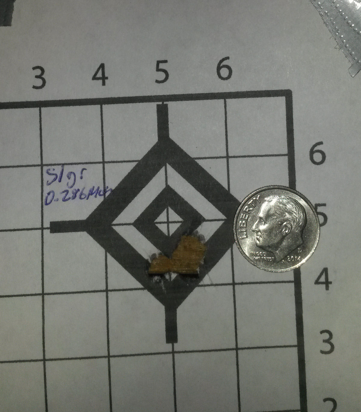

Loaded up a few 147's today behind my load for 140 AMAX using IMR 4451
140 AMAX
Mv avg =2868
ES= 14
​​​​SD= 5.8
0.020 off lands
147 ELD-M
mv avg = 2848
ES = 9
SD= 4.7
0.040 off lands
I literally used same charge weight from 140 AMAX load and did not touch seating die. The ogive difference between 140 and 147 is what accounts for 140 being 0.020 off lands and 147 0.040
I'll take these results!!
1:8 twist 26 inch barrel

What kinda of groups were you getting with the 140 amaxs? Im wondering if i should bump up my charge of varget (currently 2775fps ~.5 moa at 300)
Longshot85
Incognito
Belligerents
Jan 19, 2011
121
38
34
34
#53
0.3-0.4 moa at 100 yards that was nearly all horizontal .......i was at a public range and had a .30-06 blasting on one side and machine guns on the other......also been a little bit since I've shot for tight groups like that so I think it can tighten up a little more
I'll host the pics later then post them up
I bet 147 seated 0.020 vs 0.040 will tighten it up too

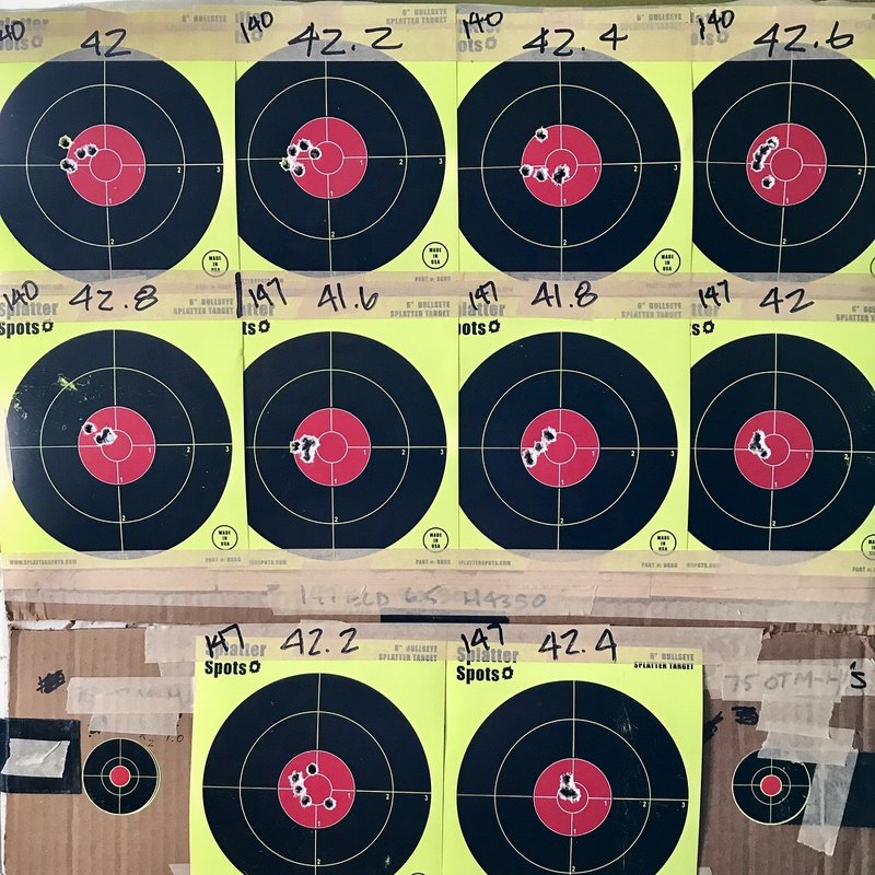

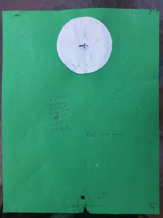

New guy here. Just tested some 147 ELD-M loads that show a lot of promise.
Here's my setup:
RPR
VORTEX Razor Gen II 4.5-27 EBR MIL
H4350
New Lapua brass
CCI 450 Primers
Seated .020 off the lands
OGIVE 2.244
Lee deluxe dies
Whidden micrometer seater
FL resized with Hornady unique case lube (light coating inside of the necks too)
Brass trimmed with Lee trimmer
RCBS RC press
Results:
41.6 Avg FPS 2649 SD 6 ES 15 MOA .44
41.8 Avg FPS 2655 SD 6.4 ES 16 MOA .83
42.0 Avg FPS 2676 SD 10.9 ES 23 MOA .43
42.2 Avg FPS 2685 SD 6 ES 13 MOA 1.0
42.4 Avg FPS 2696 SD 5.3 ES 13 MOA .42
No pressure signs. This is the best my RPR has ever shot. I think I'm sticking with the 147’s for now.

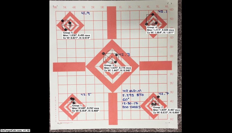

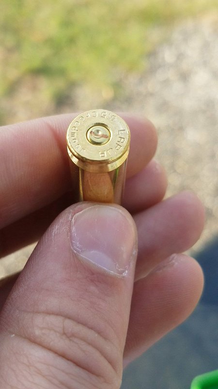

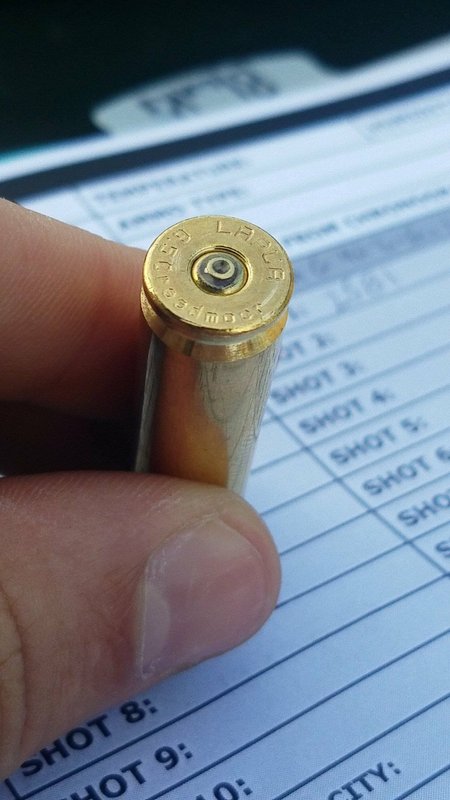

New guy here... new to the forum, new to long range bolt, new to reloading rifle. So forgive my ignorance, but I feel that my numbers are different enough for me to ask questions.
I just finished a ladder test with the 147 ELDMs. Hornady rated 40.3gr of H4350 as the safest powder weight and estimated a velocity of 2600fps. I took my ladder test up to 42.0gr and saw 2700fps but 42gr seemed high to me. I was starting to see that the primers were starting to extrude out around my firing pin. Are you guys really taking it up to 43.2? How do you know that's safe and not hard on your equipment?
Say I completely ignore what I read on the forums and only worry about my own findings from my ladder test. I'm getting the following numbers for my best load. My curiosity is whether or not I will see a huge difference in momentum at 1500yd between 1.5gr of powder that my rifle likes vs what you guys load?
H-147gr ELD-M
H4350 - 40.8gr
AVG - 2609fps
ES - 7
SD - 3
Jump: .040 off lands
Group: 0.5in
TL;DR ----- Is it worth pushing my ladder test up another 1.5gr or so to see if there is a benefit in my rifle?

Are you getting any ejector swipe on your brass ? You need to look very closely in several light conditions to make sure you're not overlooking it
With those primer signs just know it may be a little harder on the brass and may expand the primer pocket more and you might not get as many reloads on them
I am runnng 42.7 grains of IMR 4451 going about 2858fps and getting some hot signs but I'm ok with it since I'm more focused on really stretching the distance

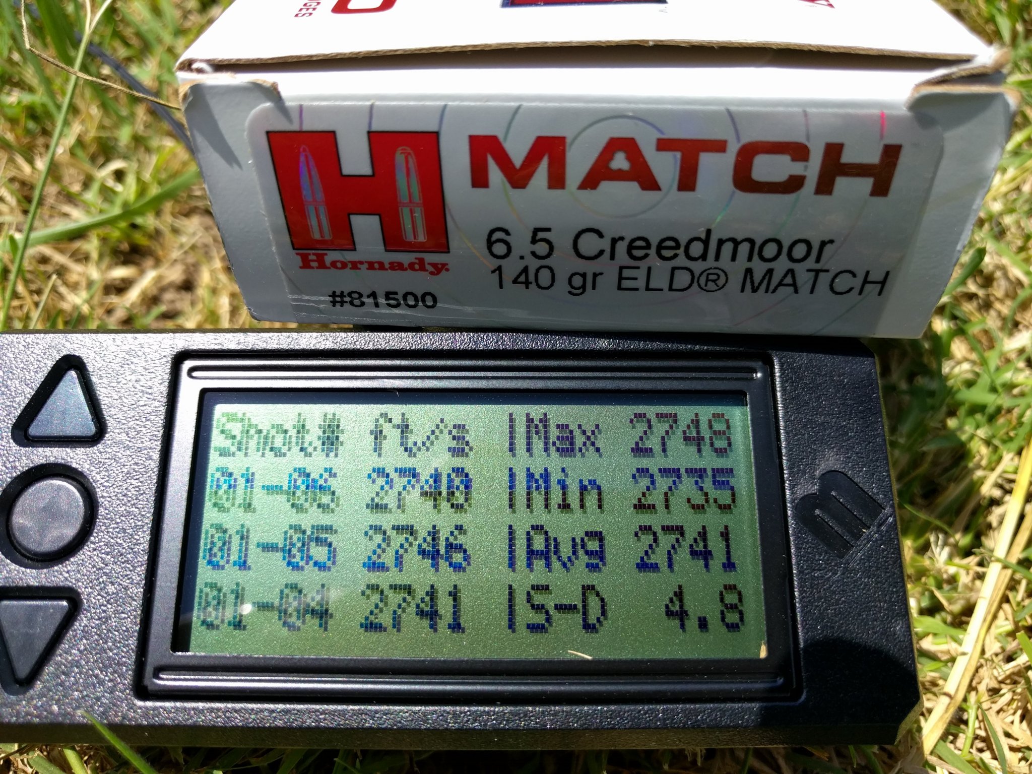

I recently purchased a Savage 12 LRP 6.5 Creedmoor. I purchased 200 rounds of Hornady 140 grain ELD Match factory ammunition. I shot about 160 rounds over a couple of trips to the range, the rifle and the ammunition are better than I am. I purchased an additional 200 rounds of 147 grain ELD Match factory ammunition and headed back out. I shot about 40 rounds of the 140 grain ammunition without issue. I changed over to the 147 grain ammunition and the very first round hit the target sideways about 10 inches low and to the left at 100 meters. Out of the next 39 rounds, one missed the target completely, and I had two more hit sideways. I have a BullsEye Target Cam and I have shot by shot pictures of this session. I called Hornady, and at their request I and sent all the remaining ammo and spent brass back to them. (Hornady has been jacking me around and after two months, they still haven't sent me my replacement ammunition)
I shot the remainder of the 140 grain ELD Match factory ammunition and about 150 rounds of 140 grain ELD Match 40 grains of IMR 4350 reloads without issue.
Has anyone had any issue with the 147 Grain ELD Match bullets or factory ammunition.

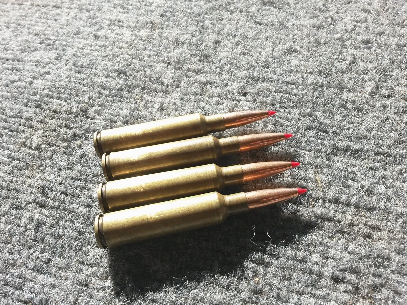

The primer with the brown line is only 39.3gr. The primer with the black dot is 41.4gr.

#79
I'll let others weigh in as well but it looks like you have some ejector swipe going on in between
pic1 "r and A"
Pic 2 "6 and L"

Well I finally broke down and bought a gazillion (okay, 2K) of the 147's. Did some initial OCW load development last Saturday. Group 1 looked promising with a 0.262 MOA group at 200 yards. I stretched it's legs out on Sunday out to 1K. Wind performance was good, but elevation performance was seriously lacking. It took 8.1 MILS to reach 1K. Not very impressed with that performance. I'm going to try to find the next highest node and see if it gets any better.

Was out today testing the Hornady 6.5 Creedmoor 147 ELD factory load today in the 28 degree sunny NC day. Shot it to 650 yards and it was all under 1/2MOA at 450, 550 and 650. Below is 5 at 650 yards. I shot the three on the bottom and was seeing no new splash so I held a little higher and shot the next two. Using the dollar it looks like about a 2.5" group. Can't complain about that with factory ammo. Velocity was about 2720fps from the lot I have in my 27" barrel. My handload with H4350 is at 2820fps and shoots similar.

I finally got a load settled down at a higher node, works out to 2804 fps, it shot just a touch over 0.3 MOA at 200 yards. Took it to our February match, it shot lights out all day long, good enough for a Top 5 finish. I think I'll keep 'em.
