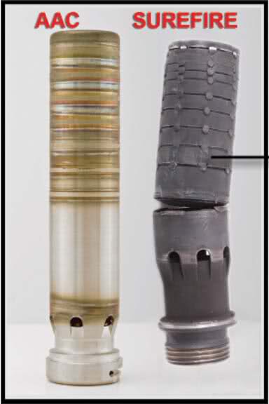

Would this picture I saw today represent the quality of the titanium welds that Q is currently shipping? It was posted over a year ago, so I wasn't sure if it was a prototype, but it's the only photo I could find that showed bare welds. The recent thread about titanium weld color quality has made me a bit concerned about this.

That's why TBAC and SilencerCo (one material suppressors like the Saker and Omega #K), along with Area 419, will continue to get my business.
The Qs have a conical shape to their exit hole, and if the EDM bore cuts into that, makes it asymmetrical.
Just like you don't want the crown of your barrel to have imperfections, I suspect that this would also have a negative effect on accuracy.
TBAC silencers are great and some of my favorites available. But, if you weld and don't EDM the bores relative to the mount, it's never as straight as it could be.
straighter on the bore and body than others I've tested. Even the EDM ones with the exit hole intact unlike others. When built right EDM is not needed.
Their comments do not reflect the results of NASA's testing and studies...
We build the the strongest Titanium silencers available...that's why we don't have to use outer tubes to hold the silencers together. #no338recallforQ
Pretty straight for a 9" can
You never have to EDM, but it's always straighter if you do. It gives the user better dispersion and less zero-shirt. If you state otherwise, you are being dishonest.
TBAC silencers are better than average, but they could be much better. You paint, use an outer tube, use 90 degree shoulders, you don't EDM, you use 1.5" diameter, you shim your muzzle brakes, etc. Those are ALL things that if improved will provide a better product for your valued customer. It's just fact. Change my mind...
Q offer the best precision rife silencers in the world. 100%
Kevin, can you please explicitly address the picture shown above with welds showing high levels of oxidation?
1. Are those welds representative of your current product?
2. Do you disagree with the statement that oxidation in titanium welds CAN have a negative impact on the integrity of the weld?
Thanks.
Looks like ONE weld is okay...
