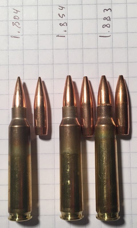

Well I got some of the blem 70gr RDF's in today. Seated a dummy round to max mag length (2.260). Compared this to the 75gr hornady HPBT and 77gr Sierra Matchking seated at the same OAL. Written above each round is the cbto for each.
L-R 70gr RDF, 75gr hornady hpbt, 77gr SMK.
