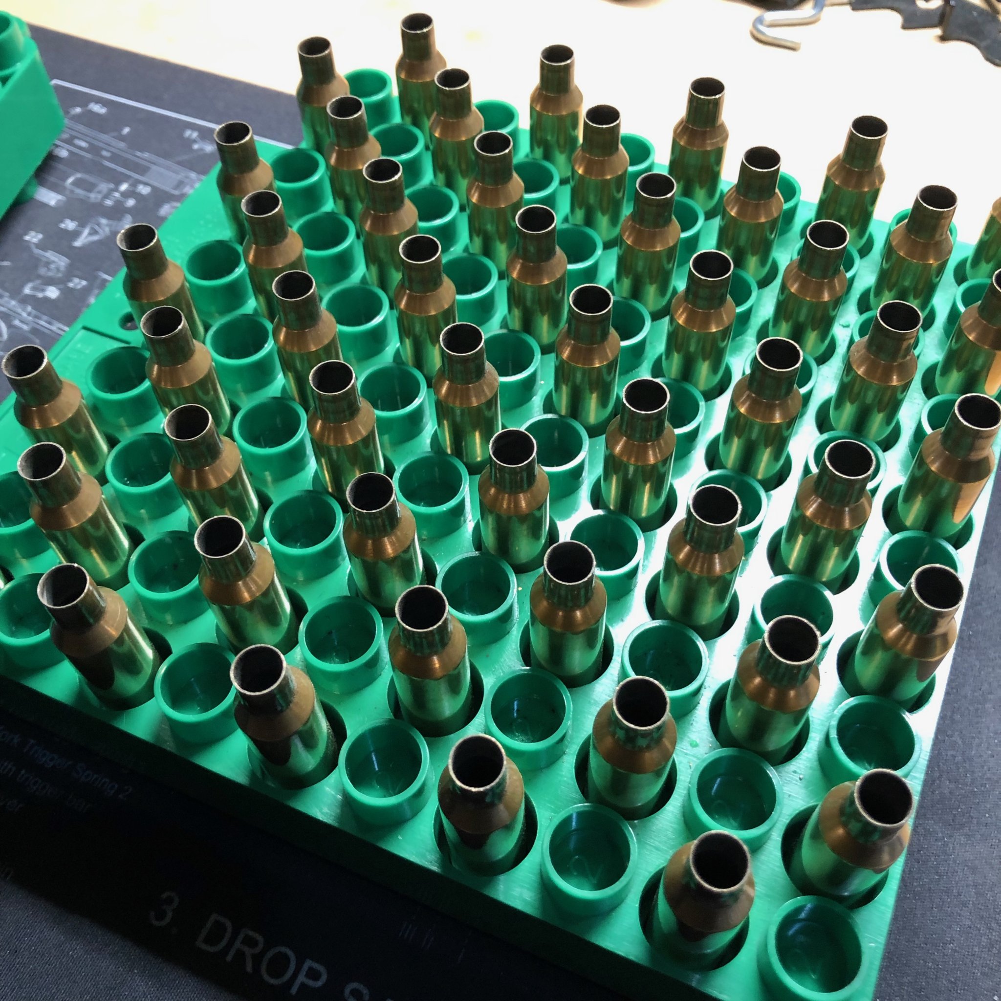

Just thought I'd post an update on this self-caused problem. After annealing 150 pieces of brass with the socket on a driver held in a torch method, my SDs opened up and I determined it to be due to very perceivable inconsistencies in neck tension.
That said, my Annealeez arrived, I re-annealed the brass and ran it through neck sizing using a .288 bushing which was .001 tighter that the previous bushing. The first firing of a lot of 50 was better SD, the second firing produced even better SD and back inline with single digit SDs I generally produce.
Observations:
- Consistency in brass is as important as consistency in charge weight or bullet seating.
- Messing with all of the cool bench rest tricks for maintaining necks does not seem necessary for maintaining brass within the needs of a PRS shooter.
- In talking to several people who shoot high volume PRS matches. A couple of them explained the value of annealing for keeping the neck and shoulder springy enough to relieve firing pressure from the primer pockets, thus extending brass life.
- I plan to anneal after every firing and a machine like the Annealeez appears adequate maintain consistency and is simple enough to support frequent use.

Thought I'd post this followup for the sake of the group. The batch of Nosler brass that I thought I effed up annealing with socket driver and torch annealing is all prepped for it's eight loading. I'm now annealing every firing, bumping shoulders by .002", using a .288 neck bushing, and pulling a carbide ball through the neck. This seems to produce very consistent neck tensions reliable single-digit SDs with minimal effort. This seems to be minimum effort and maximum return.
