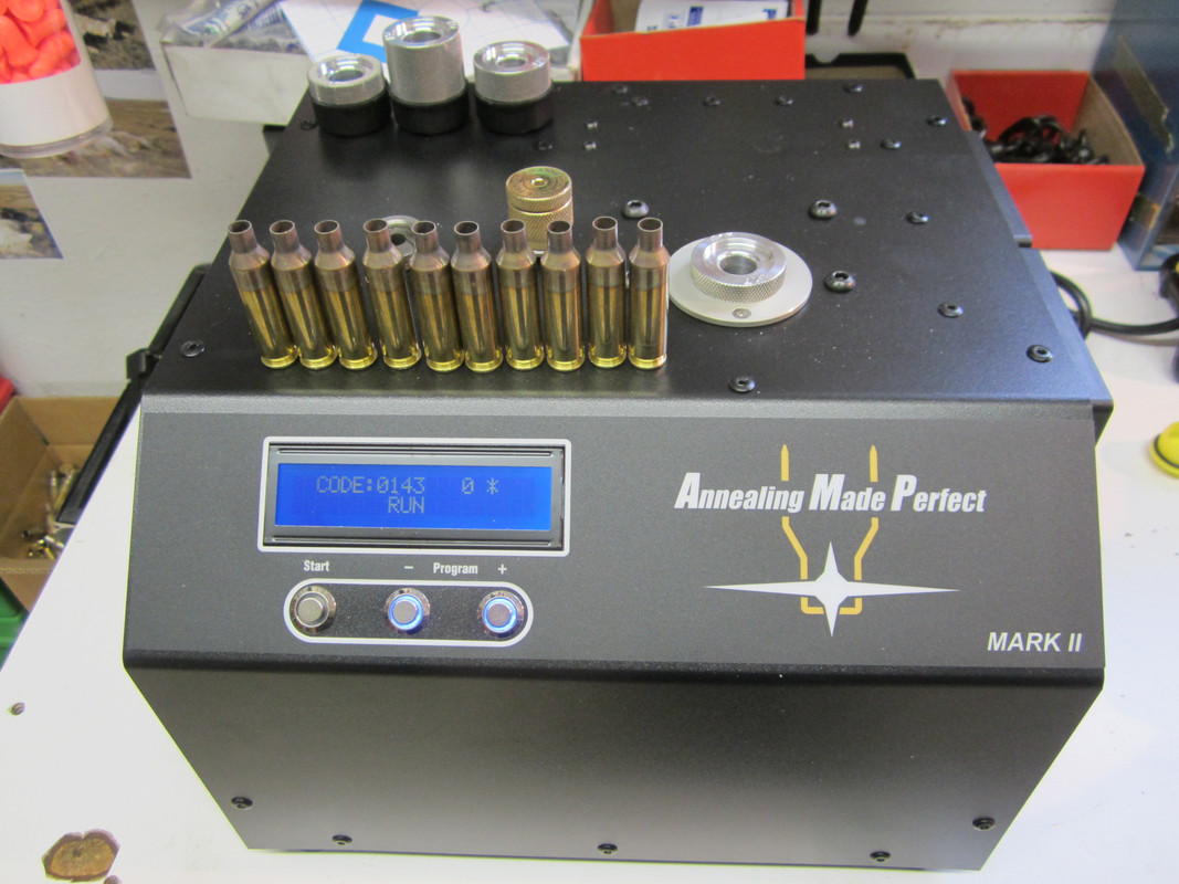

If I may tag on to this, what annealer do most of you like or recommend?

Anneal after every firing in Aztec mode. Before Aztec, presets. My annealing workflow is after SS tumbling.
Btw, I’ve done some testing in the past.On .308, took 5 times fired non annealed case. And 5 times fired annealed after each one. Non turned necks on cases. After seating non annealed cases had runout of .004-.006. Annealed ones .0002-.0015. Though, this was just experimental. And doesn’t prove anything about annealing improving in seating.

I've got the EZ Anneal induction annealer and it is so quick simple to anneal that I do it after every firing. If I was annealing some other way I'm not sure I would.
