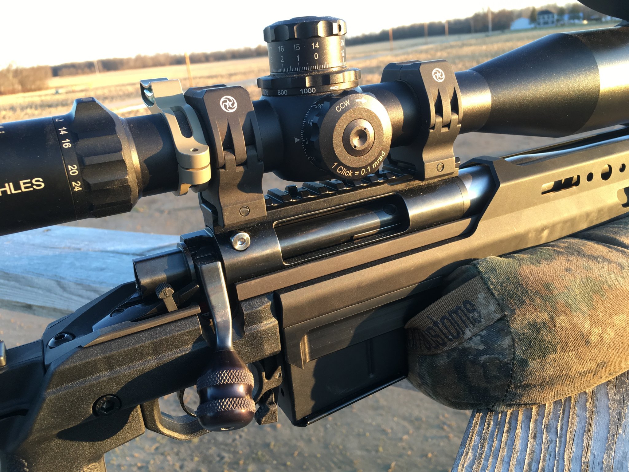

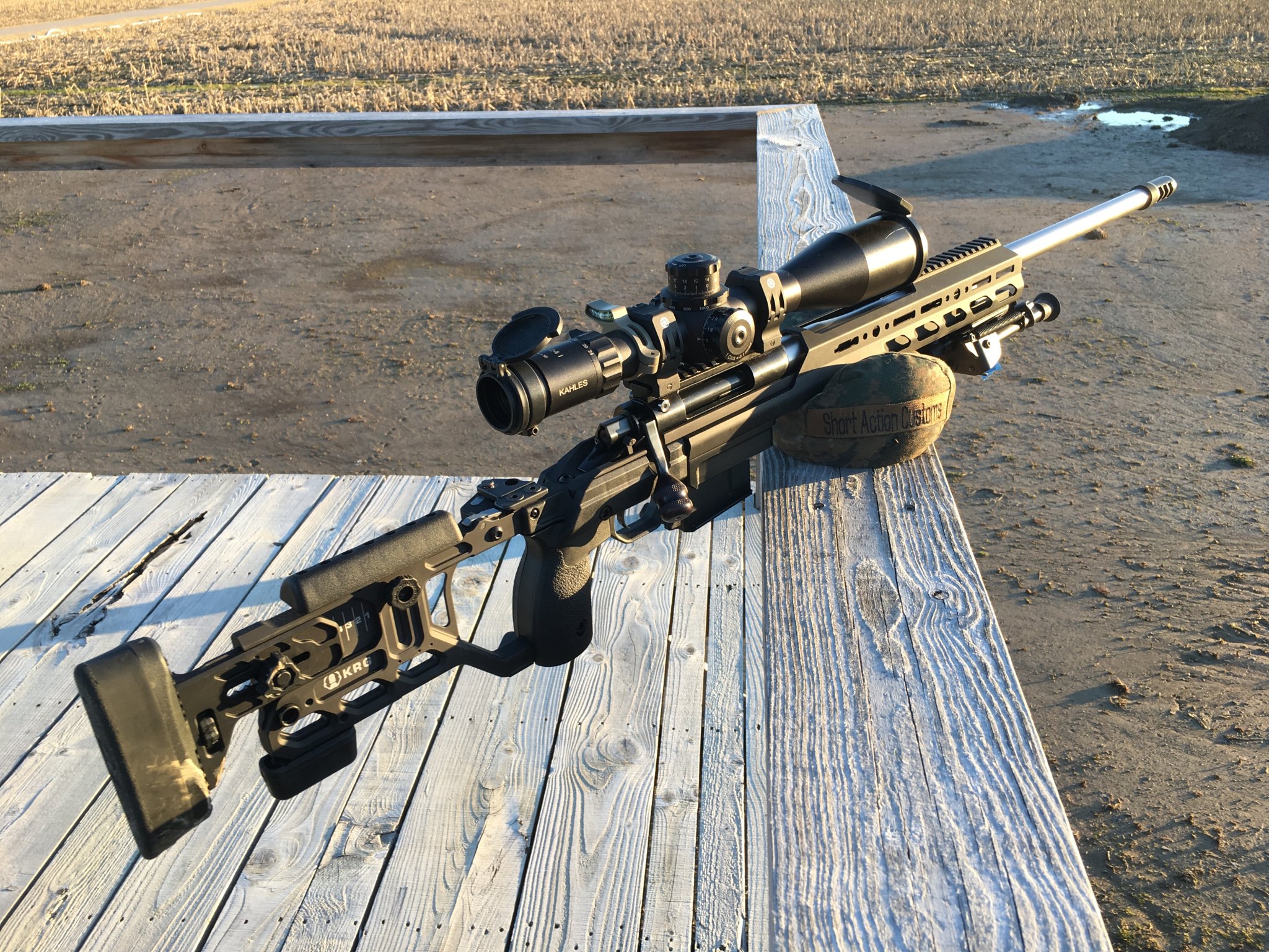

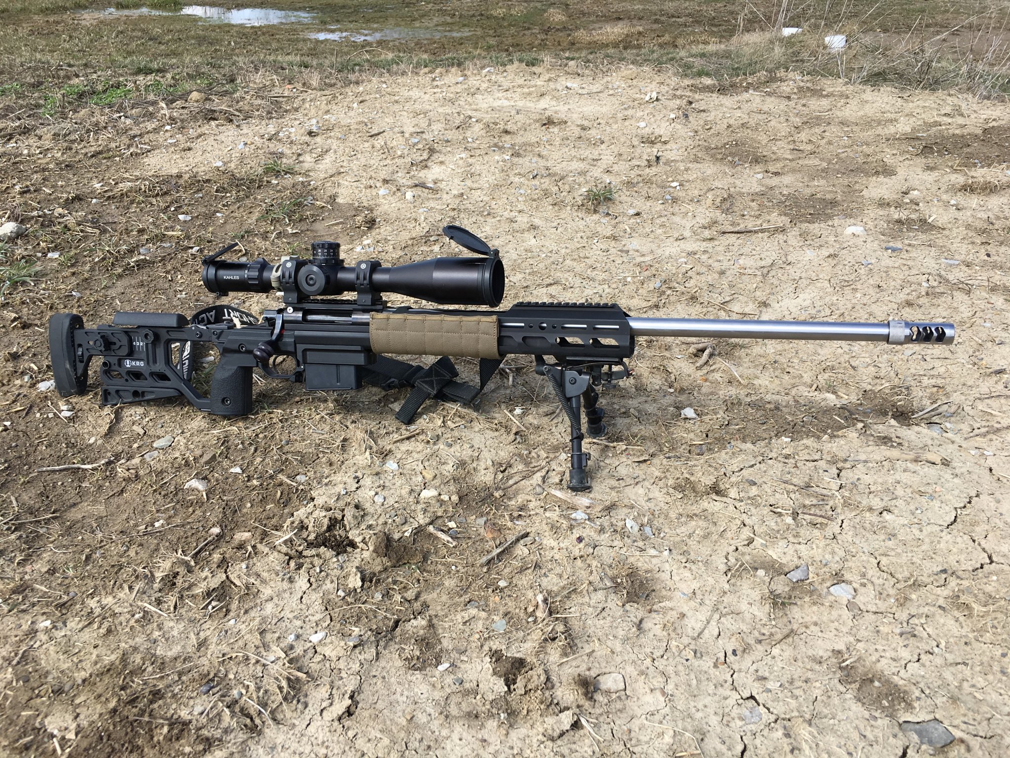

This is Mark from Short Action Customs. I have not been on much just because we have been extremely busy, we moved into a new building and life is busy in general. I wanted to post up about the American Rifle Company "Nucleus" action. We have had one in our shop for about a month now and I wanted to share some detailed pictures and thoughts on it so far. Instead of repeating what is already available, I will post a link to American Rifle Company's website with the information for the Nucleus and I will just give my thoughts on what I like and dont like.
**** UPDATE****
With this prototype action, I took full liberty to do whatever I wanted to with this Nucleus knowing that it will not be in the hands of the public. I did sweep back the bolt handle and American Rifle Company does not warranty the action if that service is done. Since this is not a customers rifle, just a prototype for testing, I modified it.
Yes I like the handle being swept back. I have always shot Rem 700's, Defiance Deviants and PTG bolts with swept back handles, so it is my preference. The biggest change that I felt made the bolt manipulation feel better was the Area 419 bolt knob. I have also run the American Precision Arms bolt knob and it felt great too.
American Rifle Company Nucleus Action
Pro's.

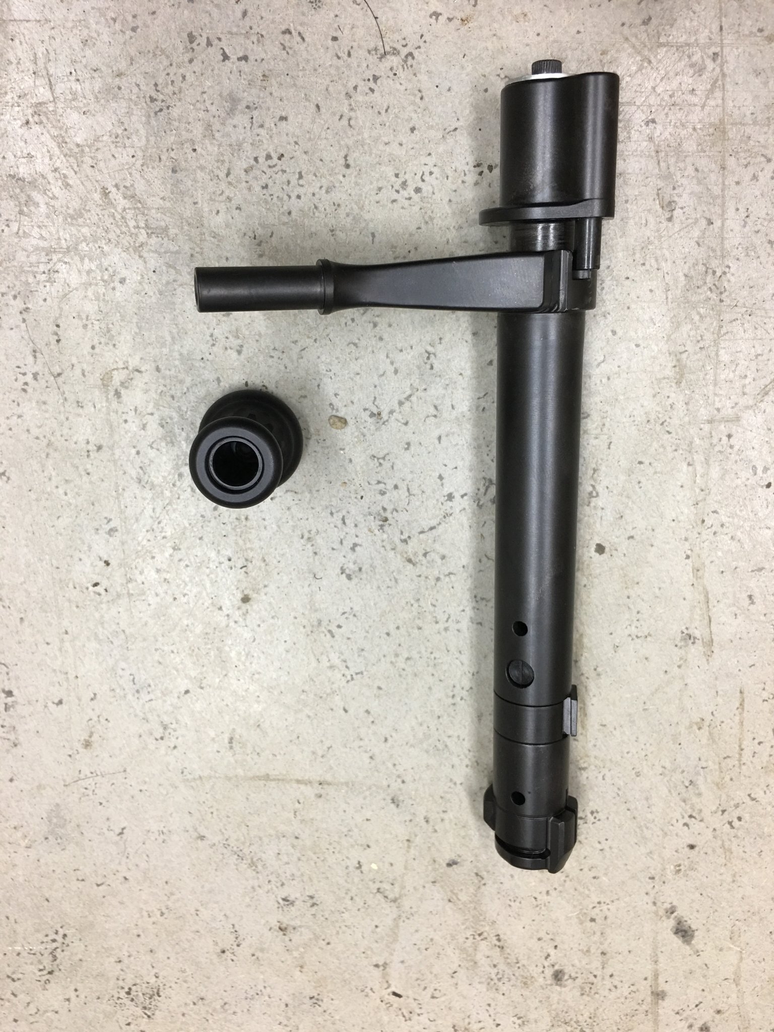

-Controlled round feed works great, have not had one failure to load, extract or eject
-The bolt lift is super smooth, dual cocking cams works great
-Heavier firing pin for more consistent ignition
-Bomb proof bolt stop
-Removable bolt heads for multi-caliber applications
-Salt Bath Nitride finish is very smooth and the bolt feels like it is on roller bearings
-Rifle has been super accurate, a testament to the ignition system and execution of threads, lugs and action face
-A lot of value for $1000
Con's.
-Shipping date is still not determined
-A lot of moving parts in the bolt
-Like any mechanical eject action, the bolt needs to be run with a certain amount of velocity for proper ejection
-Another action wrench which is not even manufactured yet will be required for conventional barrel changes
-Bolt knob is still undetermined, current knob is not for everyone
Overall, I have really enjoyed the action. The one in our shop is just a prototype. We had to relieve a little material on the back of the bolt for clearance with the action. I believe the ejection port needs to be lengthened to the rear to aid in getting the brass out of the ejection port and the bolt knob that was on it from SHOT show was horrible at best. I ended up taking an Area 419 bolt knob, bored out the 5/16 x 24 threads and drilled and tapped the knob to work with the Nucleus action. I also heated up and swept back the bolt handle. After doing this, the action felt better to me. The bolt ran very smoothly and your hand has so much clearance with the optic.
So what are the big differences with the Mausingfield and the Nucleus and why is the Mausingfield $600 more than the Nucleus?
Answer: The Mausingfield has more complex geometry with the integral lug, there is more raw material required to build it. The extractor on the Mausingfield is larger and has more going on with it than the Nucleus. The DLC Coating is a lot more expensive than Salt Bath Nitriding. Salt Bath Nitriding is not currently available on the Mausingfield due to the current material and heat treat specifications.
So which is the better action?
Answer: It depends on which features are more important to you the shooter. Do you insist on an integral recoil lug? Do you insist on a conventional, large claw, Mauser style extractor? The Nucleus is going to be hard to beat due to the cost, features of the 3 lug/72 degree bolt lift, dual cocking cams, and Salt Bath Nitride finish. They are both great actions and I'm currently shooting 2 Mausingfields. One is a 6mm Creedmoor and the other is a 6.5 PRC / 223 Switch barrel and I really like them. I have swept back the handles on both of them and am running different bolt knobs.
Let me know if you have any questions or want more specific information. I tried to keep this short and sweet.

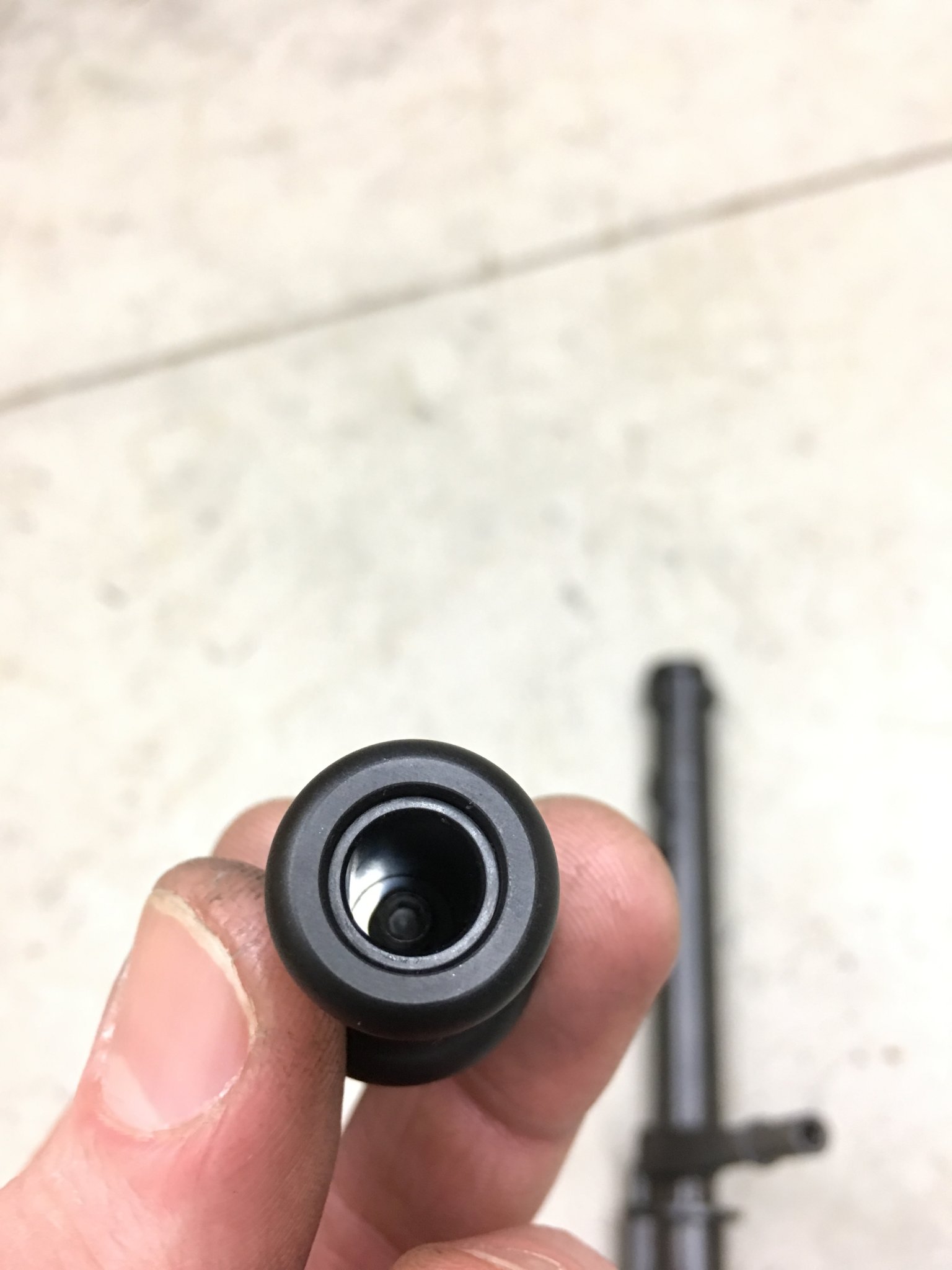

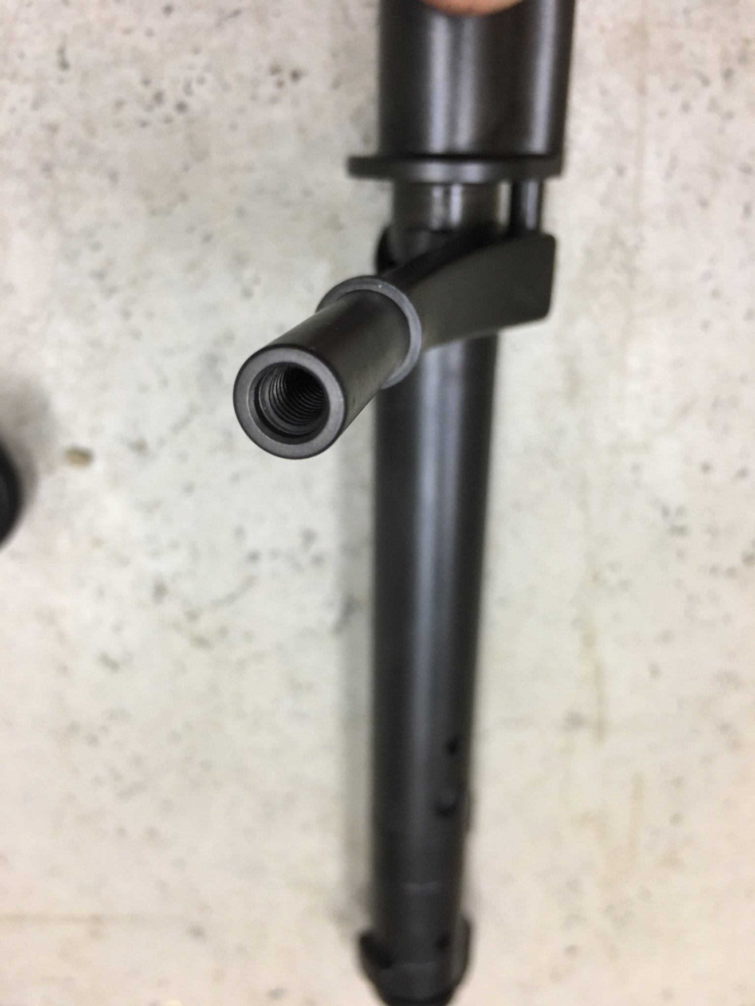

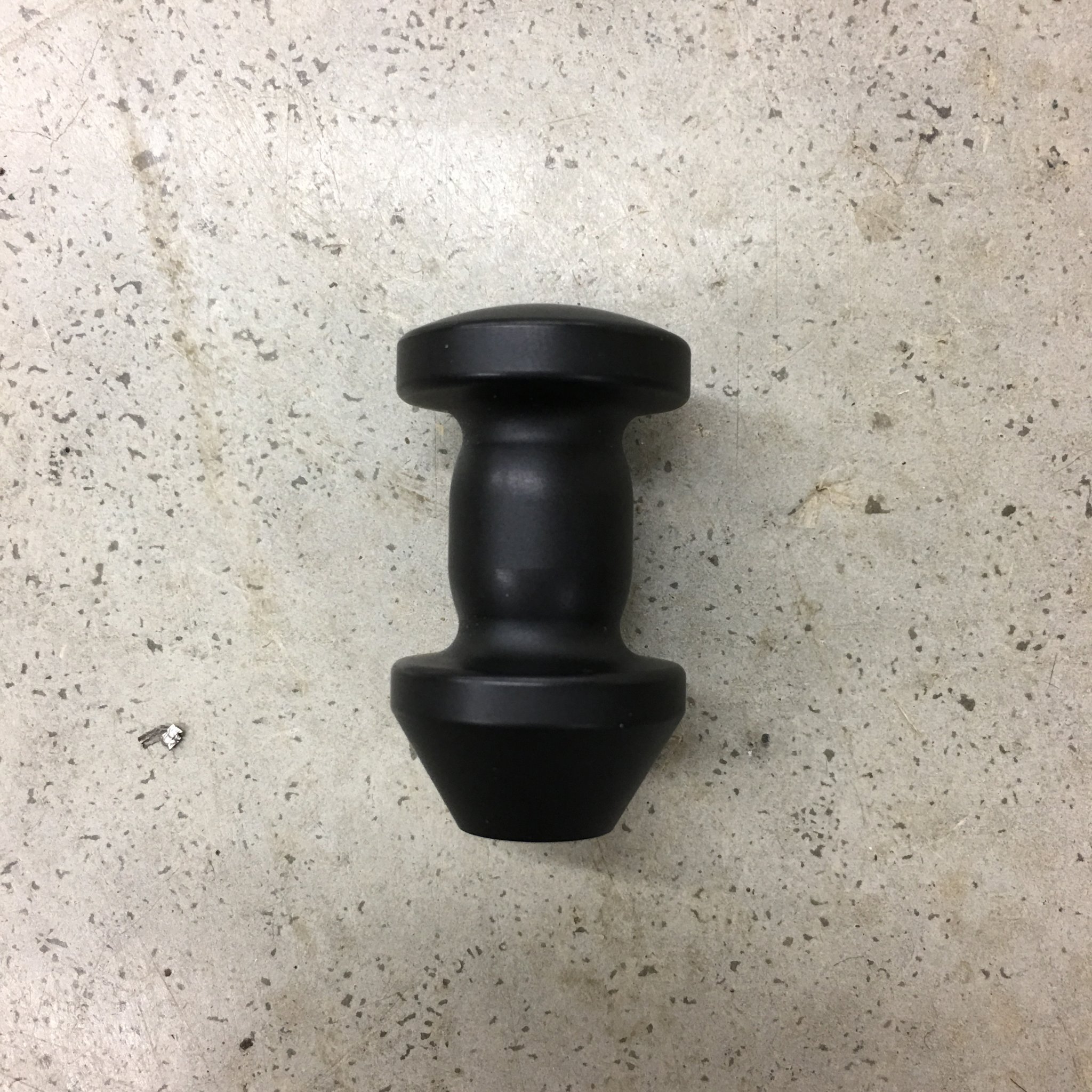

Thank you for the review. But just to confirm with the bolt knob con, doesn’t the nucleus have the ability to swap out bolt knobs with aftermarket knobs? I thought it was just a threaded bolt handle. If that’s the case, that is just a user preference thing.
Likes: Mgordon
Oct 6, 2010
663
152
43
Southern Dakota
#16
There are female threads on the bolt. With male threads recessed into the knob, just as SAC described they made "custom." There is at least one aftermarket knob offering, but no where near the amount of say the typical R700 Badger and similar types.

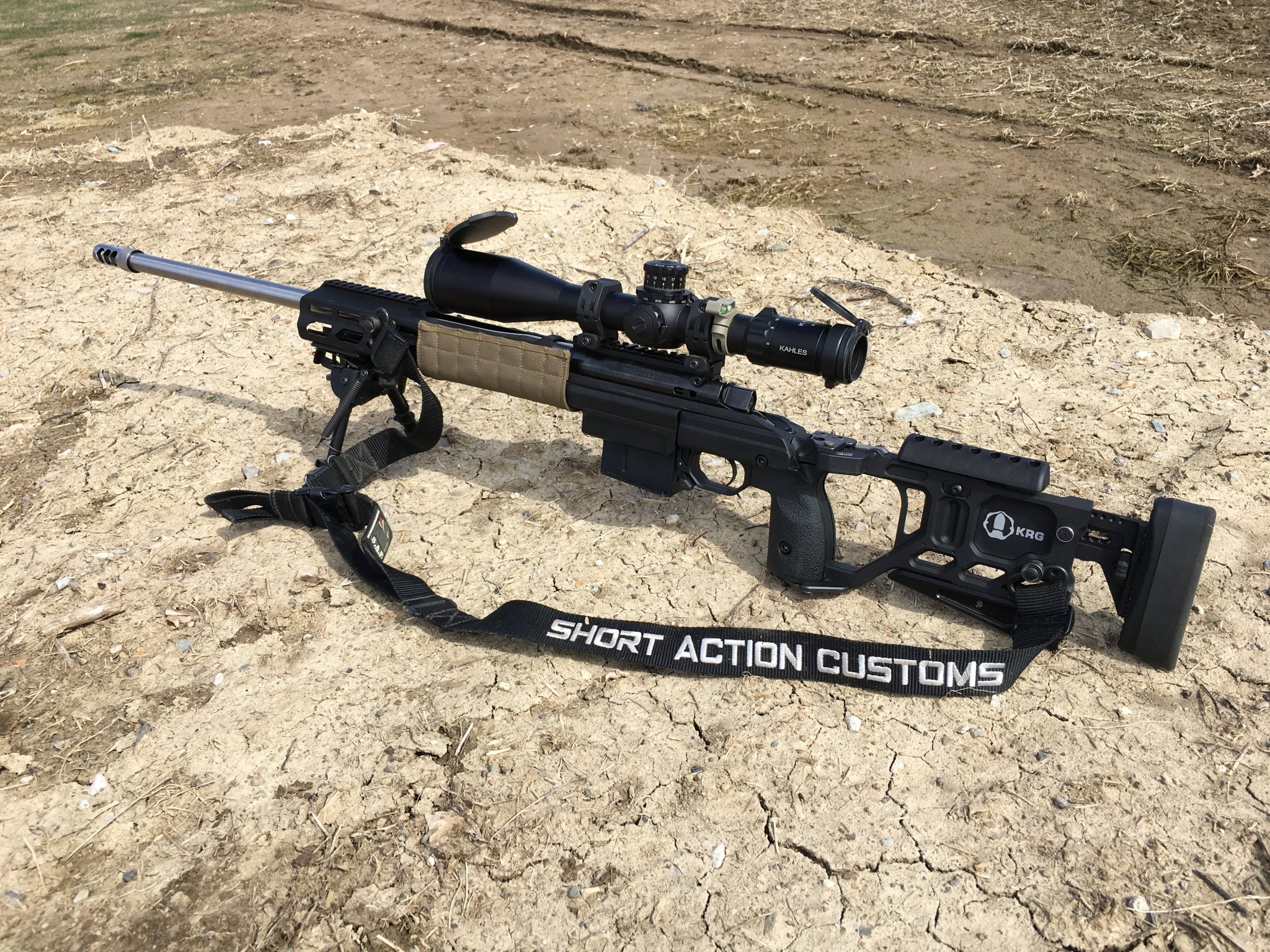

Nice wright up and nice pictures. How did the rifle shoot for you? What caliber did you try it in?
I'm shooting it in a 6x47 Lapua right now. Shooting the 115 DTAC's at 3030-3040 FPS. It has been hammering! I took it to a local match this last weekend and placed 6th with it. Have not shot a match in a while or really practiced. The rifle performed perfectly!
The handles have a unthreaded O.D. of .3125" and a 10/32 thread internally. The Bolt knob's I.D. matches the .3125" closely but has a 10/32 threaded stud on the inside.
You can modify most common knobs by drilling or boring out the internal thread of the bolt knob to .313"-.316" and inserting a threaded stud to the inside, or doing a through hole and securing the knob that way.

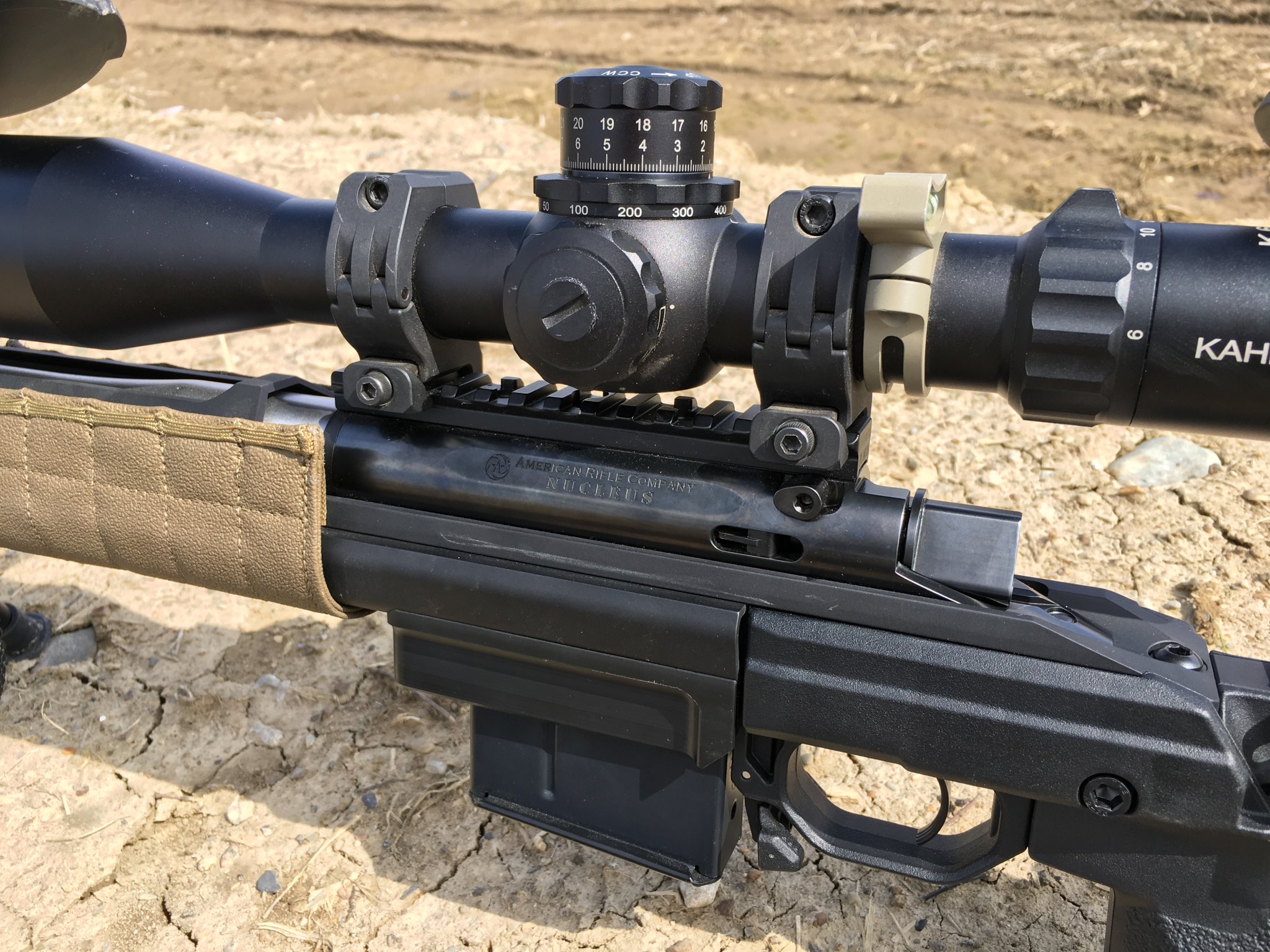

So by saying that the ejection port needs to be lengthened, I hope your not implying we will have to worry about the occasional brass contacting the receiver on ejection and falling back into the action .. I am excited about this action and that would be a complete buzz kill.. I can't wait to start hearing reviews from other fellow hide members when they receive them.. I will also have to agree that the swept handle would be a nice touch..
I believe the production model will have a longer ejection port in the rear. Again, this was 1 of probably 3 prototypes and was executed in an extremely short period to meet the SHOT show dead line. I'm sure there will not be any issues with ejection on the production model. The Nucleus in my shop is ejecting just fine and has not had any failures to eject, it could be a little bit longer however.

Which bolt handle did the Nucleus come with that you were not a fan of? Was it the Mausingfield style knob or the prototype that Ted displayed at SHOT?

It was a knob from SHOT show.
I really liked that bolt knob a lot at SHOT. It got a lot of great reviews as well. I guess if you're used to traditional bolt knobs it may not be your thing but for me I was able to cycle the action with one finger very quickly. The raised ends kept my finger inside so it didn't slip out.
I liked it so much I kind of want it on everything rifle I own now. Can't wait to get one of these for myself.

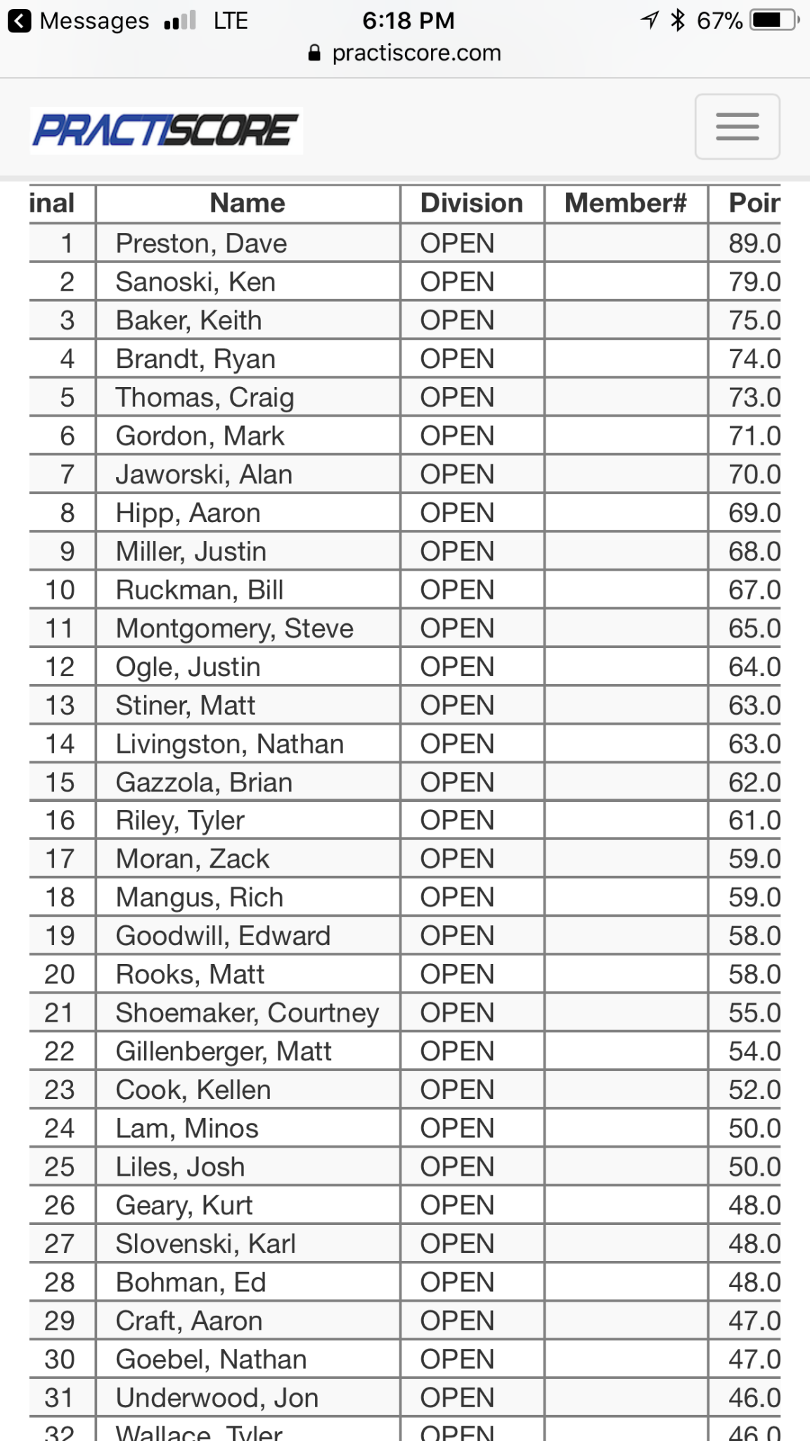

Josh had one of his demo JHR at a local pro/am match this past weekend as a sponsored stage here is a short clip I pulled from the PVA facebook page I shot sometime after the shooters in the video and after 350+ rds non stop it was still running very well with the dirt, sand, etc. being kicked up from the break. just some observations from watching other shooters, it does not run like a 700 or other 90* bolt lift actions the few people i saw have trouble with it where still trying to lift the bolt handle and run it back at the same time or not running it back the whole way to properly eject the case. overall the action felt alot like a Tikka but a little smoother, it was very accurate and alot of fun to shoot.
Thank you for the video, sure does seem to sling the brass when operated with some force.. Can't wait to get mine... What caliber was the rifle being used?
