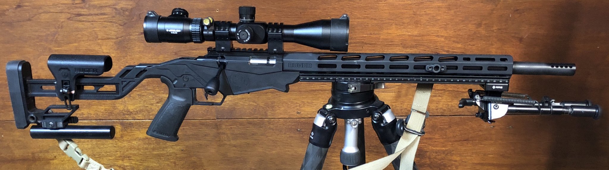

This was a 1” bar I cut from a action wrench. Tapped two holes and used a QR from an old Atlas.
I used this on an Rimfire that had a horrible stock and terrible balance.

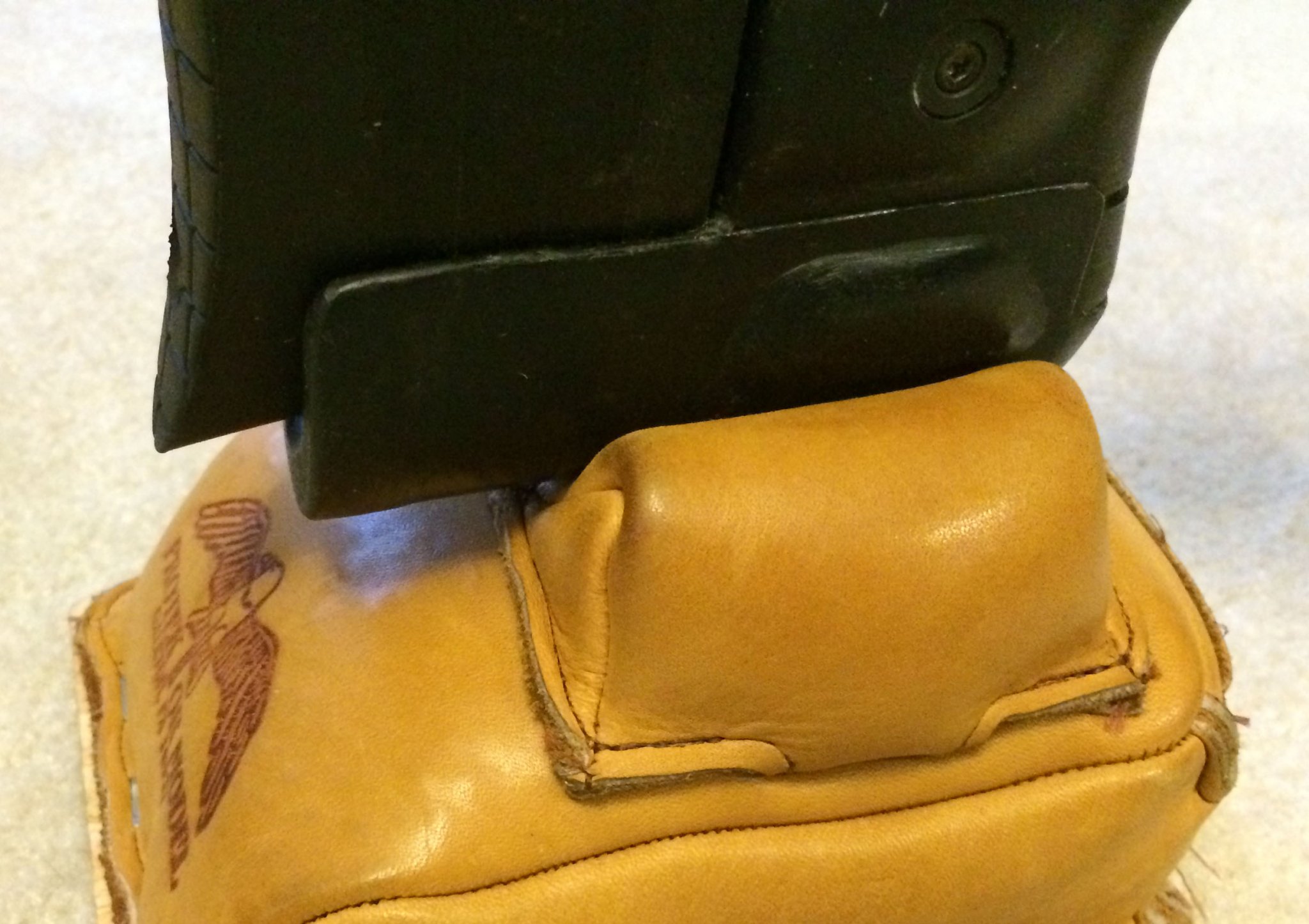

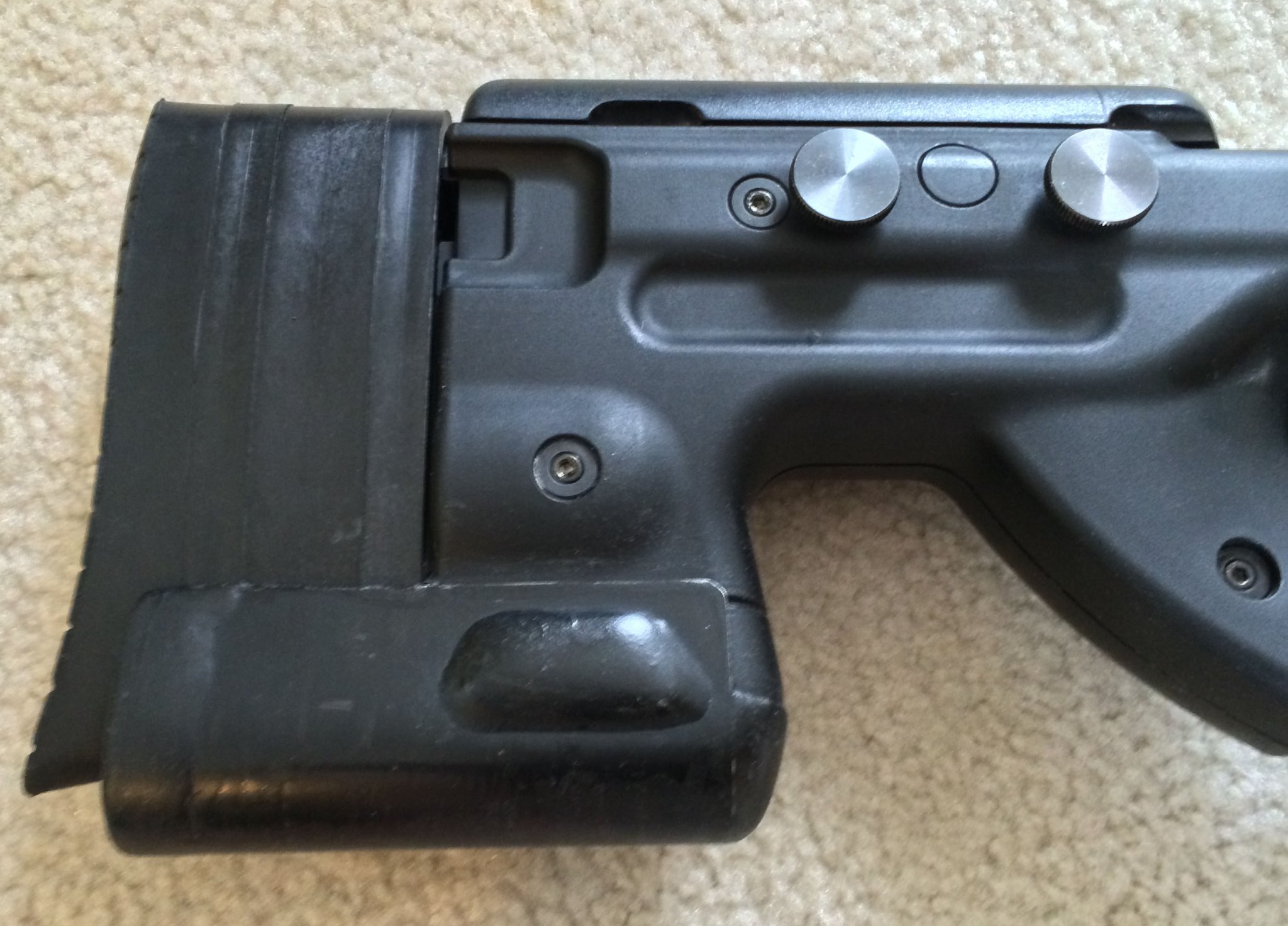

My solution:
I folded a piece of sheet metal over the bottom of the butt form a "U", then ran bolts through the side to secure it. I used some epoxy putty to cover the bolts, but if you have enough skills, you could probably counter sink them and get a much more flush finish.

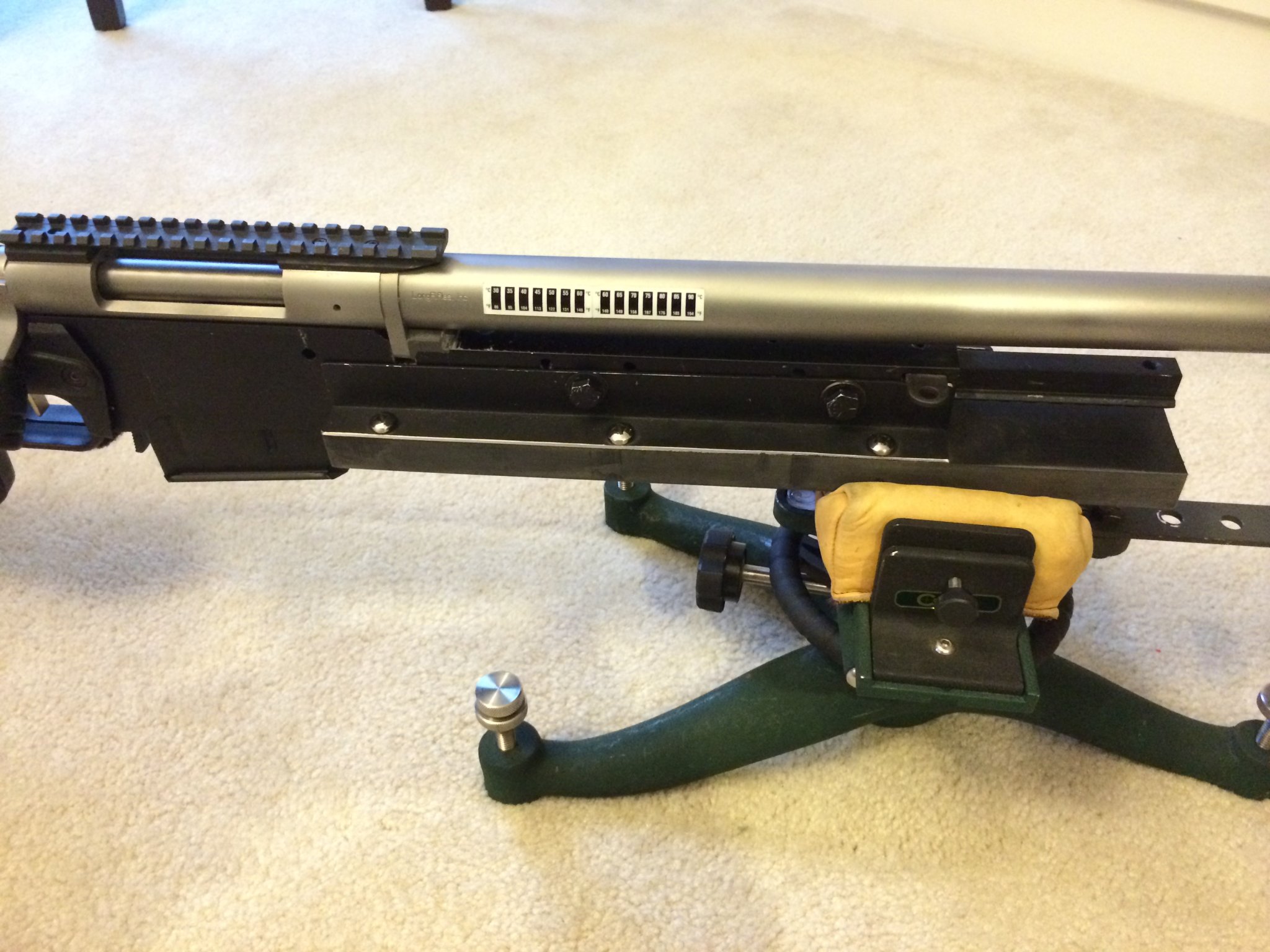

I also built a Front Bag Rider with some 90 degree pieces of aluminum and a delrin block. I just pulled the front skin sections off, and drilled 2 holes through the forend of the chassis, and use 2 bolts to secure it.
I have no issues with it, I have used it to shoot Master scores in both Mid and Long Range F-Open. I have been within a point of making High Master, damn wind always gets me!
Gotta love the looks at matches when I show up with this thing!
