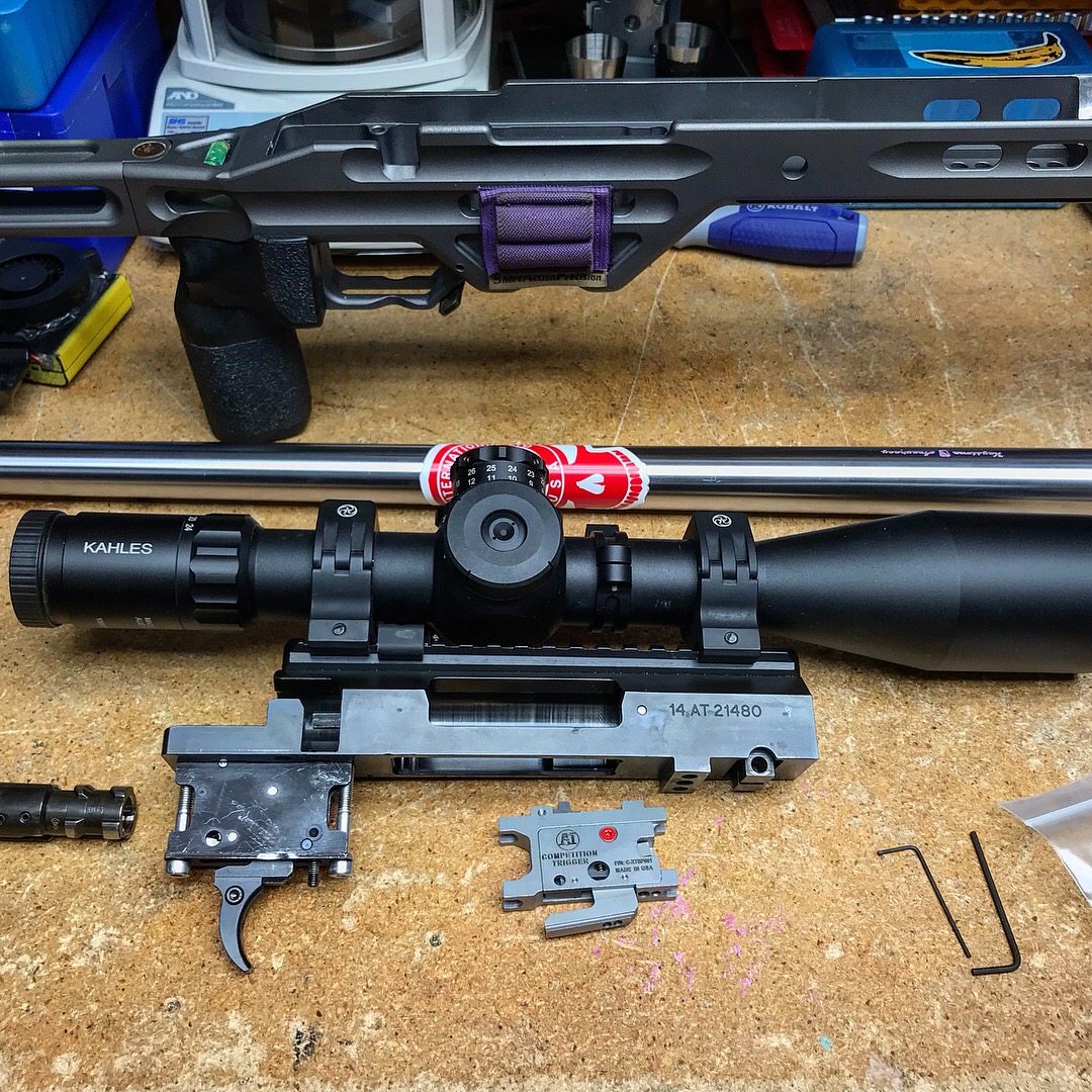

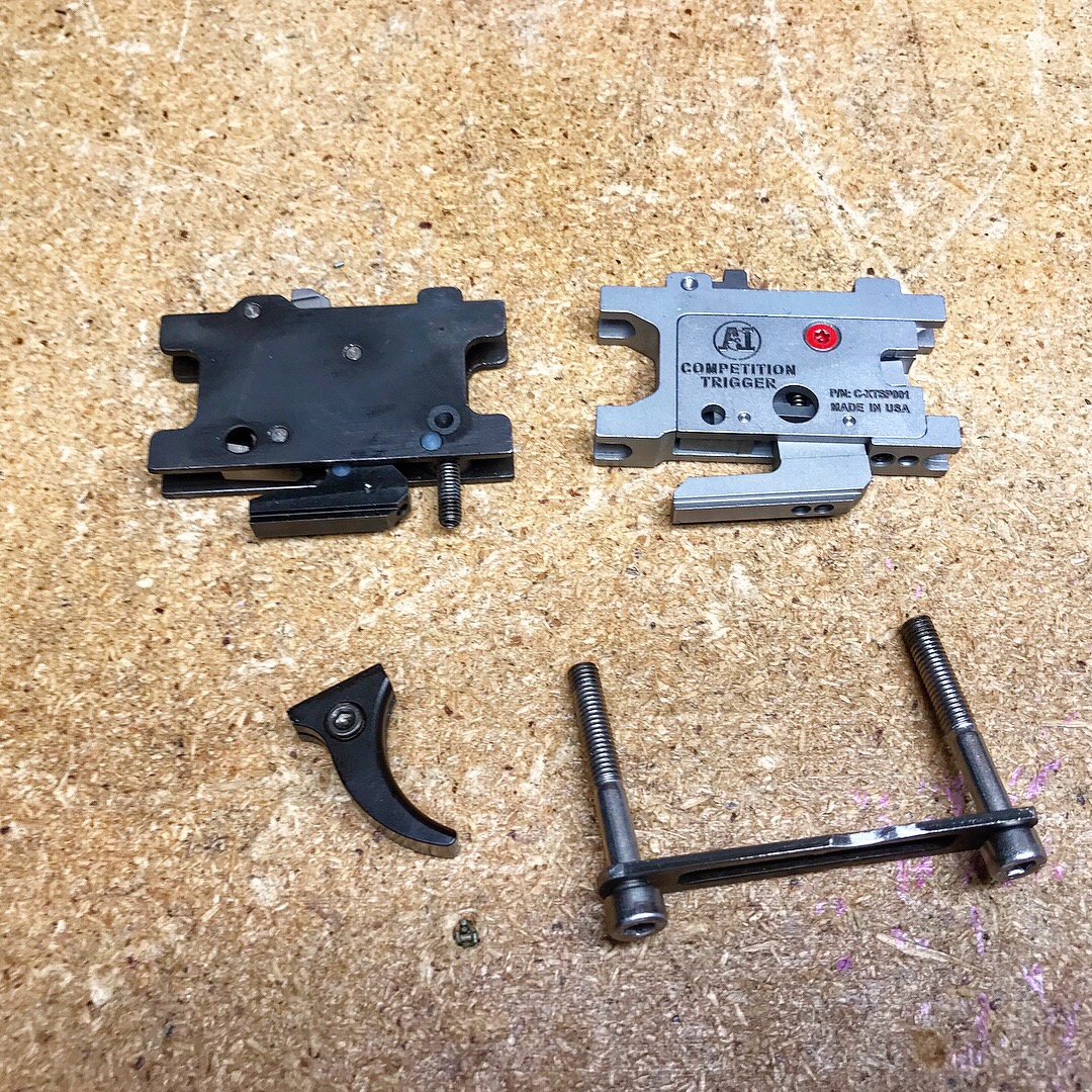

I would like to hear how easy the installation is.
Remove grip skins, remove stock trigger by removing the two 4mm aliens and plate retaining it, remove and install the stock trigger shoe and retaining plate on new trigger, reinstall new trigger, and skins. 10 minute job tops not including any adjusting.

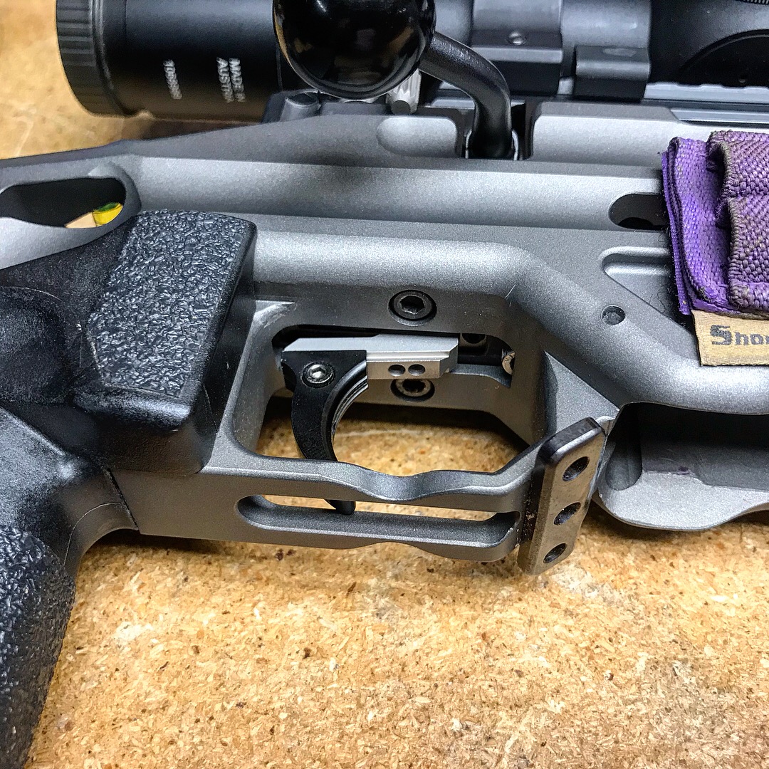

How does it feel?
Like I wish I had one 6 years ago, lol. It's awesome right out of the box. It's breaking super crisp right around 1.25lbs just like they say they're set to. I doubt I'll mess with either pull weight but I'll probably adjust out the over travel to a minimum just because I prefer zero over travel.
