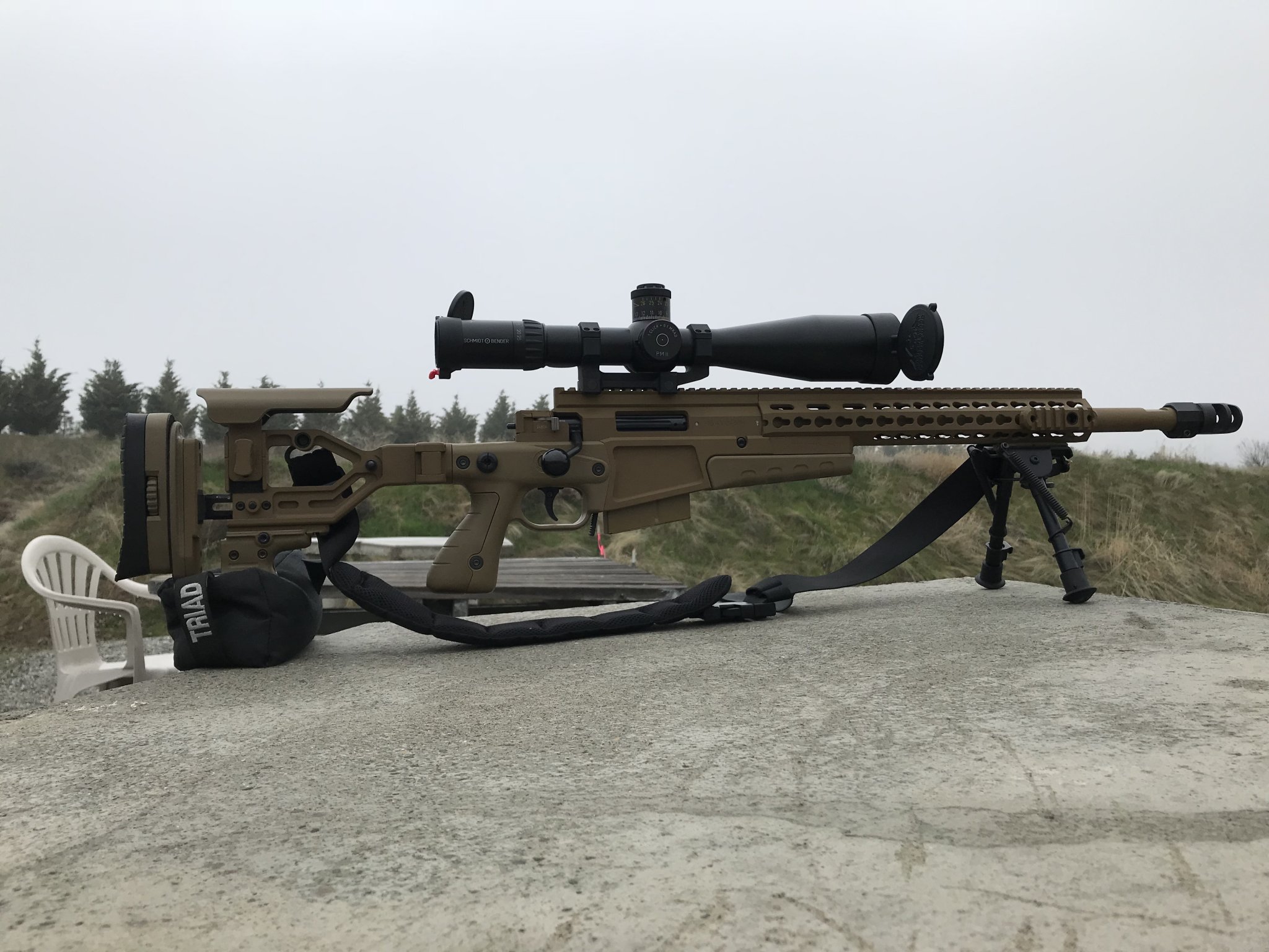

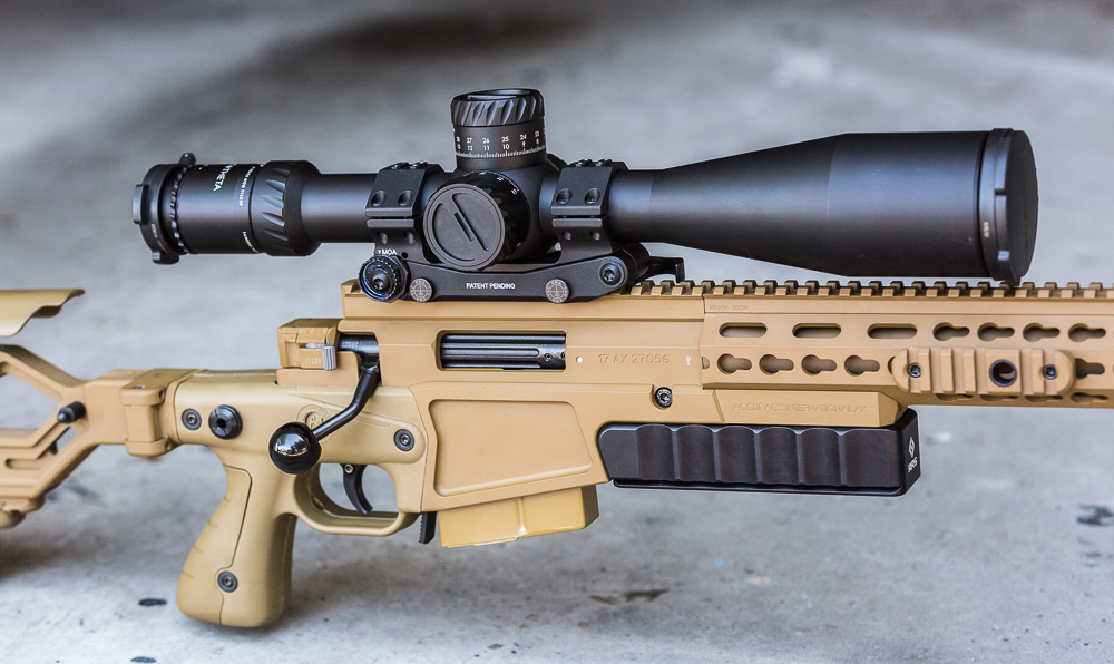

How much of an added issue on rings that are .25” taller? Serious inquiry as I don’t know.
I can't give you an exact answer because it's dependent on how far away you're shooting, to be honest. The best I can do is refer you to this (and note the article linked within the article): http://www.accurateshooter.com/optics/canting-effect-on-point-of-impact/
For me personally, I struggled with the question just a few weeks ago. I have Nightforce's ultralight rings in 1.375" height, which is PERFECT for 56MM Objectives with caps (on continuous rails - I.e. AIAX, Barrett MRAD, and Desert Tech SRS). The Spuhr mounts are 1.47, 1.48, and Badger's SASR rings are 1.49 IIRC. I believe in capturing every advantage where I can (it's like the inverse of ounces equals pounds and pounds equal pain), so I hated the idea of bumping up .13", even though most of the time it wouldn't make a lick of difference (it's only when you "almost miss the target" that these marginal differences will matter, but then, they really matter). But, I ended up getting the Spuhr, but reconciled it to myself with the fact that I got an extra 10MOA "tilt", so now I have 30MOA adjustment.
I have thought long and hard about pulling off that front rail to capture that extra advantage, but I'm also thinking about NVDs right now, so I'm quite indecisive.

As long as you have an adjustable cheek piece to get proper cheek weld, and you measure your height over bore (which you need to do regardless) and input it to your ballistic program then is makes absolutely no difference in any manner.
To run NV and thermal clip on properly you need a 1.5” center height on a flat rail.
This is ONLY True if you're shooting 100% vertically. As I said in my original post, 500 yards, it'll be hardER to tell, but the difference will still be there. I'll post this once more: http://www.accurateshooter.com/optics/canting-effect-on-point-of-impact/

You’re talking about two different things scooter, if I mount a bubble level it negates the below quote which is what you’re basing your argument off of.
“cant-induced windage errors are worsened by mounting your scope high above the bore axis”
It could read “improper mounting technique and canting your rifle will cause errors at longer ranges. However, utilizing a quality level will correct for incompetence in setting up your rifle.”
Or as your article says
“One of the key factors in long-range accuracy is making sure that the tilt/cant of your rifle does not change throughout your shot string.”
If you mount a bubble level and shoot it 100% level every time (bubble level error is also always present . . . another discussion) your rifle wouldn't be canted, so I'm not sure I understand your point.
My original quote that you took issue with is:
"There is another (very good) reason to go lower with your rings if you can. The lower your scope (closer to bore), the less the effect of any cant will have on impact. At 500 yards is this a big deal - eh. At 1250+ on man-sized silhouettes? It definitely is a big deal."
Again, if you're 100% level, you're not canted. But my statement says " . . . the effect of any cant." So............... ???????????????????????????????????
