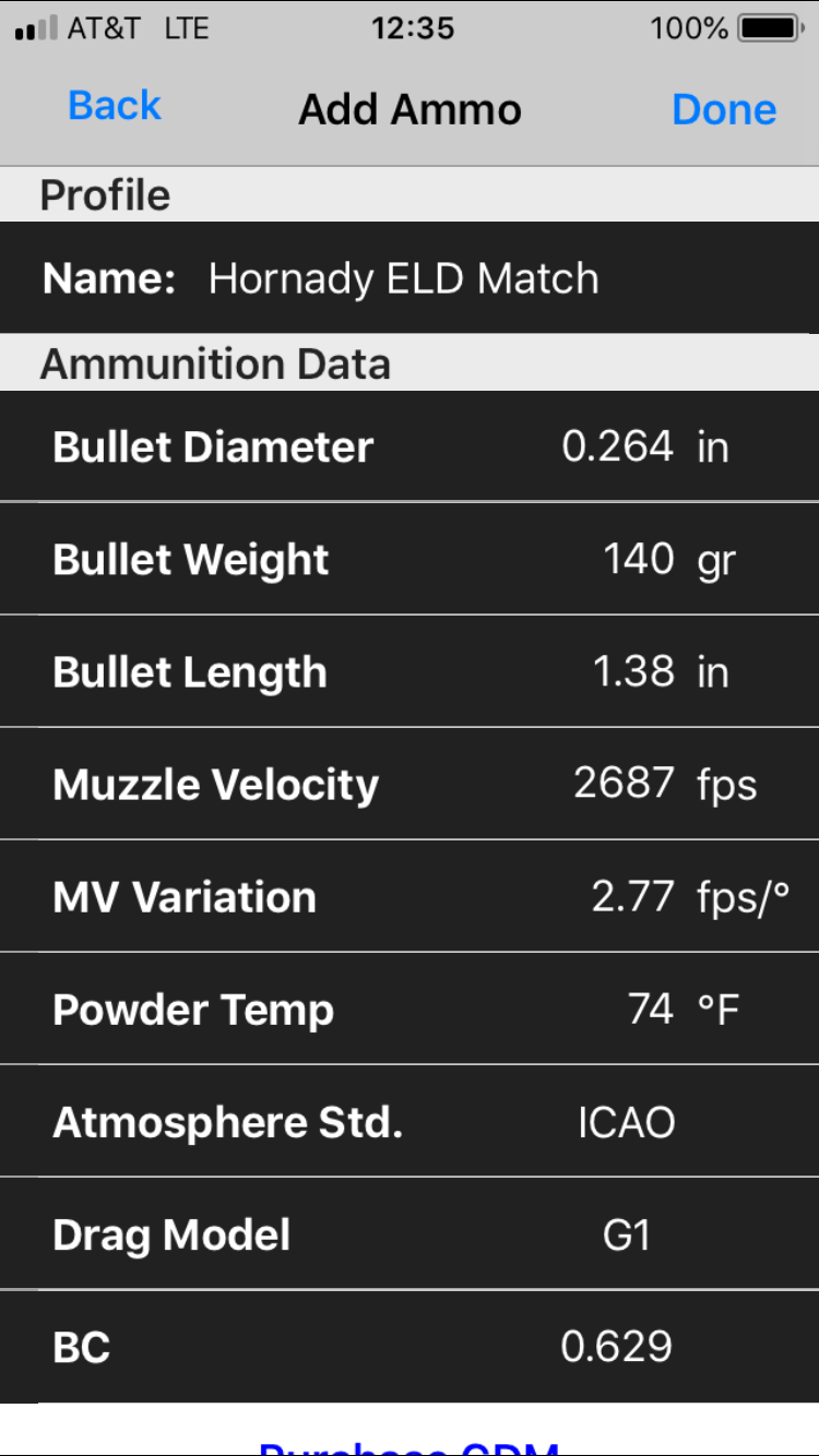

So does that mean I can just input different temps and related velocities as I record them, and not build the Temp Table from the "Ballistic Calibration" as it says in the AB .pdf?

#10
Hi again
Every time I put in Temps and Velocities, the drops are really way out.
I have checked the go from high to low.
If I delete all, just put in one temp and Velocity that matches the actual velocity in the main profile, it seems to work.
Also I have had to fudge the Velocity to get it to do accurate drops.
My Labradar says i'm doing 2990, but to get the drops to work I have to put in 2830.

#11
Hi again
Is this normal?
If you have a good velocity, tweak the BC to match the drops. I guarantee your velocity is higher than what the manufacturer determined the BC at
