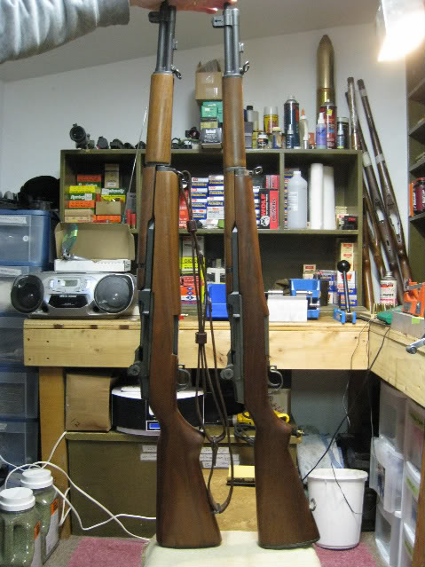

This is one of the "never sell" rifles in the SP armoury. I stumbled into some 7 years ago and my son will be making his debut appearance at camp Perry in 2020. This is the rifle he'll train with this summer,. Some of you older gents may remember Don (Mac) McCoy.
This was communications between my Son and two Grand Masters familiar with the rifle, at least by reputation. The other two Grand Mastered multiple times at Camp Perry. Some comments were mine.
Any Ideas on this?

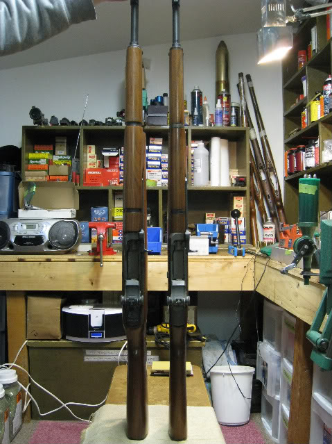

This is a one of three Garands built by Don McCoy in this specific manner. The 190gr projectile is specified, and now I should be explaining what we found on our range today.
The rifle sent all 8 rounds downrange in a single trigger pull . The barrel has been hBN sealed and we're shooting 175SMKs, impact coated. Chrono shows a nominal 2,475. There's no doubt that the gas port is set to accommodate the 190s without damaging the op-rod.
This is the rifle.
This was the original explanation.
Noted Garand competition builder and accuracy specialist Don McCoy of Santee, CA, built this M1 for me in 2001. It is built on a selected Springfield receiver (1943 manufacture date), and has an Obermeyer 5R barrel with 1:10 twist. It is designed to shoot 190-grain bullets with exceptional accuracy out to 1000 yards.
This rifle has numerous custom accuracy features, including a lugged receiver, glass bedding with additional custom fabricated steel plate fittings that tie the receiver into the bedding with 3 bolts, ½-minute rear sight, reaming to ensure barrel & gas cylinder clearance as well as machining the end of the gas cylinder for stock clearance, and many more machined accuracy refinements. The forward hand grip is also glass bedded with attention taken to ensure complete clearance for the op-rod. The heavy stock is English walnut with a Fullerplast finish as only McCoy can do.
The 2-stage trigger is extraordinarily smooth and makes the rifle a joy to shoot. The rifle has approximately 40 rounds through it. It was function-fired by McCoy and later broken-in by myself using Tetra Gun followed by a dry patch every round for the first 10 rounds, every other for the next 10, and then 5 + 5 for the final 10 rounds. After the last 5 rounds it was immediately cleaned with Tetra Gun, dried, and a patch with Militec-1 lubricant was run down the bore while it was still hot. After returning from the range, the bore was cleaned with Sweets 7.62, followed by Tetra Gun. Lastly a patch of Militec-1 lubricant was run down the barrel. All cleaning & lubrication/protection was run from the breech to the muzzle.

This is the bedding. Note the three welded pillars and the corresponding bedded receivers in the stock.

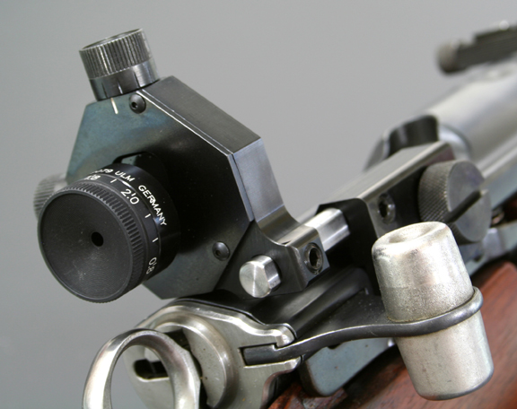

Bob is the one who proofed our 1,000 yard Diopter Sight System at Quantico. He was rewarded with the #1 Diopter off the production line. My son made him a personal presentation box in appreciation.
View attachment 7045793View attachment 7045794View attachment 7045795View attachment 7045796View attachment 7045797
