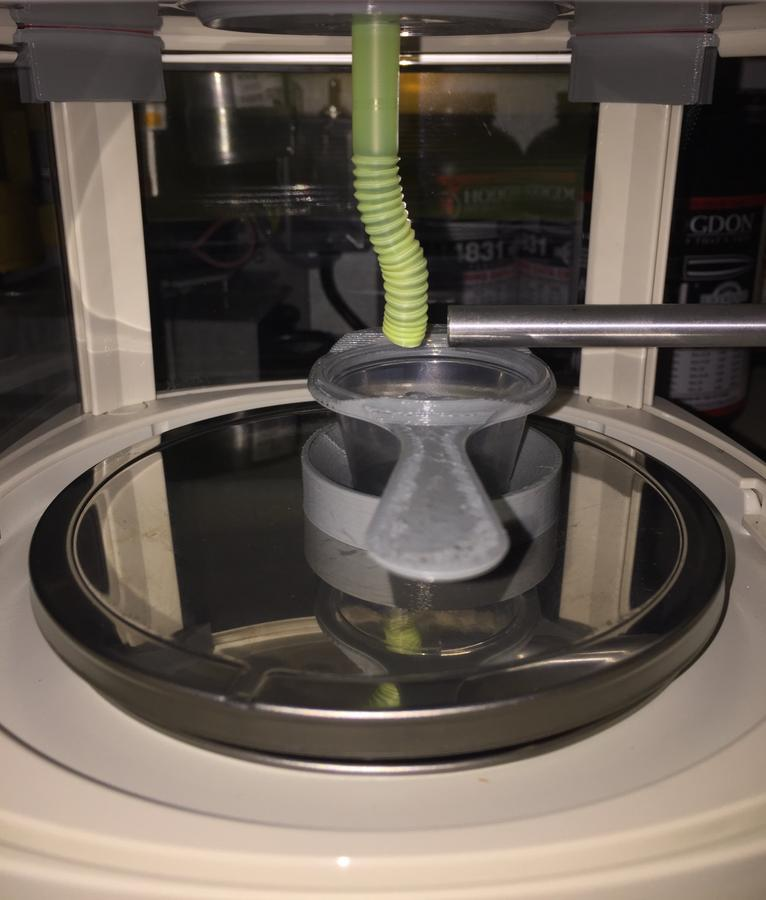

Got my scale and thrower/trickler set up this evening.
Was a little overwhelmed with the scale manual, but quickly figured out the only page applicable to my use was how to calibrate using a check weight.
Adam's instructions for setting everything up were excellent and I was throwing charges within 20 minutes.
Now for the bad. The plastic cup was terrible in every way. It splashed powder and even after a rubdown with a dryer sheet I'd get powder kernels stuck to it. Watching graphite colored pieces of gold known as H4350 kernels splash all over almost made me weep, haha. Besides the powder loss, thecsplashing powder would end up on the scale plate which would need to be removed for the scale to return to zero once the empty cup was put back. Ordered the PVA kernel dumper and expect it to be much better.
I reload standing up and will probably cut a window in the roof so I can place the cup back under the bent straw from the thrower and metal tube from the trickler without having to bend over and interrupt my rhythm.
Haven't loaded any rounds yet, but it's looking like a good investment as it seemed about 50% faster than the Chargemaster to hit my 42gr target from the time I set the empty pan down until it was at target weight.

Check out Area 419's powder cup. I'd also recommend getting a class 1 100gram calibration check weight. (100gram is the balance's default check weight setting)
I found that my FX120i was off by 0.043 grams which is 0.664 grains.
I just got my scale, got it all setup, tested some varget and realized I forgot to order a check weight. :cry:
Hoping it gets here by early next week.

I have the 419 base and the 419 powder cup. Sure makes things a lot easier once you get it dialed in..Ray
The powder cup makes sense, and it was a toss up between PVA and A419, but I'm not seeing where the stock plastic base on the trickler is an issue. What does the A419 one give you in terms of an upgrade?
The base is much heavier and sits on adjustable feet allowing you to adjust the rate of flow on your trickler by changing the angle. The stock base does work and will get the job done also. Area 419 really makes some nice stuff, although on the expensive side. The machining on the base and the cup are truely works of art. This is my first time ordering anything from them. Ray

I guess I lucked out as my trickler is naturally sitting at a really good angle for throwing H4350 without going over and having to mess with it. I'll keep the A419 base in mind though, should other powders not do so well.

I am using a 2/3 cup stainless measuring cup from WalMart for my powder cup. Nothing has bounced out and the set was $6. I picked up my AutoTrickler used and it didn't come with a cup.

ordered 2 60ml stainless steel cup on amazon for 7 bux, will see how it turn out
