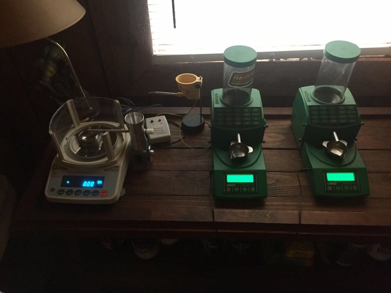

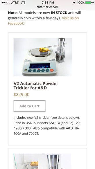

Recently while searching through the internet I found a device that plugs into your A&D FX120i lab scale and turns it into an actual powder thrower. It's called the V2 Auto Trickler and it consists of a motor driven powder thrower, a connector cord for the thrower to connect to the scale, a few plastic "bands" that are used to give turn the trickler motor, a rubber tare holder for your powder pan, and a slide that adjusts how fast it actually throws your powder.
Heres how it operates. You use a scoop such as the yellow powder scoops that come with Lee die sets and get your charge weight set on the A&D. You then press a set button on the scale and it then programs your charge weight into the part of the scale that throws the powder.
After that you simply throw or pour ( using a charge master or a manual "scoop") powder onto a pan and pour it on to the A&D scale. It then throws the final charge in about 2 to 3 seconds. So if you're wanting to throw exactly 44.0 grains of powder you would place 42.5 or so onto the A&D and the trickler would automatically throw the remaining 1.5 grains and be within 2/100's of a grain.
This piece of equipment is nice if you're looking for exact tolerances on your charge weights however it does take a little more time because you're having to add to the pan that situated on the A&D scale. However, if you're looking for something that gets you dead nuts on your weight it's bad ass. They also make it for the Sartorious.
Heres the website.
http://www.autotrickler.com/index.html
Ive used it to load about a thousand rounds so far and have not had one issue with it.

Had mine for about 9 months and it's great. I bought the A&D FX-120i from Cambridge Environmental and got a great deal. My trickler is version 1 and I can see the benefits of V2. I haven't upgraded mine, I may or may not.
It will dispense to within +/- 1 kernel of RL-15 or Varget as an example. When programmed for and dispensing 44.0 Grains, it will usually hit 44.0 exactly, but it's not unusual to go over by .02 grains (1 kernel). If you're anal like me, you'll pick 1 grain out and be on exactly 44.0 grains.

Actually, Cambridge Enviro is working with Adam and selling the trickler. They can also configure and install the unit for you for a small fee. Just confirmed this with Adam himself via email.
