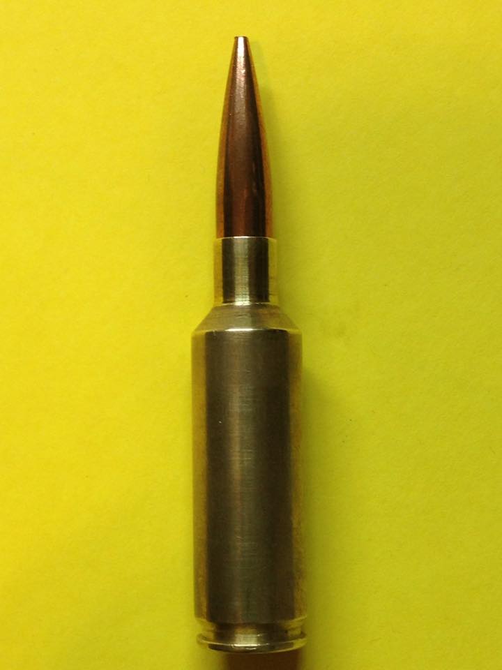

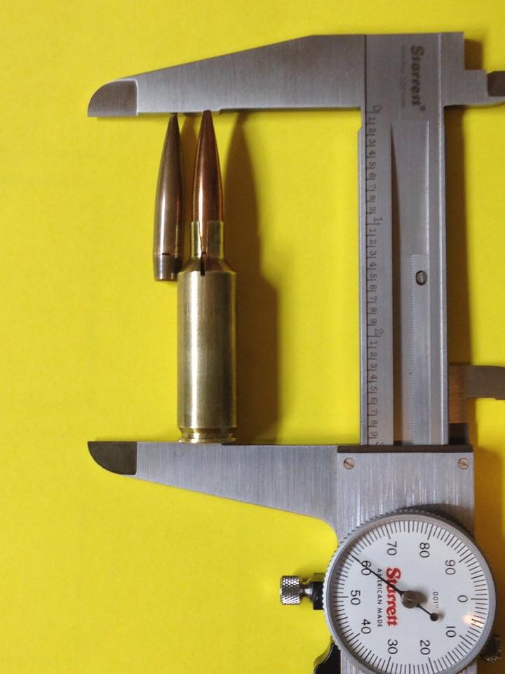

So i started reading into the 7SS and am pretty astonished as it seems to remedy the OAL restriction issues that plague the 7 SAUM. The SS is .075" shorter oal. It is .095" shorter at the neck shoulder junction which determines where proper bullet seating depth starts. It has a .020" longer neck than the saum. It has a 40 degree shoulder and less body taper keeping case stretching to a minimum. Allows 180gr hybrids to be seated right at the shoulder/body junction and still fit in Alpha and Accurate mags. Speeds reported from a 26" tube are impressive as well. 3200fps for 168s, 3100fps for 175s, 3070fps for 180s, and 2955fps for 195s. These are all on RL26. I had plans to get a 7 SAUM spun up this summer for my TL3 but i think i've just made the switch. Rich is now selling prepped brass and has reamers ready to go. Has anyone else been using this cartridge or have any experience with it?
Here are some pics from Vestals custom rifles on facebook, i was just trying to find pics of the round. 180gr Hybrid at 2.960 which is the OAL we're running 140gr hybrids in our 6.5 SAUM at.

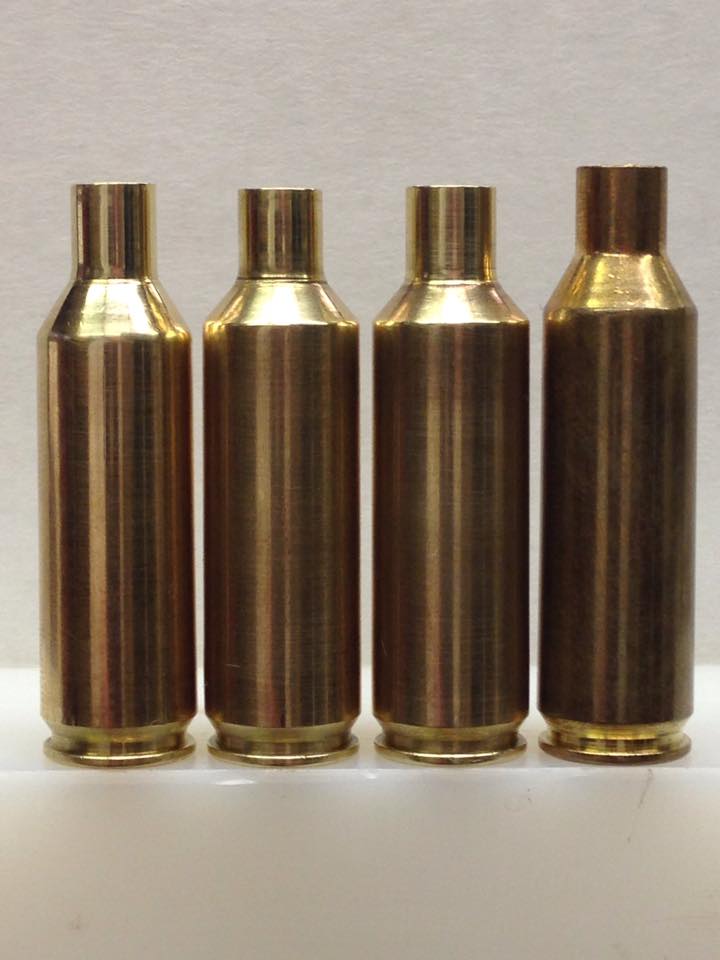

Yes, I'm prepping mine. If you go that route, prep small batches at a time, like 25. Each time you do it you'll figure out a better way for the next time.
It's really not difficult at all. I size mine down from 7 SAUM in a shortened 6.5 SAUM die. I neck and size at the same time. Then, trim to length (leave long) and trim the necks. Trim length after firing and you're ready to go. I've added a couple more steps checking for an inside doughnut and leaving the necks thicker for the first firing and trimming again after fireforming. It's still pretty darned easy but, yes, it does take time away from other tasks.
