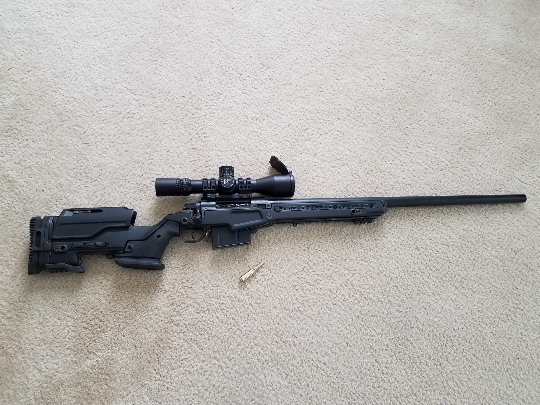

Just finished a 7mm SAUM build on a Tikka action. Pics and details on page 11 of Tikka T3 thread in Bolt Action sub forum.
27" Bartlein
Norma Case
RWS LR Primer
Berger 180gr Hybrid
COAL 2.950" (15 thou off the lands)
62.3 gr Retumbo/AR2225 (for aussies)
2900fps
Put 8 shots into .393" at 100 yards, bipod and rear bag off bench.
Shot a comp on weekend at 300, 400, 500 yards. Load appeared to work OK at these short distances
7mm SUAM will feed out of Accurate 308 AICS mags, mine have no front plate. I could fit 8 in a 10 round mag. No feed lips or other mods needed.

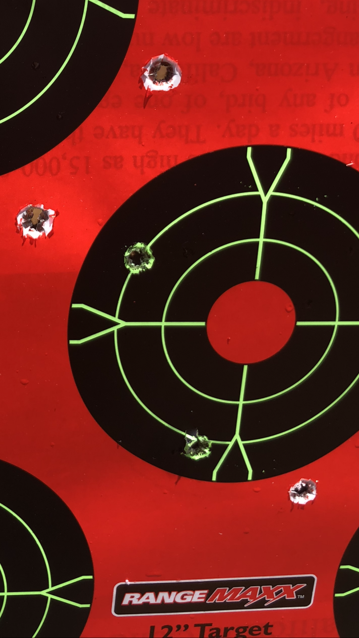

I just started load development on the 175 eld-X in my M70 short action. I ran a ladder test at 400yds using H4831sc stopping at 60 grains. I found a good node between 58.2-58.8. Using 58.5g I later had good results (.5 Moa 3rds) but they are not going real fast. 2720fps out of my 24" barrel. (Hunting build). Seating depth was 2.237" B-O as my chamber is not real deep. There is still empty space in the case so I will try going above 60g to try to find another node.

I was able to get out a couple weeks ago with the new (to me) ELD Match 180 grain bullets. Loaded at mag length (2.979) I was getting great results at 200 yards with H1000. I had them at 64.3 grains. There are ever so slight ejector marks and no sign of a heavy bolt. I need to retest again when I have more favorable wind conditions but that load looks promising

Finally have my load dialed in.
Virgin Norma Brass.
180 ELD match.
61.6 grains of H1000.
Wlr non magnum primers.
2.955 oal. 0.02 off the lands for my rifle.
28” Bartlein 8 twist tube. On a trued Rem 700
Shooting .25moa.
2949 5 shot average with SD of 6.7 shooting through SiCo Omega can.
Mag feeding in a short action. When I began this build lots of people said no way you can get over 2900 in a short action and be able to mag feed, if you’re planning to build, just do it. Couldn’t be happier.
nations1017

Just got mine back from WTO with a 28" Bartelin 7 twist chambered for 183 sierra matchkings.
Load developed is using once fired Norma brass
62.1 grs H1000
CCI BR2 primers
OAL 3.145"
MV was listed at 2899 fps during load development but I have duplicated the load with virgin Norma brass and only getting 2800 fps.
Virgin Norma Brass.
180 ELD match.
Shooting .25moa.
I was also advised not to do it on a short action because what you have could not be done. I'm going to have to re-work my load. Should be getting close to what you are seeing with my long action and those 183 Sierras.

Ok, my 180 load is great but I felt like I could get better luck with 162's, and WOW!!! I got a 162 ELD Match doing 3327 SD of 10. Shot same size group as the 180's averaging around .25 MOA @ 100. Shot a group at 820 yards shot right around .5 MOA at that distance. 90 couple degrees and 12mph winds. Shot the group pretty fast because I was melting. But very happy with this load. I had another node doing 3343 but had SD of 30fps. The group was shot with the load with he higher SD. I think I can get the groups to .3-.4 at this range after some tuning. More load development coming. Im hoping to get the 3327 node to a little lower SD. Then gonna take it to a mile.
Once fired Norma 7 SAUM brass. 65.5 grains of H1000. Seated .010 off the lands, OAL was 1.948". This was the 3327 with SD of 10 load. Mag fed with 0 issues.
