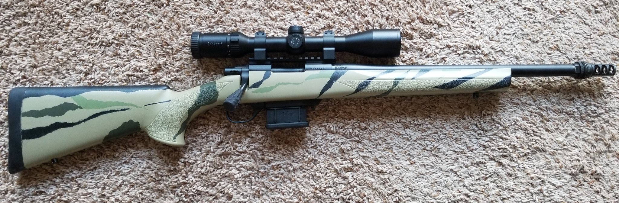

Anyhow, Howa mini action, factory barrel shortened to 16.5" and threaded. Factory trigger molested down to ~1.25 pounds, and factory stock treated to a custom Krylon job. Just got the bolt back from having the handle threaded and knob installed. Scope is nothing special; Zeiss Conquest 3-9 (had it just sitting around) on a 0 MOA base.
Should be a fun little plinker.

Using cheap steel case ammo (Monarch 122 gr HP and Tula 122 gr HP), it looks like a 1.5-2 MOA shooter... about what I expected. Certainly MOR (minute of rabbit) or MOA (minute of armadillo), anyhow.
At some point I'll probably pick up the stuff to build my own rounds, but for now I'm satisfied.
