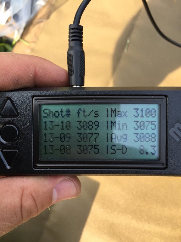

WVC1119
Belligerents
Mar 10, 2017
51
5
12
39.7gr H4350
Norma Brass
BR-2 Primer
105 Hybrids
Jump .01
Getting 3075 from a 26" barrel

105s shoot well so I know what I have with them. I was getting 3125 out of them in the lead up to the Grind. I doubt I’d see that speed from 110s.
