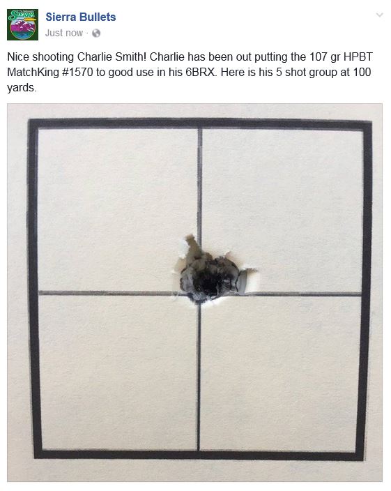

I'm using a 30" X-caliber prefit in 6BRX on my Savage Model 12 BR. I have been very happy with Sierra 107MK, 32.2gr of RL15, as 2942. 5 shots @ 100 yards.
