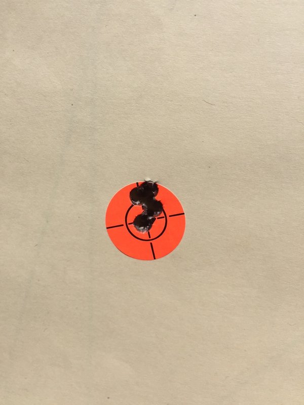

How is this combo working out for you ? Please leave your load and rifle specs. Thanks.
Shoots the same whether it's 40.2 or 40.9grs, seating depth doesn't matter as well, they all put 3 in a small group and 2 out @200yds,, why, I don't know.
