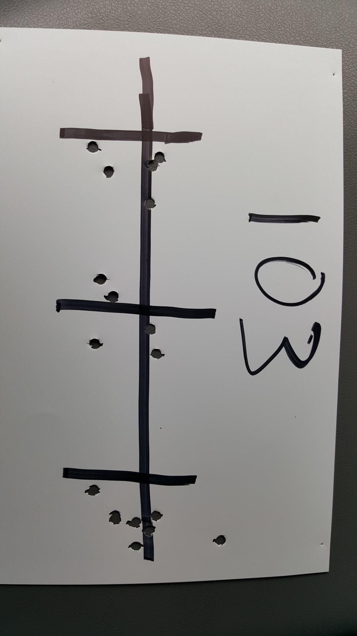

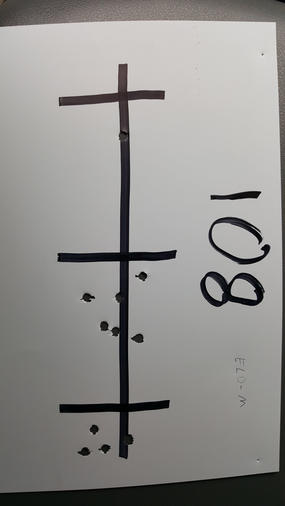

I also bought some Hornady ammo, both the 103 and 108, and they also are terrible. I've tried shooting suppressed and not suppressed with the same results.

I was out again this morning after putting a new scope on the rifle. Groups improved considerably, even in the 25+ mph winds.

Update. Went out today and put up some 3/4 moa groups shooting the same loads as I was before, even with some mirage. Thanks for the help!
