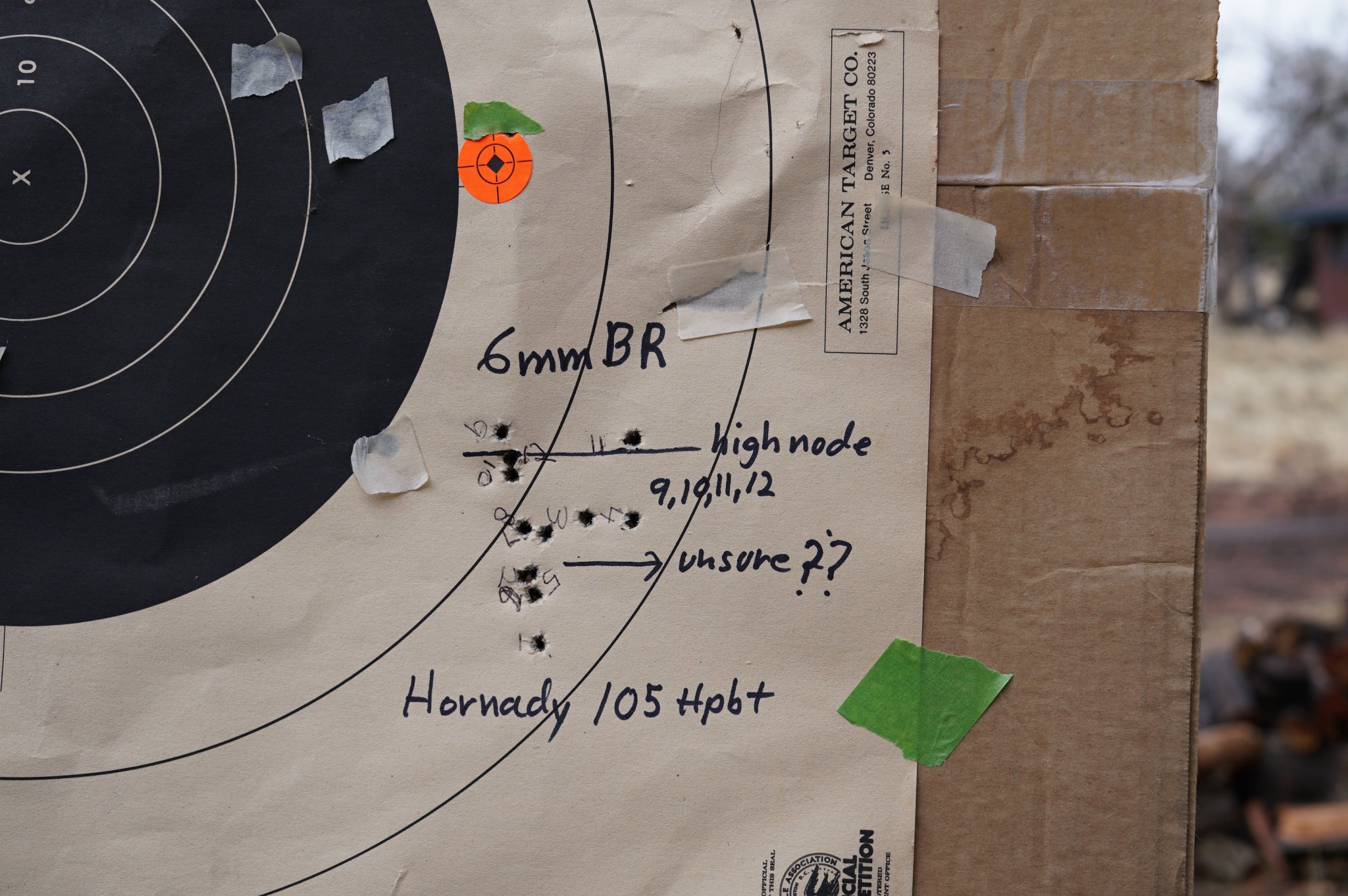

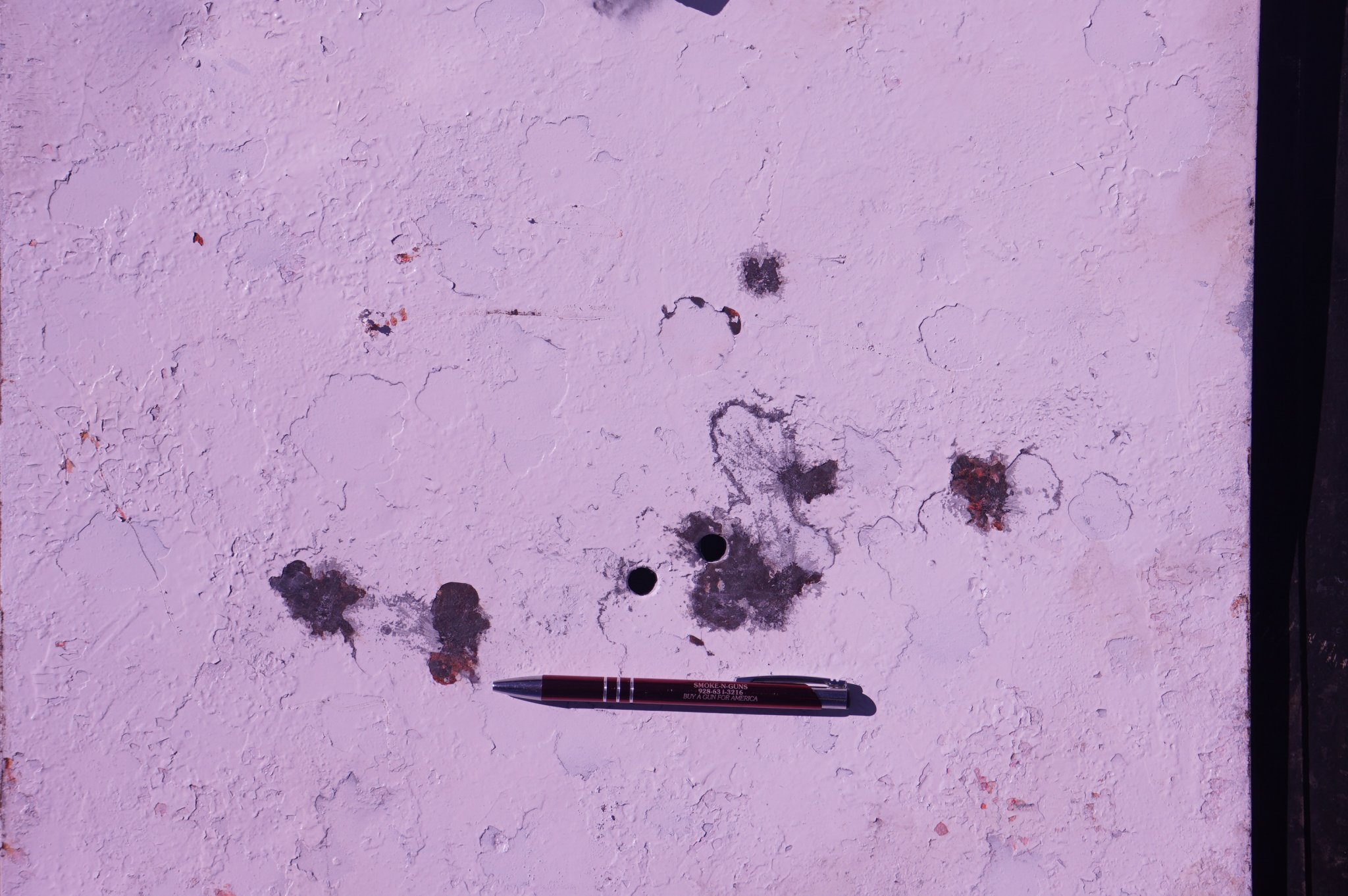

Hey guys I just had to share this crazy small vertical I shot this morning at ""1000Y"" with my 6mmBR - as witnessed by two of my shooting buddy's, Steve and Mark.
I know it's almost unbelievable but that is a mag full consisting of 10 shots. The big group has 4 or 5 shots in it, I'll get back to that soon.
The high one is about 4" above and the rest are into 1.3" vertical, for 9 shots!!!
So if you look closely after expanding the photo there are two holes from my 30 caliber that got poked through this AR400 steel at 200Y many years ago. Those holes just happen to be close to where the larger group of hits from my 6mmBR are. The reason I said 4 or 5 hits is because I didn't hear one of the shots hit the steel. If you look closely at the 10 oclock position on the higher and right-er poked hole there is a graze on the edge of it, at least I think it is, and I'm going to give myself the benefit of the doubt, 😁
This was shot at around 50 degrees in a half value wind of 1-4 mph with a DA of 6000.

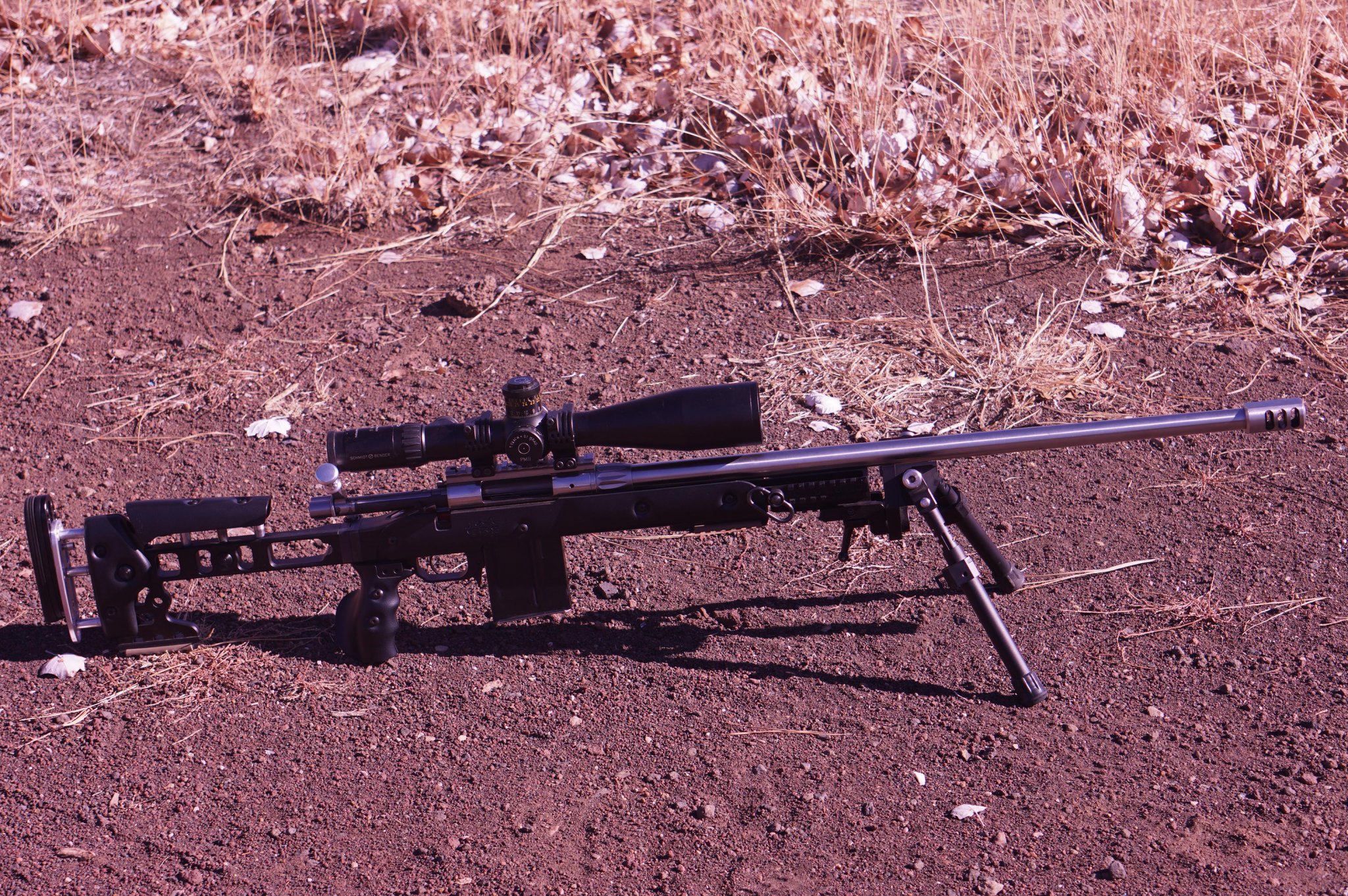

Shot from the bed of my truck off the LRI bipod and Traid tactical rear bag. Mausingfield action, Shilen select match prefit, Bighorn barrel nut, TT diamond trigger set at 10oz, GRI Bolthorn chassis, S&B 5-25x56 PM2 in ARC rings.
I'm going to put this same post in the range report forum as well.
View attachment 7179063View attachment 7179064
107s or 105s?

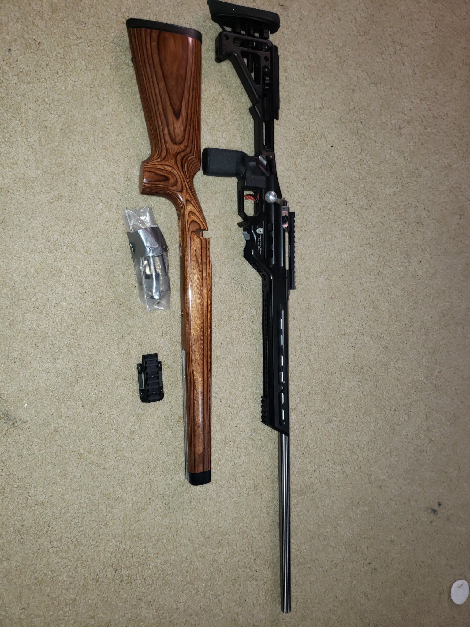

29.1gr varget
FMSRP
Peterson Brass
105 Berger vld
2.3 std dev
2802fps
Savage Model12 bvss action
Midway Shilen 26"
MPA Hybrid stock
