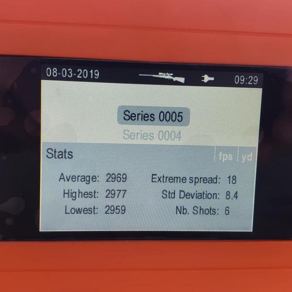

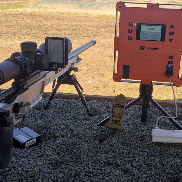

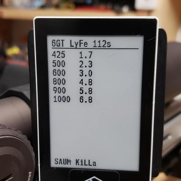

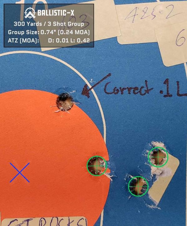

Broke in the GT 2.0 (1:7 twist) about 2 weeks ago with 25 rounds. Heavy clean the barrel.
Zeroed, shot a practice out to 1K and shot our monthly LR match this last weekend. Sent about a 100 rounds total down range.
I didn't have time to work up a load so I decided to use a load that looked promising in the GT 1.0.
Rolled with 33.9gn of Varget pushing a 112 Barnes Match Burner. Previous numbers said I would be at 2900, but I was closer to 2970 as the barrel broke in. 6.8mils out to 1K.
Notes: Those 112s HAMMER and do pretty freaking good in the wind. A lot of my misses was because I called too much wind vs. not enough.
One thing I am liking about the GT is the consistency from gun to gun so far. The 108 ELDMs with 33.5gn of Varget hammered in GT 1.0 and those same rounds in the GT 2.0 hammered as well.
One thing I loved about my 260 was being able to run the same load from barrel to barrel. I didn't load dev for years running a 260rem. I am hoping that will be the case with the GT
A few pics from this past weekend. I did have some vertical stringing as I am trying to get use to the chassis life. It was night and day vs. my KMW Sentinel. Just not comfy behind my XLR yet.
SDs and ES were decent considering I am running 2 different charge masters at the same time.
Messing with my buddy that just built a new 6.5SAUM. LOL
View attachment 7125080View attachment 7125081

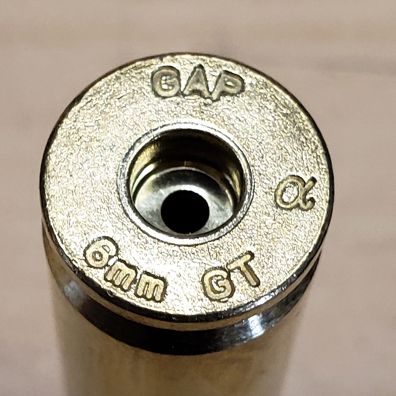

I just got the new RCBS dies from GAP. Can't wait till Alpha comes out with their brass. Gonna be starting my load development based off your results.
bodhisafa
Belligerents
Jul 24, 2013
275
29
34
39046
What are you initial thoughts on the dies?
Can’t decided if I should get these or the Redding set
Off Duty Ninja
Aug 31, 2018
36
37
24
Manassas, VA
Initial impressions are it's a solid quality feeling dies. Apparently its RCBS new "flagship" dies so that's saying something. Seater is nice but curious as to how I'll feel about the bullet window. No brass to try it out yet. Never tried RCBS competition dies before but for the price and included bushing, it's over $100 cheaper than the Reddings. That's over $100 I can save and use for when Apha comes out with the brass. I wish I could get both dies and test them out together to really see someday. Maybe someone that gets the Redding dies will let me borrow theirs for a couple of weeks to test.

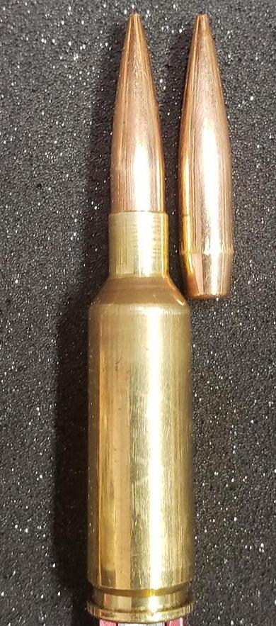

Anyone have a picture of where a 105 Hybrid sits in the neck when seated to the lands? Is the Freebore a compromise for 115s vs Hybrids? How far out in the neck is the bearing surface/ boattail junction?
samb300
Anarchy Outdoors, Accuracy Obsession
Belligerents
Feb 22, 2013
955
1,180
99
Milwaukee, WI
I’m also curious as to how it compares to the standard freebore on a Dasher. I’m guessing it’s a good compromise for the 105 Hybrid, 110 A-Tip, and 115 DTAC.
