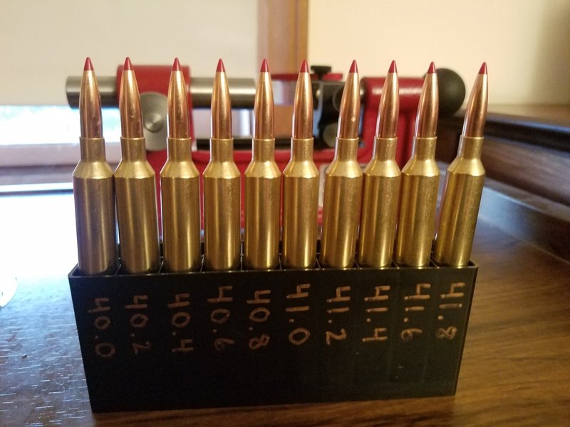

Please post how your hybrid 100v ladder test turns out. Hopefully it does well for you. I can't find h4350 or imr 4350. I started to try imr 4451 since it is suppose to be pretty close to h4350 anyone tried imr 4451 in a 6 mm creed?
I went back to lgs and they were out so I tried a ladder test on some powder I had on hand rl19 and hornady 108 eld match bullets I am definitely not getting fps I would thought I would.I am so far at 41.gr at 2690 fps average with magnetospeed according to hornady reload data I should be around 2900 fps out of 24" barrel. It was pretty accurate but like to be around 2900 fps . I am afraid I'm going to run into pressure problems before hand. Plus rl19 is temp sensitive. I am using cci large primers rl19 hornady 108 gr eld match bullets are seated at 2.2340 at ogive. Anyway I may have to wait till I find something different instock. I guess everyone is using 4350 lol I have heard that 4831 does good but haven't tried it either. I do see a lot of it on shelf. I figured the rl19 is pretty close to 4831 as burn rate anyway. I hope we will start seeing some of these powders back on shelf soon.

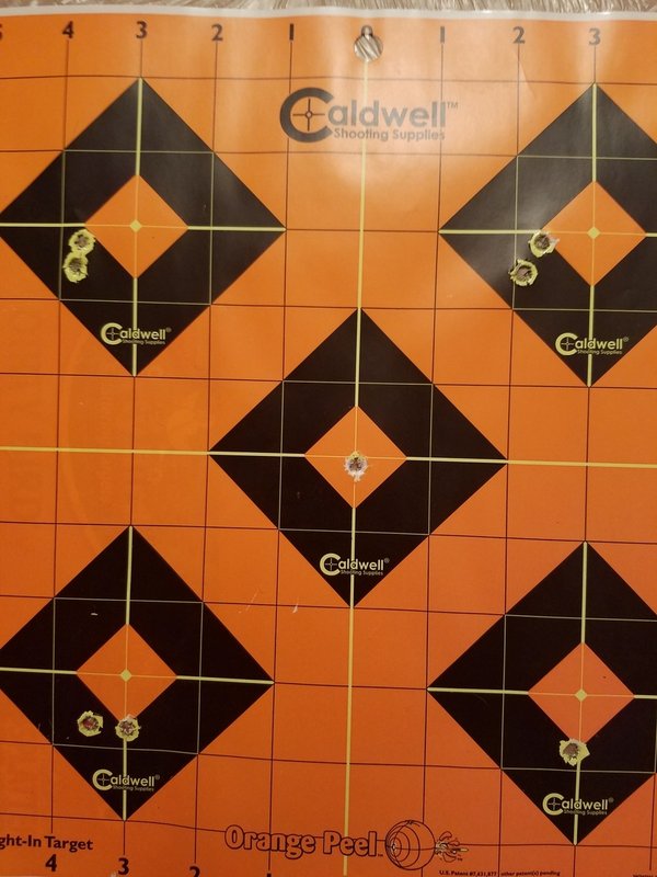

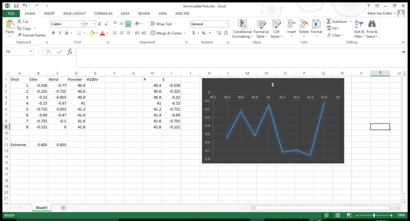

Shot targets top left, then top right, bottom left, bottom right, center in order of increasing powder levels between 40.4 and 41.8 gr of H100V. Saw no pressure signs throughout. Liked the level area between 41.2 and 41.6 (shots on bottom targets). Playing with different seating depths at 41.5 gr now
Unfortunately I don't own a chrono yet, so can't speak to that
26" barrel with 1 in 8" twist, Hornady 108 gr ELDs

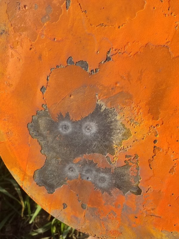

2.4" group at 425 yards
2.800" seating depth, 41.5 gr H100V
Out of 26" barrel, 1 in 8" twist
Hornady brass, Hornady 108 ELD, CCI 200
