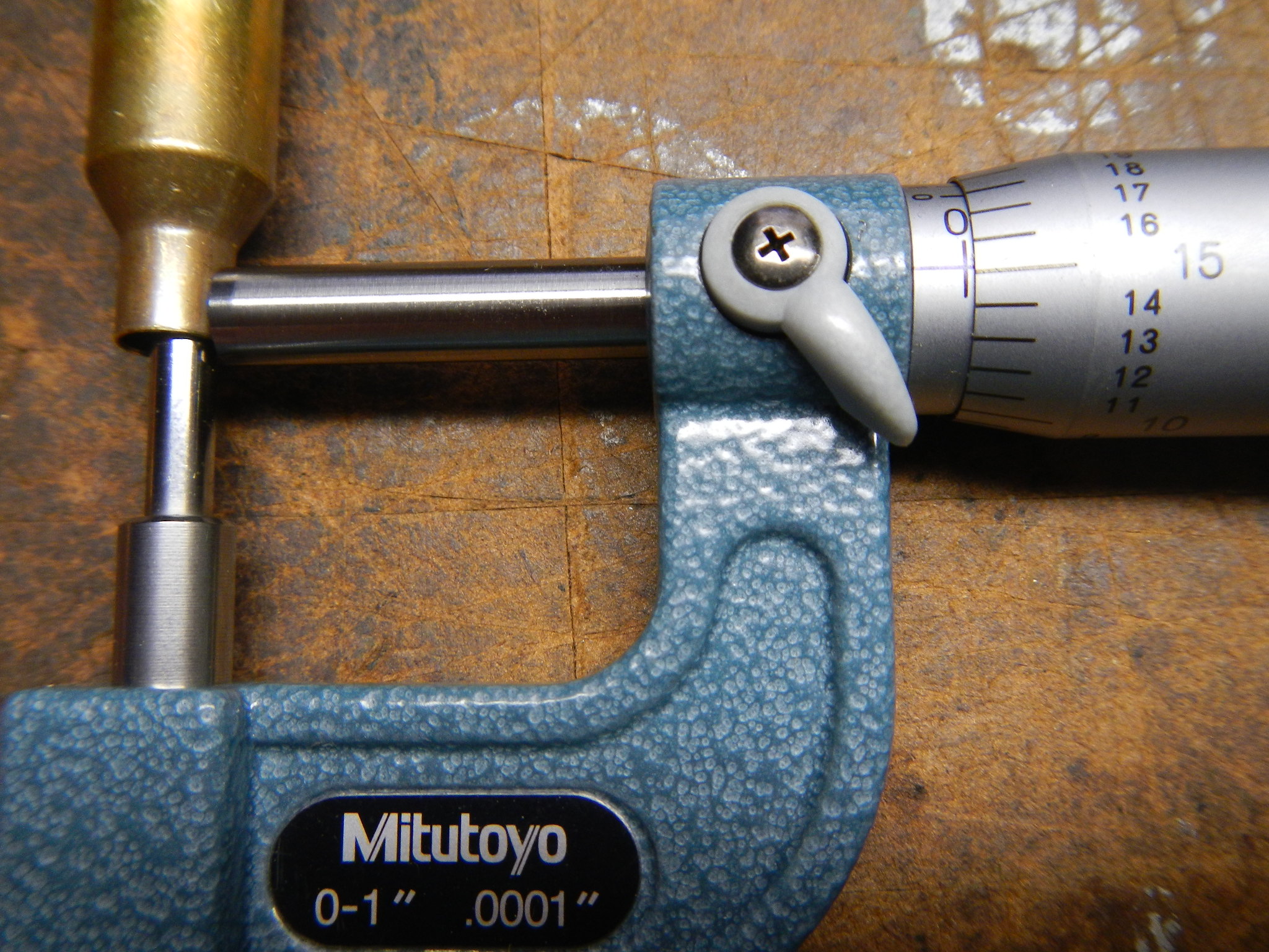

No JGorski, using Hornady 6CM. If I have this right, 271 less 30 neck walls = 241 for .002 tension. Definitely not able to seat or unseat with the fingers, on mine, anyway. I was under the impression that .002 was about right for bolt guns? No issues with the first 150 or so rounds.
No Ismull, Hornady brass is only .00137"-.0139" thick in the neck, just measured one with my vernier ball micrometer. So it's 243 + 00138 + .00138"=270.6, how I get a 270 bushing.

My lot of new brass measures .015, and 271 is working fine. I have 269 and 270 for other situations, like yours, for example. Thanks

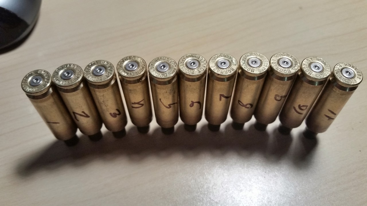

Funny thing just happened, found a virgin piece of 6 Creed from my first order over 2 yrs ago and it measured about the same as yours, .0015, decided to seat a bullet and measure the case loaded, I got .02715". Most of the cases I've checked before were in the .00137-.00142" range, yet the loaded case measures right around .272".

Just a small tid bit but a buddy who has a 6mm Creedmoor also did a FULL benchrest type prep of the brass (neck turn to all the same diameter, bushing sized, weighed, uniform flash hole and primer pockets etc and tested those against the out of the box stuff and the out of the box stuff worked just as good or better from his words. That aligned with my experience of virgin brass without any sizing or anything done providing better results. Sadly out of 1k peices +/-100 I have non of it with the exception of a few "master" peices are new anymore. I'm hoping I can play with the neck tension and get similar results which I'll be very happy with. I also trimmed a little more off the neck on accident but everything is more concentric now with the shorter necks. Don't know it that's dumb luck or what? Either way I know when mag fed it throws some of that out of alignment anyways.

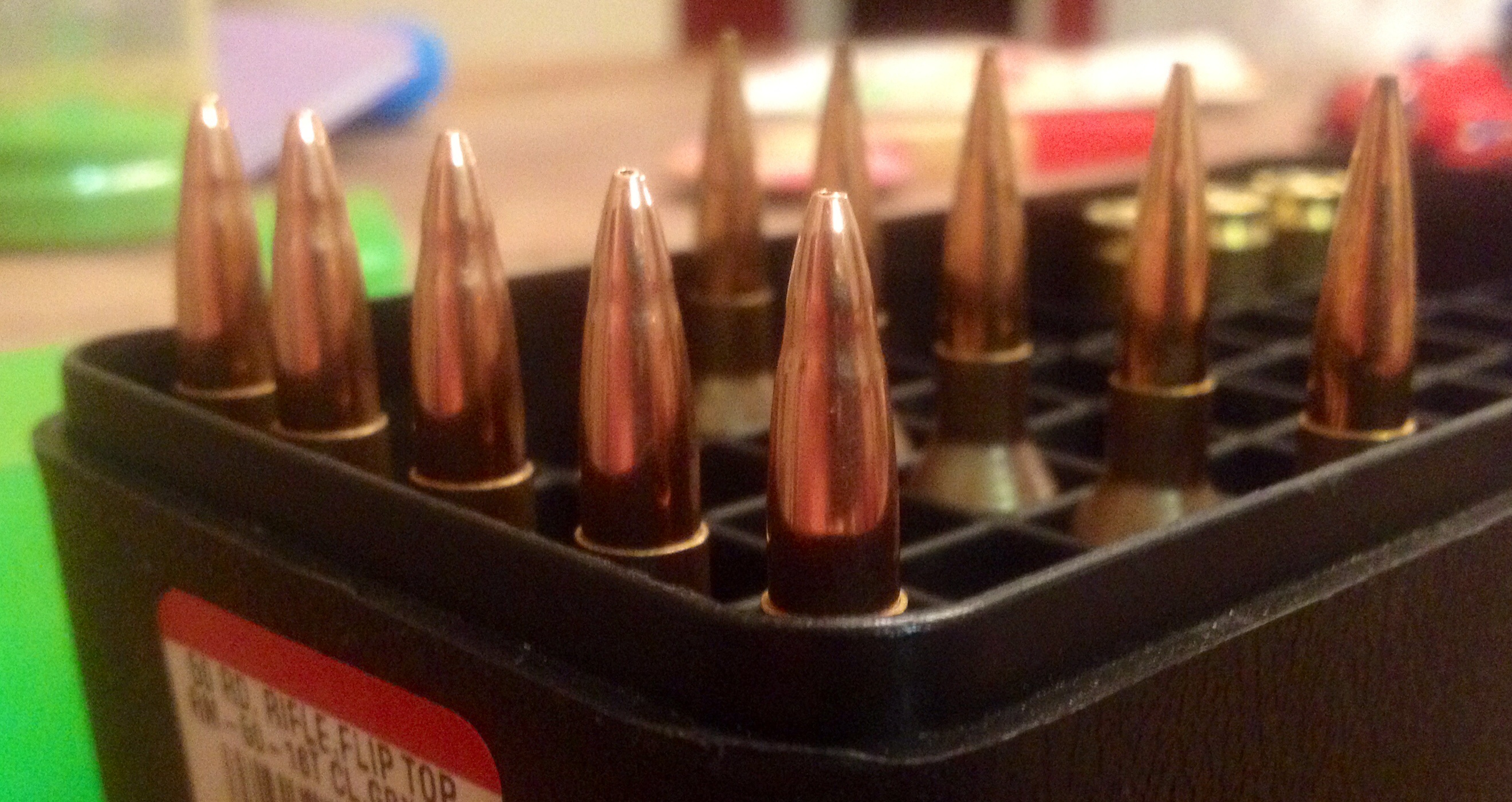

Funny all my loaded rounds measure .274 with the hybrids. The bullet measures .244
Brass is .15
Hornady 105s measure .2435
