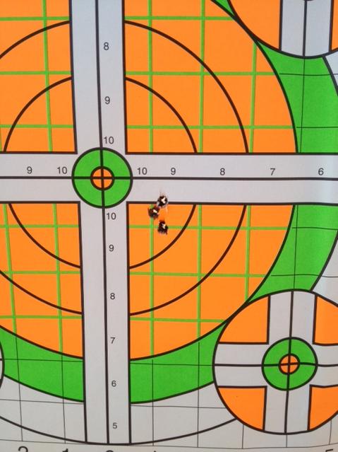

24" Benchmark barrel 7.7 twist on a AE action virgin Hornaday brass 115 moly Dtac
2.76" AOL, my AOL was all over the place 2.74-2.78
5 @ 40.0 2760 fps
5 @ 41.0 2840 fps
5 @ 41.3 2885 fps
I had no pressure at all
I'm going to load some at 42.0 and 42.5
Accuracy was ridiculous, all 5 shot groups and nothing over 1/2" it was sick
One rapid fire 10 group at just over 3/4"
the group at the 1 o'clock position was shot after sighting the rifle in the rounds on the lower left was the progression, the first 4 were in tight and I got excited and sent to flyer a little high. I followed up that with the target below
pretty happy with the first 40 rounds. I slung some at 500 with that were loaded w 40grns. 2.8 mills was my hold so easy it wasn't much fun :)

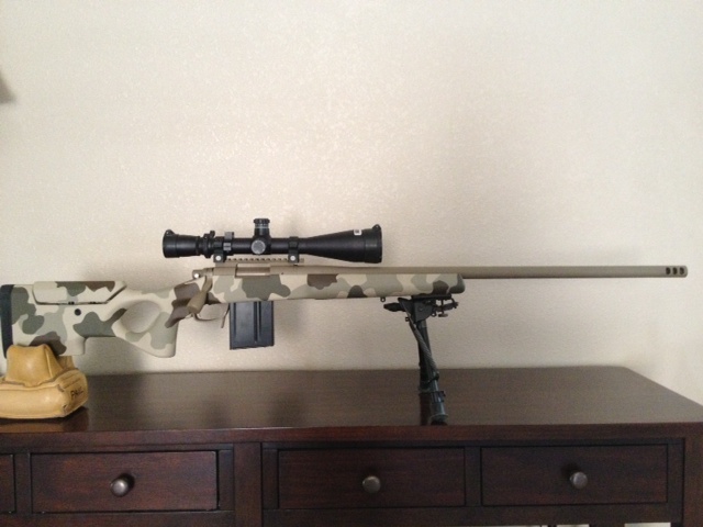

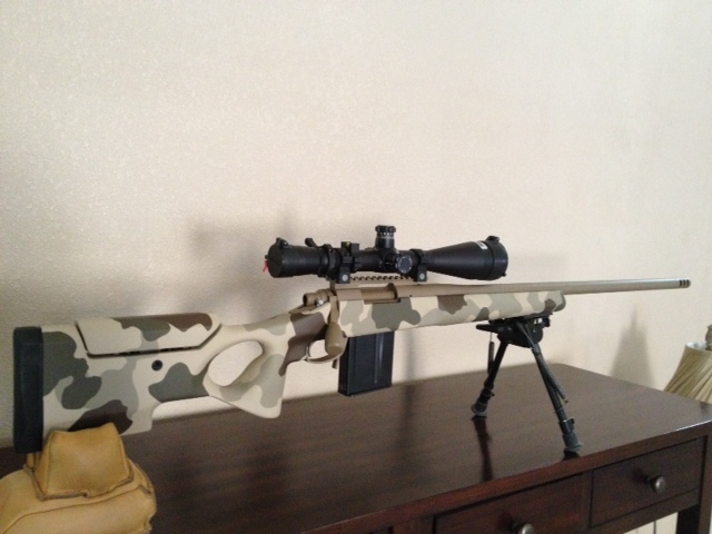

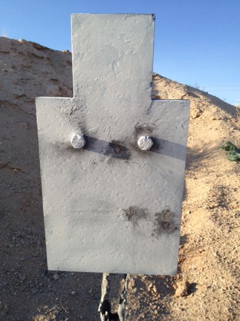

Well, I got my 6 Creedmoor yesterday and took her out same. I used 41.5 for my break in, which shoot fairly well, but this rifle seems to really like 42 grns of H-4350 @ 2.80 COAL. The 105 Berger Hybrid's avg is 3168 fps with the 26" Med Palma Bartlien Barrel, Badger BM, Badger MB, Manner's T-5 adj and Jewel trigger on the trued Rem 700. So far, I only have 48 rounds down the tube. The flyer on the 3rd target was my first shot of 6 and I pulled it, but the other 5 seemed to settle well.
The rifle was built by Moon of Crescent Customs who did an outstanding job!
Great shooting!! Cant wait wait for my 6cm

Capt Academy
Belligerents
Jul 27, 2010
771
7
22
57
ABQ, New Mexico
I'll load some up and try and get out Thursday. I'll go to 300 and then out to 760 yards, which is the max at the range I'll be at. Will take photo's and report how the rifle does at distance.

I'll try for that, but I don't think I can shoot that well at 300 yds! That's damn good shooting Gorski! I don't know what reamer Moon used, but I would say it may be the same.
I think the rifle is a shooter, had a .402 going then 1 flyer 1" to the left, grrrrrrr!!!!
That was with 41.9grs H4350, again, 300yds. The rifle does all the work, I just pull the trigger.

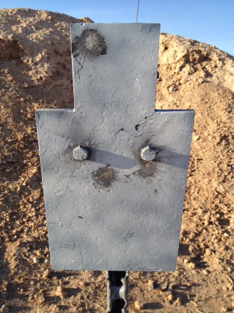

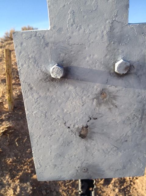

Well, I was able to get out early this am for some quick shooting. I didn't have much time or ammo loaded up, but I went away. Here are the results of todays shoot. Again, I was using 42 grains of H-4350 @ 2.80 COAL, 3168 fps. The first paper target @ 300 yds, I sent 3 shots. I could not shoot near as well as Gorski, but I tried. The next is a 3 shot group at 600 yds, did not adjust. Shot the next 2 shots at 656 yards, then 1 shot at 712 which hit the left side head of the silhouette target, I adjusted my elevation down and fired 2 more, my last 6 shots went into the silhouette target at 760 yards. Every shot hit the target, I just need to go and fine tune my dope. I was using shooter off my iphone for my shooting data. The silhouette target's are 14"H x 9" wide. The Sq plate is 12"x12" I did not adjust the elevation or windage after those 3 shots.
When I load up some more ammo and have several hours to spare, I'll go out and really fine tune the dope, but for now, I just want to see what the rifle would do.
