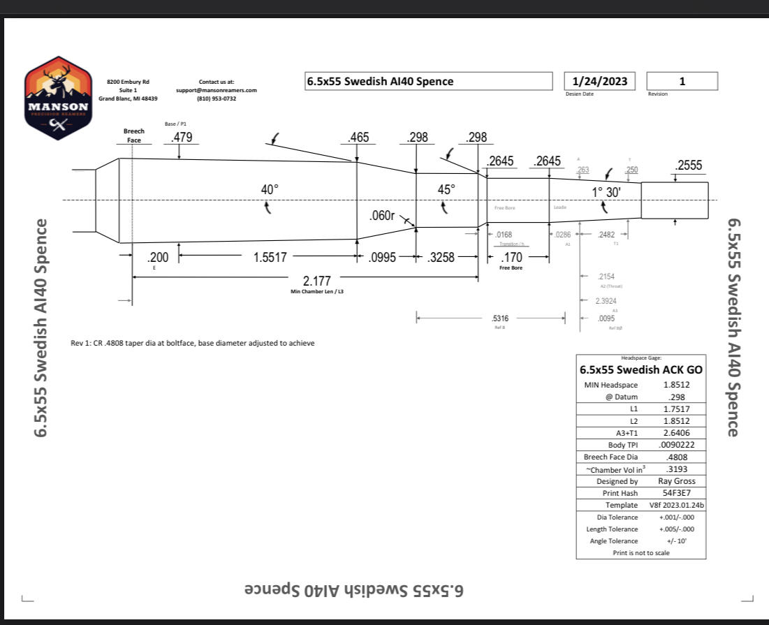

6.5x55 Ackley Improved
Berger 140g Hybrids
52.5g RL26
28" 8tw Bartlein M24/40
COAL 3.124

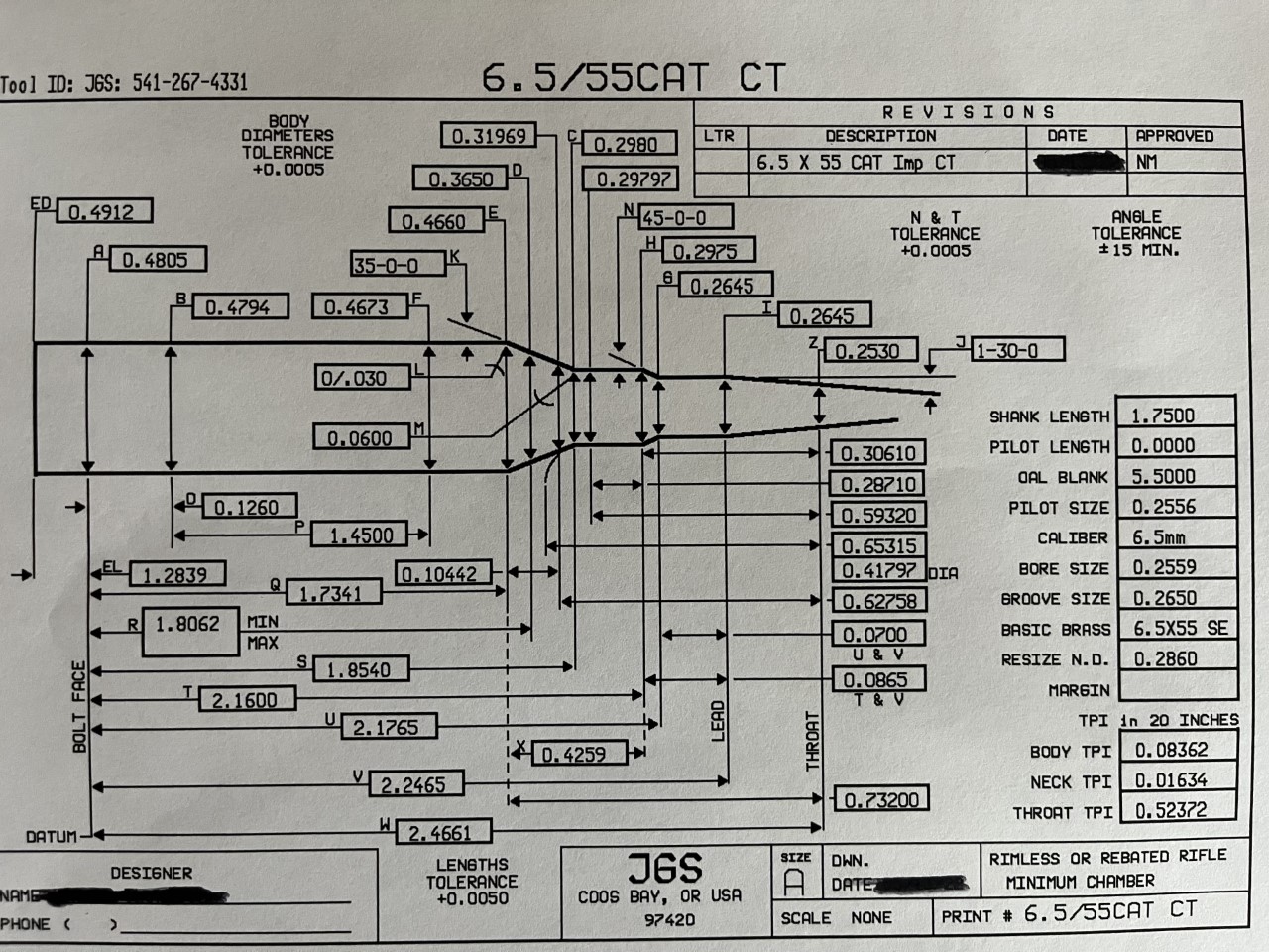

Hello everyone,
Krieger HVT 28"
minimum spec. chamber, classic throat
Tried the new 147gr ELD M bullets.
Lapua brass, 6X loaded
CCI BR primers
45.6 gr. IMR 4831
3.160" OAL
Average velocity 2860 fps
LabRadar chronograph
Max load

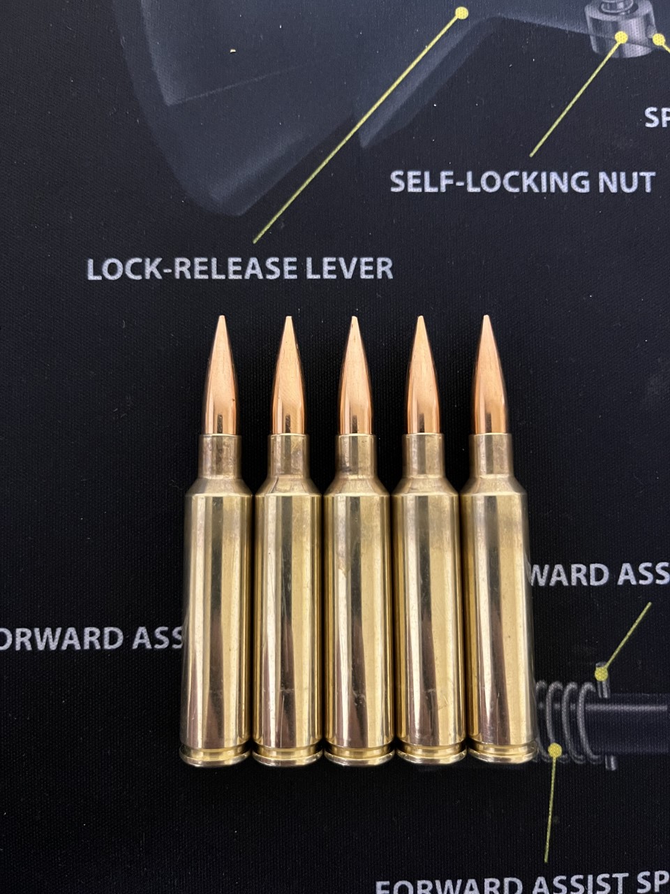

I just completed some load development for the Swedish Mauser and thought I'd share my results.
This load shot well in a '43 Husqvarna M96 long rifle (29' barrel) and in a '41 Husqvarna M38 short rifle (24' barrel).
Lapua Brass
CCI #200 Primer
Alliant RL-17, 42.1gr (warm load)
Hornady 140gr ELD

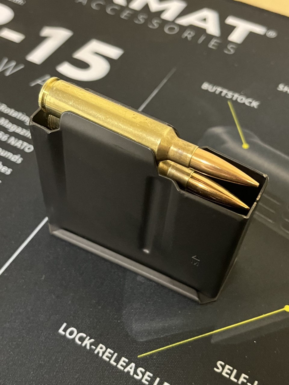

Seat to 2.600" base-to-datum with Hornady comparator (~10-15 thousandths off the lands in both rifles)
These rounds will fit in the magazine but you cannot load with stripper clips.

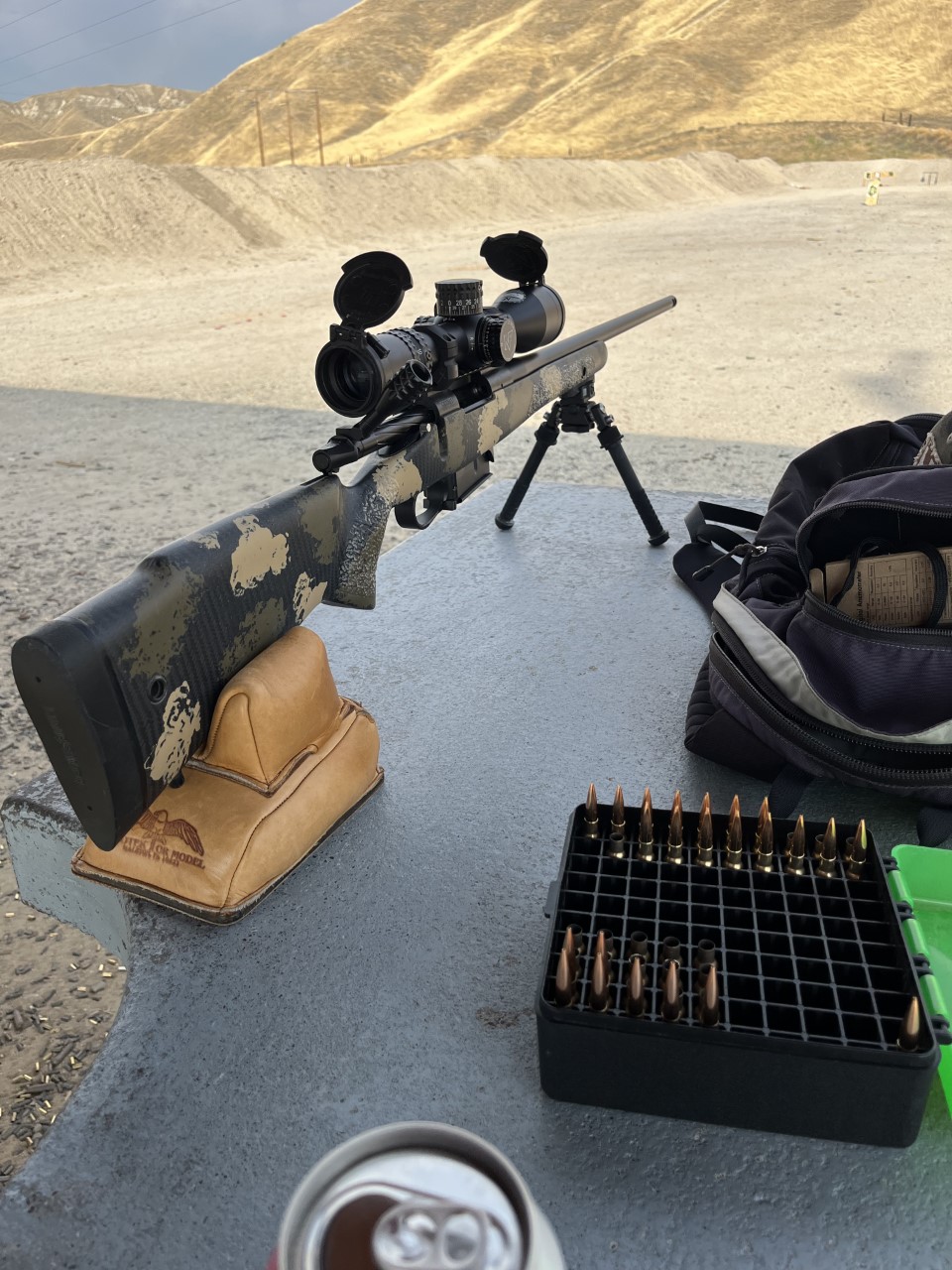

Kelbly Tactical Action
Brux 26" Sendero
Virgin Lapua Brass
Federal 210 GM primer
51.5gr H4831SC
140gr ELD-M
COAL: 3.150
CBTO: 2.550
Load is probably ~5% compressed. No issues with pressures or flattened primers.
2965 FPS at 80 degrees F, about 500 feet above sea level.
