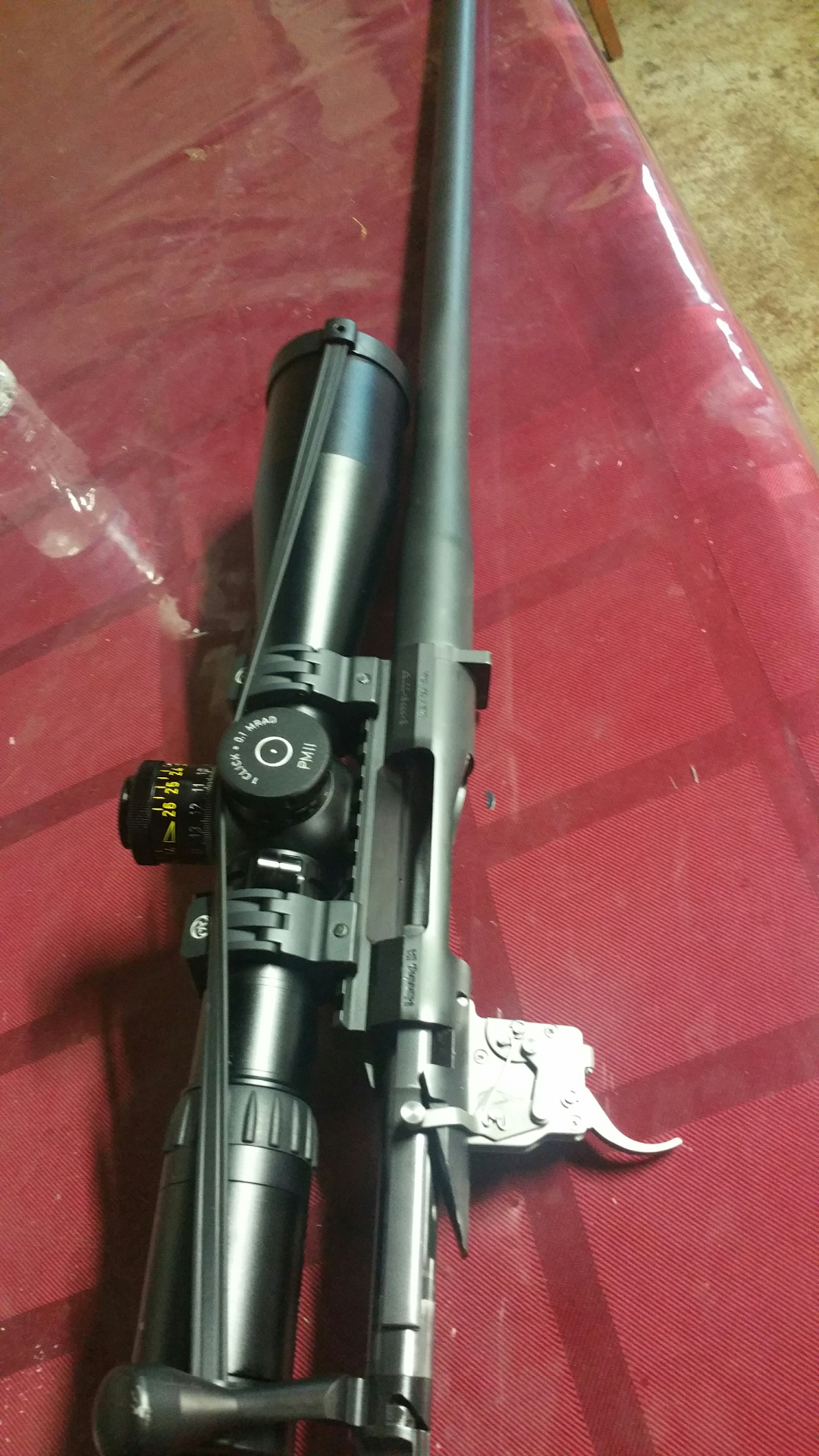

#20
I got a defiance deviant with control round feed 26" hawkhill marksman contour barreled action i might sell..it has jet blast brake.put together by GAP..
Heck yeah looks like a sweet ride! What chassis/stock are you going to run on it? And can you explain controlled round feed? I mean I kind of understand the concept of it but enlighten me please!

#21
Well i believe mousing actions popularized the control feed,the bolt has control on round while being chambered vs push feed... what i like about them i also use mousingfield and elite deviant...its much smoother being less tension from ejector while feeding.and dont need to lock bolt to eject a round like a standard remington bolt.. controlling the cartridge pre or after fired when ejecting is also nice..you can let cases ejects closer from you or away..vs plunger from standard rem...it also setimes avoid getting that fired casr mouth dented..im using JAE for this build

#22
Sounds like controlled round feed is the way to go! And that's going to be a sweet build when it's all finished! And makes sense on the ejection of a spent casing, I really dont want to lose any of ththaththat high dollar brass

I use the Forster dies with full length sizer and micrometer seater. I use CCI 450 primers, 36.9 grains of Varget, Berger 140 Hybrid Target bullet. 2755 fps out of a 24" barrel with suppressor. Measured with a Magnetospeed. 0.020" off lands worked best for my loads and barrel.

So H4350 or Varget seems to be the go to powders, how about bullets, I'm a hornady slut tried and true, I've got 500 140g BTHP match bullets, really wanting to try the 130g ELD-M out of my .260 rem as well as this new build, any one have a better bullet or is hornady pretty good for what I'm going to do with it?

The 123 Scenar gets overshadowed by the newer, higher BC bullets, particularly past 800 yards. But inside 800, it is a laser beam. My smallest groups have been with the 123 Scenar. That is the bullet I started with in the x47. It is extremely user friendly.
