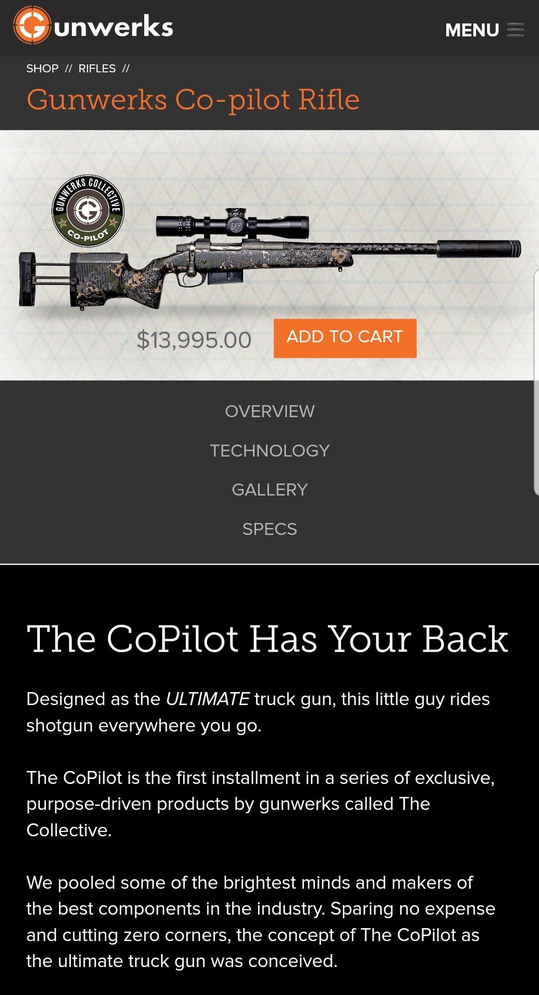

Looks like the "cool kids" over at Gunwerks think a 16.5" hunter is a viable idea.
Mine's at the smith, I'm soooo excited for it to be done! I think mine will be a fair bit lighter and about $7000-$8000 dollars cheaper.
A $14,000 truck gun. I would hate for that one to just walk off. I think i would rather keep the value of my truck gun slightly less lol.

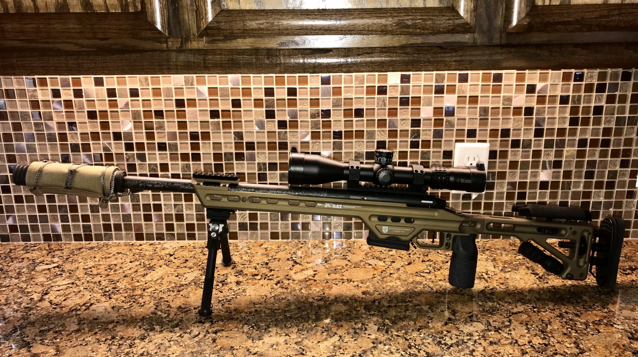

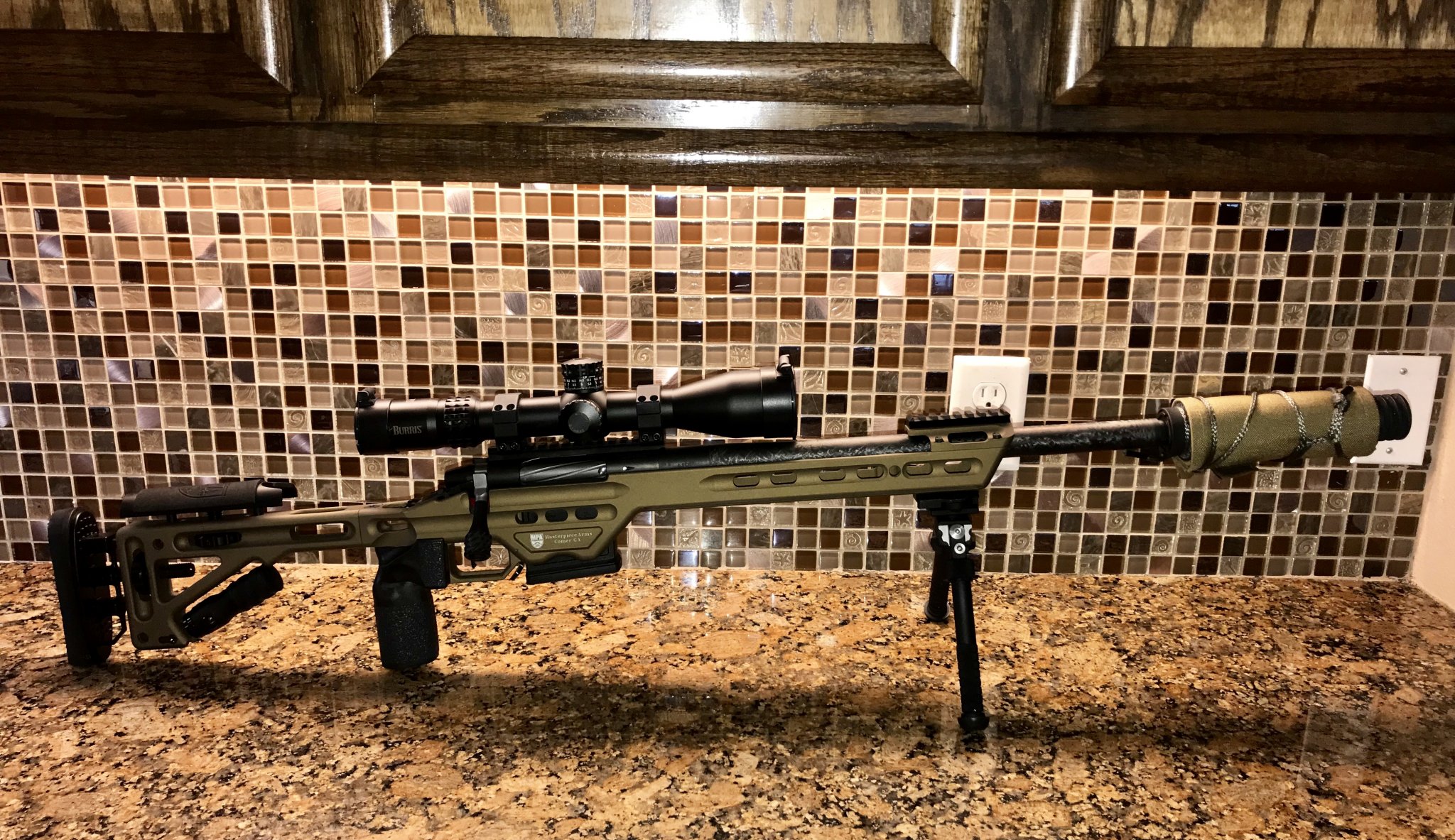

Here is the rifle I just had built for me, have yet to shoot it but looking forward to it as soon as I get some time.
Bighorn TL3
Proof barrel 18"
MPA chassis (not sure I like how this fits me yet)
Omega suppressor
Trigger Tech Diamond

How does your rifle balance Minus the suppressor? I have almost identical rifle right now and consider a shorty carbon 6.5 barrel for hunting
Sometimes I think my firearms spending has gotten out of hand. Then I look at stuff like this and feel better. I thought a truck gun was supposed to be worth less than the truck.

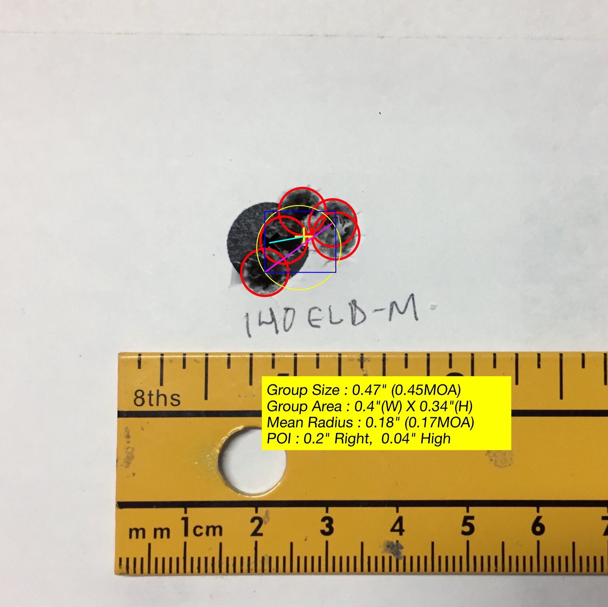

Cross posted from another short 6.5CM thread...
This is from a Ruger Predator w/ factory barrel cut to 16.75" with the Omega hanging off the end. It was around 80* that day. The load showing is factory Hornady Match w/ 140gr ELD-M. This is also a 5-shot string.
I don't regret cutting the Ruger at all. I only shoot it with a can attached, so the short barrel is a welcome addition (subtraction?).
When I had that Ruger cut down last year, I didn't realize I'd be on the cutting edge of such a trend.
