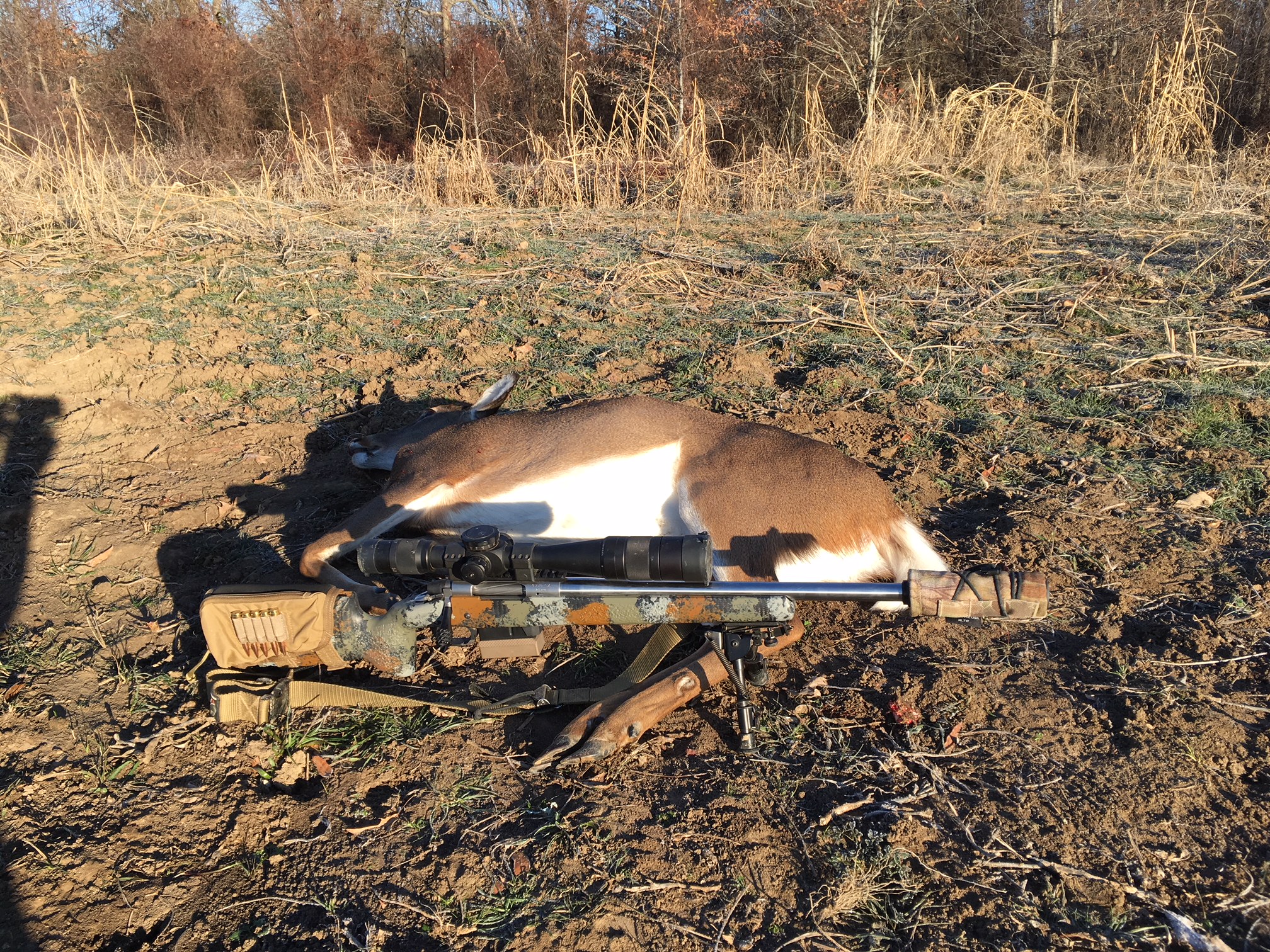

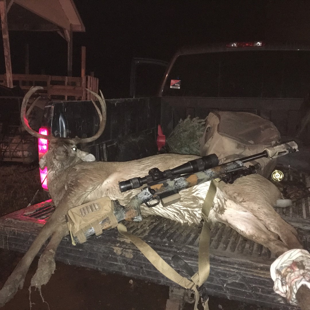

Here’s my 6.5 18” built from a trued factory rem 700 with proof stainless barrel. I shoot the 130s to keep my velocity up in the 2720fps range. 140s will be slow in a short barrel. Banging steel at 600 is cake with this set up. Like Frank above, you can take it out much farther than you think.

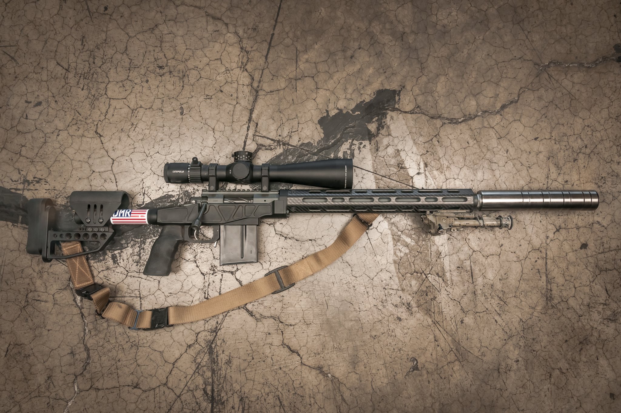

This is the inspiration for my build. Cannot wait till I can get the parts together
We have a rifle currently coming together for a client that is similar to what you’re looking to build. Trued R700, Bartlein 5R (16.5”) in a Manners T4A Elite Tactical with TT trigger and APA brake. I’ll try and remember to post photos when it’s done. We’ve been doing a fair amount of stuff under 20” with Proof CF wrapped barrels too (photo below).

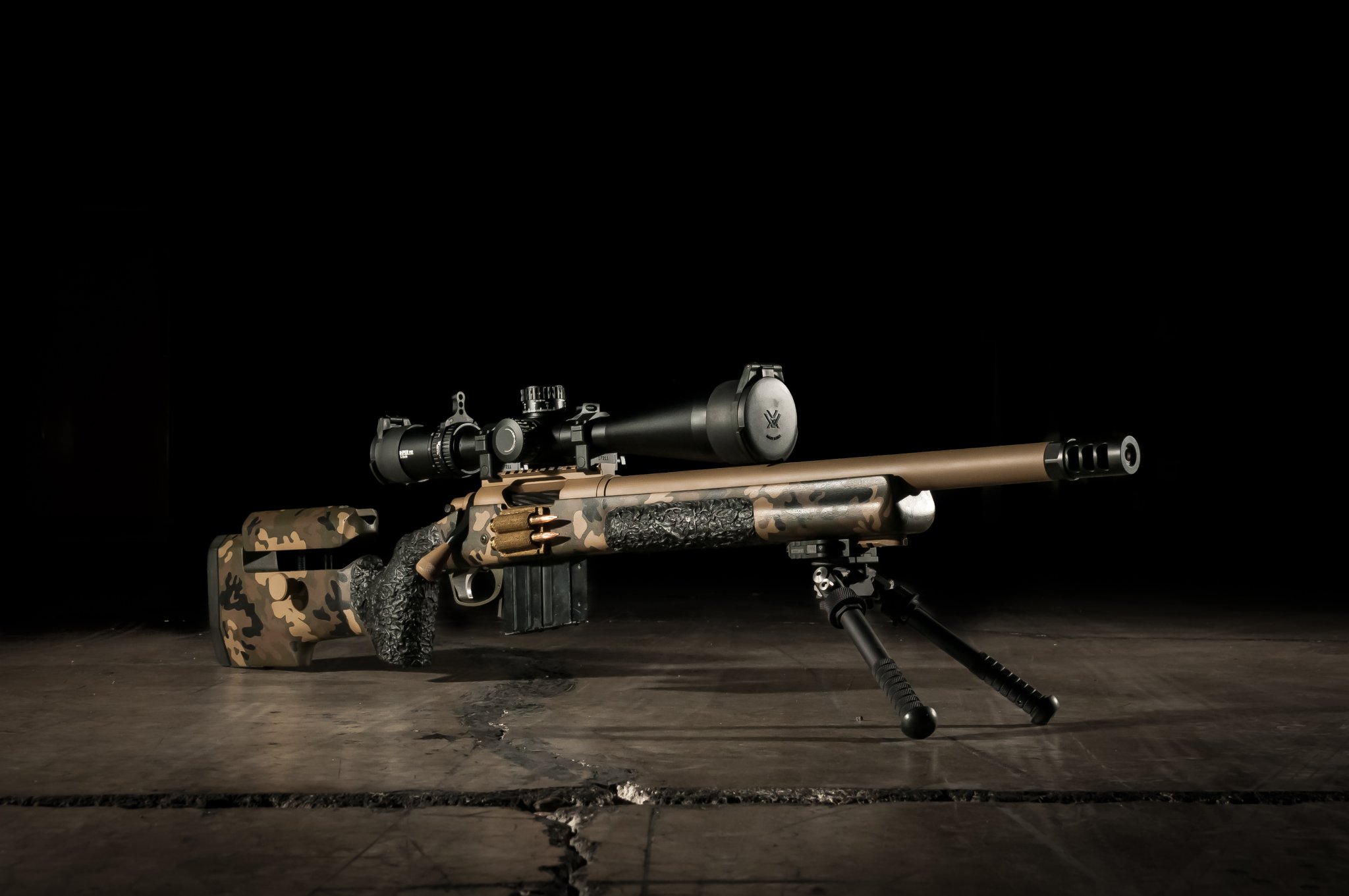

JFComfort, those are both great looking rigs, but what are the specs on the bottom one? May be one of the best looking rifles I've seen.

Thank you That’s a recent DMR 16.5” 6.5 CM build we did using a Stiller TAC-30 and Manners stock. The custom Cerakote and external texturing came together really well.
