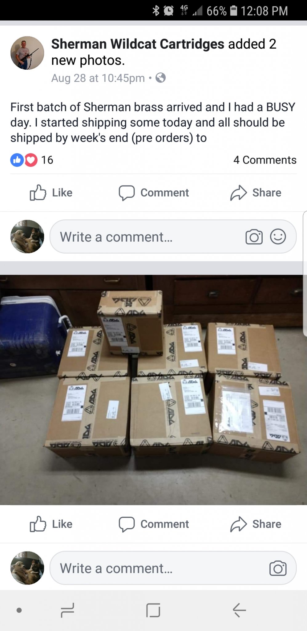

check out shermans 7SS

This ^^^
And sherman uses ALPHA brass which I think much better than ADG..norma brand brass dies really fast
did he switch from ADG? last i heard it was ADG
but either way, it's available.
similar OAL and fit in a short action WSM mag, but...the bullet is placed way better and you're gonna be a little faster velocity with less brass growth
Reactions: bjay
bjay
Belligerents
Oct 19, 2009
3,212
366
189
Aloha state HI
Yup its ADG last time spoke with him he was saying switching to Alpha I guess that didn't go through..i like alpha better than ADG when comparing them

I'm still waiting on my ADG myself. Is the quality not that good? Cause for $2.75 a pop i expected it to be decent.

This ^^^
....And also very high $$ at $130 for 50pcs..i guess that is all relative. i don't see the point,when there are so many other proven options .
